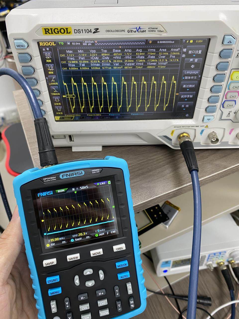

The photos show a disagreement in the voltage measurements.  A couple of them are by a factor of 10 so could be accounted for by the FNIRSI being mis-configured for 10x probes.
But the 50Mhz signal shows 20Vpp while the signal generator says it’s outputting 1.6V (unless I’m misunderstanding).  That can’t be accounted for by a mistaken 10x config?

The photos show a disagreement in the voltage measurements.  A couple of them are by a gator of 10 so could be accounted for by the FNIRSI being mis-configured for 10x probes.
But the 50Mhz signal shows 20Vpp while the digger says it’s outputting 1.6V (unless I’m misunderstanding).  That can’t be accounted for by a mistaken 10x config?
Is the FNIRSI already down 40% at 50Mhz?
Yes, i think it is set to x10 and should be x1, but I assume it is the same setting for all 3 images.
FNIRSI always shows 20.x VPP and RIGOL shows 2.2x VPP.
It does not show exactly the same as the RIGOL, but amplitude-wise there ist nothing special at 50MHz imo.
I don't know why the signal generator shows 1.6 VPP and how that is plugged together.
« Last Edit: May 22, 2023, 08:42:06 am by Aldo22 »

If signal generator shows 1.6V RMS that is 2.256 V P-P for sinewave. In which case Rigol is doing excellent job.
I believe the JDS6600 signal generator only shows Vpp (I don't have one so I'm not certain, but the reviews I have seen only ever talk about setting it to Vpp).
