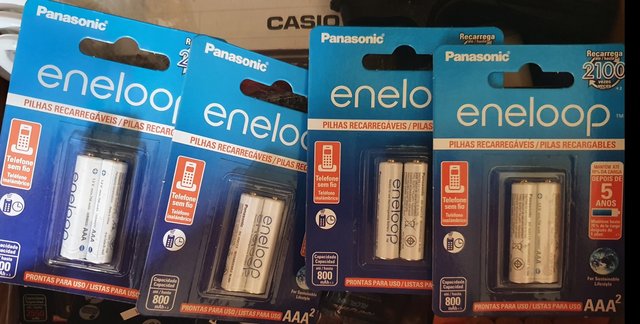

But does anyone have a solution to the AAA cell leakage problem?
NiMh can be used for AA cells.

Just discovered that Eneloop AAA cells do exist
They do! I've got a bunch. They rock.
