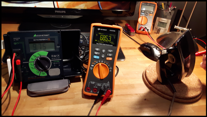

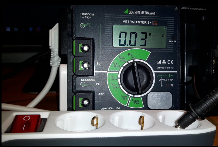

Protective Conductor Resistance with a cheap power strip:
Insulation Resistance showing 9.75 MOhm using up to 685.3 VDC with an old iron:

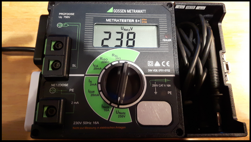

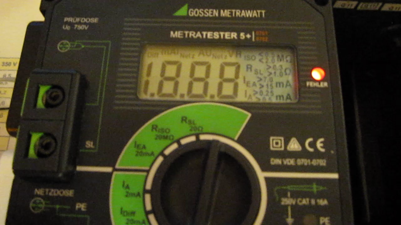

However, as I don't have any comparisons, I wonder if the starting info is normal:
1st the whole display and led light up, which seems to be alright:

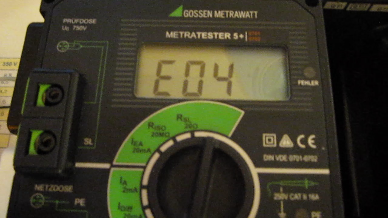

...but then there is an "E 04", which could be a FW version, a model version or an Error:

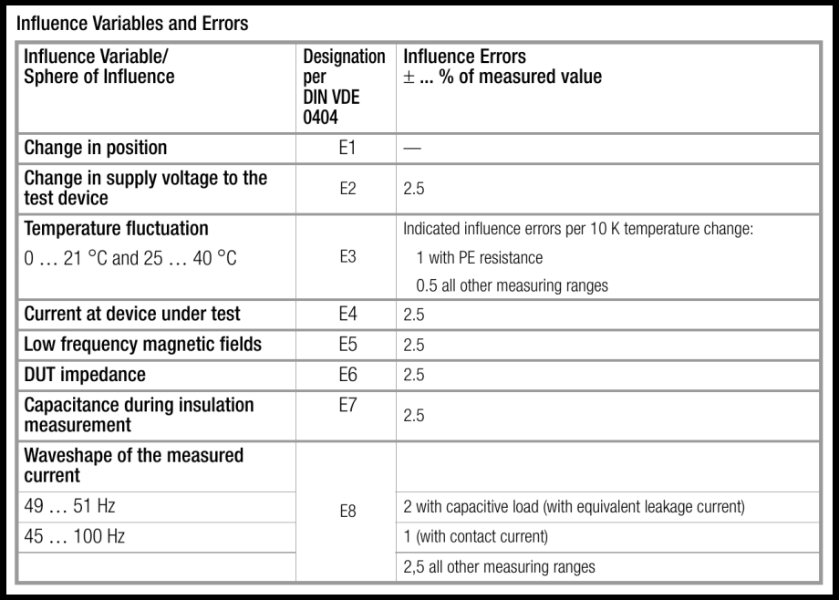

The manual does not say anything about "04" apart from the Sphere of Influence "Designation per DIN VDE 0404".
...and Errors should be an "E" plus one number from 1 to 8...
"Error 4 = Current at device under test" does not make any sense for me?!

I have a Metratester 5 without plus. Startup behaviour is the same: all digits on, "E04", reading. This is normal behaviour, without any issues.
And no, I don't think E004 has anything to do with parameter E4. This seems to be the software revision where "E" really is a bad chosen prefix for this.

Thank you very much for your answer, which solves my confusion about not having an error!  :-+

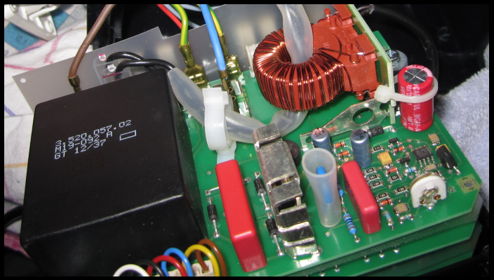

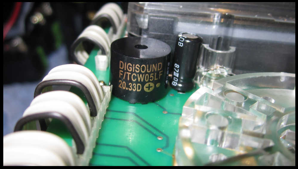

In case someone wants to pimp his/her Metratester, here are my experiences:
In the meantime I opened the Metratester once again and changed the signal transmitter, which is now free from any distortion, as the old one was from 2012, thus the "pheeeeeping" with 85dB was not acceptbale any more.
You can get them from Bürklin for a fair price:
https://www.buerklin.com/en/Signal-transmitter-5%C2%A0V-30%C2%A0mA-4%C2%A0V/p/36M455

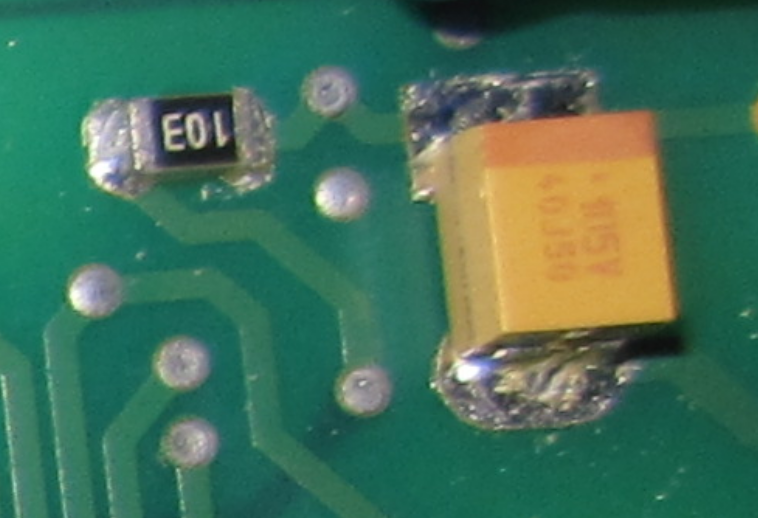

In addition to this I found the blueish Philips caps PH116 in the internet:
https://www.electromyne.de/public/catalog_xmlxslproducts.aspx?art=viewproduct&suid=11565&productid=1020190221&zid=2adcf8e0-5c3a-4749-86a1-f367d107aafe&ln=gb
...and changed them too:
I ordered 10 of them and found two with a quite good ESR, however, I was not sure about the Philips caps. They are probably quite old and the ESR is 1.30 Ohm, which is still a bit away from 1.60 Ohm for a 10uF 50V electrolytic cap, but I was too anxious to take another brand than the original one, although a lower ESR would have been better for my reassurance. Maybe I will change them in the future, but I couldn't find any data sheet for the Philips PH116 any more.
I also changed my former replaced red Würth cap with a Panasonic having a lower height - as you can see above...
This is especially important for the one behind the display, which must have a low profile by all means, otherwise you may damage the film/surface of the Metratester itself, as there is a gap in the plastic of the case.

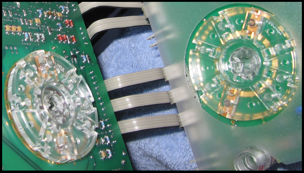

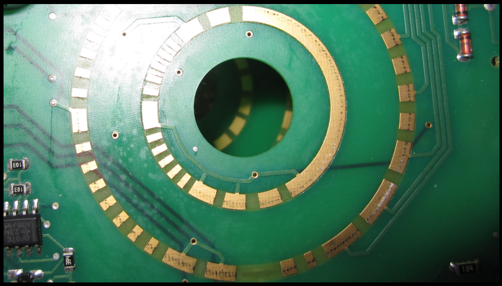

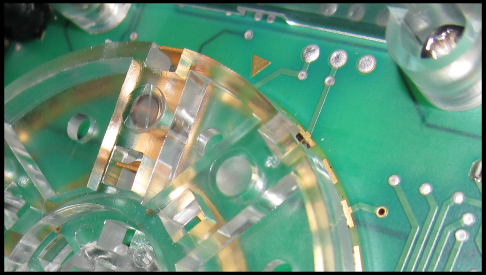

I also took apart the rotary switches: Two of them are connected with each other per mainboard, so that you have 4 halfes. I switched them with the bottom ones, thus the feeling is now like new! Two of them are connected via three barbs with each other and you have to be careful not to break them when taking apart, the bottom rotary switches have an o-ring.
The dark traces are in reality blank, which you can see more or less depending on the light:
If there is something I can do, to prevent any further damages, please let me know.
The arrow of the rotary switch must line up with the one of the circuit board, when you put anything together again:

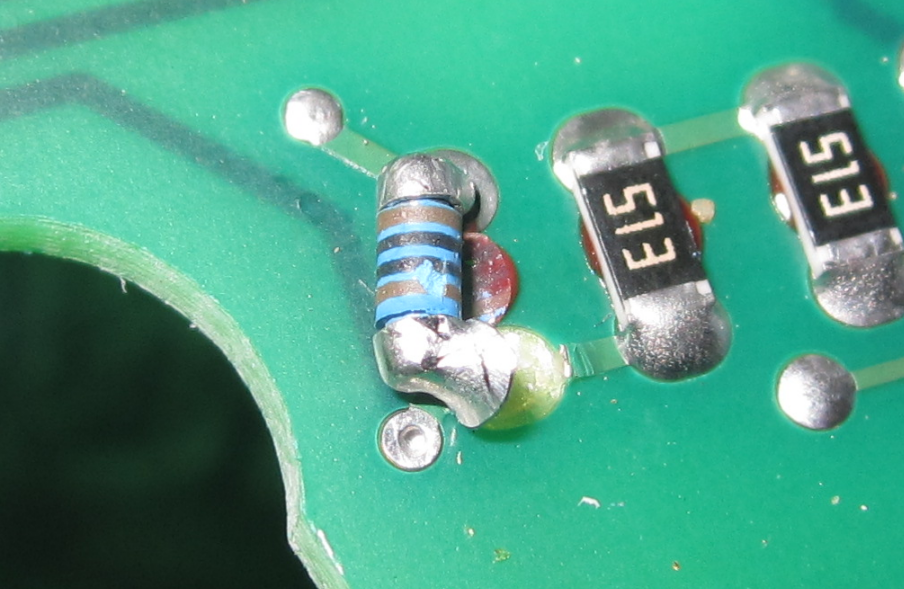

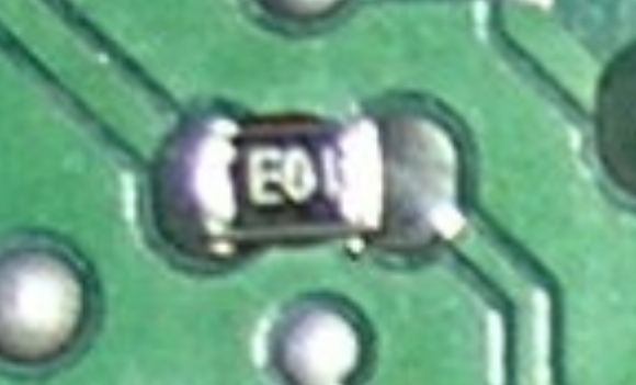

Finally I resoldered any suspicious looking soldered joint - more than the one I listed here:
