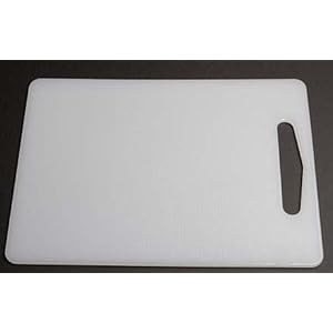

+1  :-+ , using a cheap white plastic chopping board as the material, and a saw, drill, file and sand paper, you could make few of these in one run.
