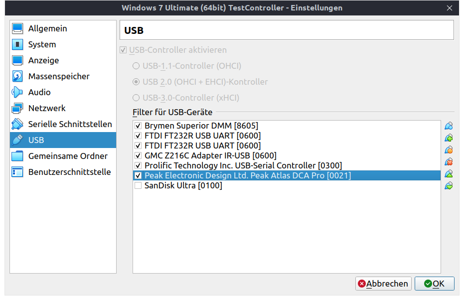

As a Linux-User Win7 (which you can get anywhere in any version and language  :popcorn:) as an offline Edition within VirtualBox is the best way to go - driver- and speedwise, so do I! I haven't checked Win10 or Win11 so far, because it does not make any sense to torture yourself!  :palm:
Being on Ubuntu Focal Fossa 20.04.X using newest Oracle VM VrtualBox 6.1.36 r152435 and having no problem at all to use "Atlas Peak DCA 75 Pro"-Software within my several offline Win7-VirtualBoxes - in this case my "TestController-Edition"...
I also use wine, but not for this type of software, as you too often get problems after upgrading (at the moment 7.16 winehq staging makes problems, so that I had to switch back to winehq stable 7.0) to use my beloved WinRAR 6.11 or FlashFXP...) - but back to your question:
Of course you have to check the USB within the settings, to use it...which you can see here and sometimes it makes sense to only use USB 2.0:
"Peak Electronic Design Ltd. Peak Atlas DCA Pro [0021]" is detected!

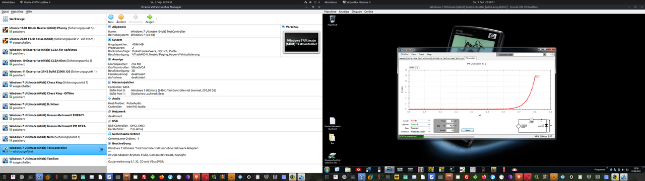

I switched off the fullscreen mode, so that you see, that I am within Linux using two displays:
Within the DCA-Software, you can see in the bottom left corner in green, that the device is connected "DCA Pro connected"!
Here a graph with no problem:
Cheers!  :)
