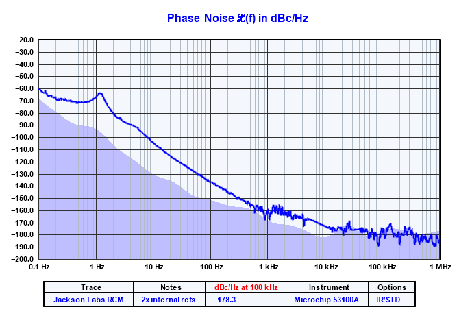

« Reply #37 on: February 28, 2024, 02:38:01 am »
Nice rock!  That's about the right noise floor for the 53100A, but I wonder where that artifact came from.  Normally you see that sort of thing if the DUT or one of the references is still warming up.  More typically you'd see something like this when measuring something below the unit's own spec floor:
(noise/spur responses near 1 Hz and 2 kHz are real)

« Reply #39 on: March 04, 2024, 02:25:54 am »
The spurs shown at 4:30 do not originate in the PN test set, but are typical of the various CSAC models.  They aren't especially-well optimized for spectral purity, nor were they meant to be.  The major design goals for those parts are long-term stability and low power consumption.
E.g. if you do a Google image search for csac phase noise, you'll see a few references like this one that depict similar spurs with different instrumentation.  Unexpected spurious responses on the 53100A are often remedied by letting the measurement run a bit longer, but that's not an issue with the test shown in the video.
(Obligatory disclaimer: I work on the 53100A and related stuff, but I don't speak for Microchip.)
Edit: this was in response to a post that seems to have been deleted, which mentioned the spurious responses visible on a chip-scale atomic clock measurement in a 53100A demo video.
Cool video, I hadn't seen it before. :)

    There is also a comparison among them >:D.
    https://kvg-gmbh.de/en/product/ocxo-beispiel/
    the noise floor of 53100A is higher, can not compare with others, but I checked several test results of the PN2060 for OCXO testing, for the far end test result, the actual tolerance about 10dB, so, just for your reference, can not as a trustable test result.
    according my latest testing (08/07/2024) for Datum 2750013-1, if low than -150dBc/Hz, test result is quite diff.
    « Last Edit: August 09, 2024, 03:15:46 pm by testpoint1 »
