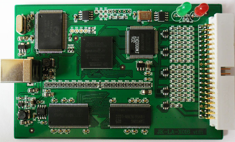

This is inside LA5016 Jiankun one

Thanks for sending this. Interesting how it says JK-LA-X016 but it is only applicable to the LA5016 and LA5032 (the LA2016 and LA1016 are clearly different as they use a smaller connector). Also interesting to see the sea of NC pins on the LA5016 - GNDs could make life easier for higher speeds.
For comparison, a LA2016 photo at Sigrok.

My LA5016 is labelled Kingst and it has a slightly different layout with BGA ram and less components.  I've added a pic for all to see.
I've ordered a USB 1.1 hub to prove the memory really works and a 100MHz xtal osc and a couple of TC74VHC393FN dual 4 stage ripple counters, so will wire it up to produce 16 different signals (100Mhz, 50MHz, 25.....) and try all 16 channels with the USB 1.1 port at once.
Good point about the unused connections should be grounds.  I removed the top lid from my device and the PCB resides in a slot.  It really is stuck in tight and I can't get it out lol.

Seems that they optimized out the Max II CPLD in the newer (?) version. But also no visible signs of (automatic) length matching for the DDR2 RAM any more.

Hi guess is 2 different things, 2 different companies, not the same, the price is also not the same

Well I'm still waiting for parts for the frequency divider.  The post is really slow here, I guess the donkey's ill again.
I woke early today and got to wondering what the accuracy of the LA5016 is and started looking at the PCB again.  There's only 1 crystal on board and that's the 24MHz for the Cypress USB chip.  I'm guessing the FPGA gets its clocks from the Cypress chip.  According page 26 of the the data sheet, the xtal pins of the 100 pin device are pins 10 and 11 (XTALIN and XTALOUT) but it is legal to drive XTALIN from an external 3.3v 24MHz clock.  The data sheet is here:
https://www.cypress.com/file/138911/download
The xtal on board has no markings, apart from 24.00 on the top so I'm guessing it's a cheapy one.  If required, it should be possible to fit a 24Mhz tcxo to improve the accuracy.  When I get a minute, I'll test the LA5016 as-is on my 10Mhz gpsdo.

It is my understanding that the 24MHz crystal is for the USB section of the Cypress chip.  Can it generate the high clock required by the FPGA for sample rates of 100-200MHz?

Yes it is, but there's a 20x PLL internally giving 480Mbps although I don't have any real idea atm.  I can't see another xtal on the board and the FPGA will need to be clocked.  I'll take a closer look....

What about U14?

What's U14?  I'm outside my comfort zone here :-)

Oh yes, the chip  :palm:
I can't quite see the markings on my photo so I'll pop the case off and report back once I've drank more coffee :-)
