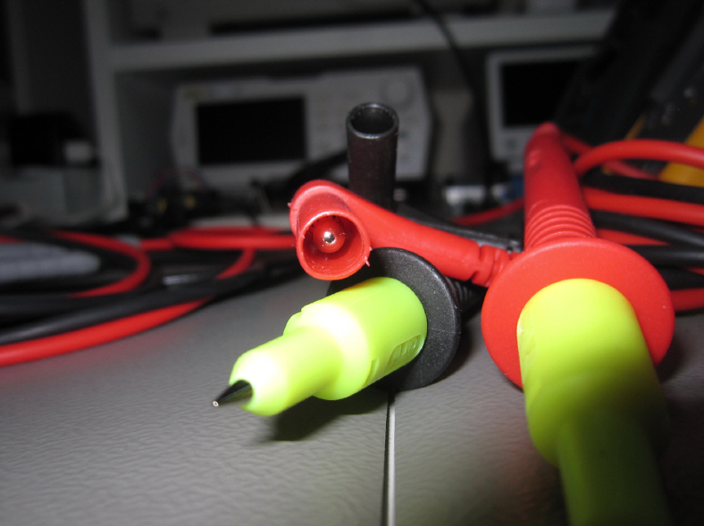

I have received my test leads from Probe Master that comes with Right Angle Safety Standard Size Banana Plug. I was going to use them with Fluke 87V. I was disappointed to find out that they are not compatible with my DMM even though Probe Master cross reference table says the opposite. When a reasonable force is applied, banana plugs can be inserted only as far as it can be seen in the first photo (right to left: original Fluke, Probe Master and low brand test leads). I have double-checked Probe Master test leads with another DMM and got similar results.
It seems that safety shrouds of original Fluke and Probe Master test leads are the same. Length, thickness and diameter does match. The only difference that I can see is banana plug itself. The second photo shows that.
I am a bit disappointed that Dave did not test Probe Master test leads he received in one of his Mailbag section videos. That could save me a lot of time and money (I have ordered the most expensive Kit, which was delivered from USA to Europe).
Overall, I like the quality of Probe Master test leads. Too bad they do not work well with my DMM.

If the contact feels solid and the probes don't fall off, is there a particular reason other than aesthetics to why the shroud should be completely inserted? Honest curiosity, as Pomona cables show the same behaviour in my Brymen BM857...
In my opinion this is not a write off on the probes, especially if you are working on low-voltage electronics.

I found the same thing with the Probe Master leads and my Fluke 187. The leads work fine with my Brymen meters. It is a little aggravating, but otherwise the probes are very nice.

Aesthetics is not important when you pay $2 for test leads, but when I pay 25 times that (+ expensive shipping) I expect it to be bang-on.
At the moment those test leads do work. I a not sure if the contact will remain as good as it is now, but let's hope so. On the other hand, I wouldn't risk using these test leads for higher voltage or current measurements.

Apparently, if you want to use these test leads with Fluke 87V, you need to select Standard Size Banana Plugs.

I just had a similar problem with some good quality German made test leads.
They just did not go in to a Fluke 179
It turned out that the plastic insulation safety tip of the banana plug was slightly too large.
Since I needed the test leads, I just removed the plastic tip from the 4 mm banana plug buy
pulling it out and then the connection worked.

I also have these identical Probe Masters that I purchased recently, and they fit in all my Fluke/Brymen/HP etc. DMMs.  I don't have the Fluke 117 however.
I specifically tested the 87V per the original post and do find that there is a slight catch under certain conditions that makes it feel like they don't want to go in, especially with the current jack.  But if you wiggle them a little, they will continue to go in all the way.  Perhaps this is the issue with the 117?

Firstly, the Probe Master website lists models 8017S and 8043S as being compatible with a Fluke 87, and it looks like you chose one of those.  There's no issue of you going against any recommendations.
I also have a set of Probe Master leads with these connectors at the meter end, and this made me have a look at them.  I've got both Fluke 115 and 27 multimeters, and use both Probe Master and Pomona leads with them.  I found that for both meters some of the shroud is still visible when they're fully engaged, but the fit is secure.
I took some measurements, and here's what I saw for a Fluke 115:
Probe modelShroud exposed, start of resistanceShroud exposed, fully engaged
Probe Master 815212mm6mm
Pomona 5519A11mm3mm
For a Fluke 27:
Probe Master 81529mm3mm
Pomona 5519A7mm2mm
What are the measurements for the 87V?  If you're seeing 5 to 7mm of further insertion after first resistance you're probably okay.
There's isn't much shroud length left over when these leads are fully engaged in the Fluke 27, and it's likely there are other meters where nothing is left at all.  In both the 117 and the 27 the metal part of the socket is recessed quite far in from the front face of the meter, but it seems like they're not nearly as recessed in the 87.  Looking at how little shroud is visible for the other leads you've pictured, I wonder if they'd even work for a Fluke 27.
What I think is happening here is that the safety 4mm sockets on multimeters aren't as standard as you'd really expect.  Probe Master, Pomona and other manufacturers of test leads are trying to provide a connector that is as compatible with as many meters as possible, so they use a long shroud length.

Thank you, the 8017s are also listed as compatible with the 117. The contact being good isn't the only important thing, i think also how far they protrude from the meter is important for mechanical reasons, the further out they go, the more leverage they have against the socket and can be more easily damaged if it falls and the lead connector is hit from the side. But it seems that's indeed how they were designed, very long! so nothing to do about it!  :scared:
Mine also protrude about 6mm from the fluke socket when fully pressed in. I measured with a toothpick and marked with a pen, and the depth of the socket is just about 6mm shorter than how far i can push it into the test lead connector to the tip of the banana. Wonder why they make those bananas so long, and why the unshrouded ones do go in all the way, makes me think they are not using the exact same banana or something.

I think this is a Fluke-Only problem, concerning this type of Probe Master test lead and any other brand I own. No matter which Fluke I take: 117, 289, 1507 any brand of test lead has the same problem, that the test leads rise about in a way too much. However, I have never paid attention to it before.
But compared to Keysight or Gossen Metrawatt, the same Probe Master test leads both slide in till the end and have a very good connection - Gossen Metrawatt is even superior to any other DMM I own.
Allthough the test leads, which came with the Gossen Metrawatt itself are of very poor quality with respect to resistance value (the 117 has no zero function), they seem and feel to fit best into my 117, which is the reason, why I use them for this purpose to poke into power outlets with childproof lock.
All my test leads have the same outer dimensions and even the Gossen Metrawatt test leads have a big safe spacing.
