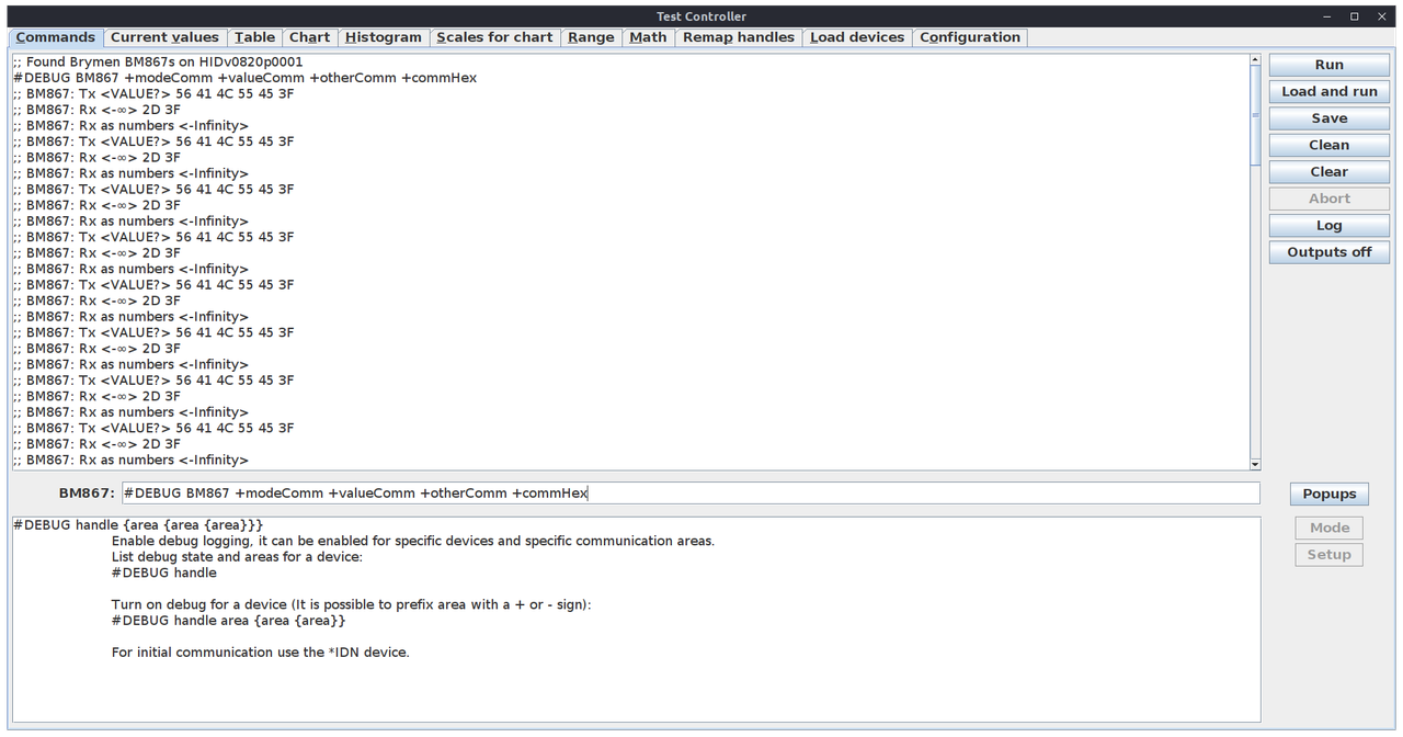

I have played a bit with my Brymen vs. Linux and this is what I have got so far:
TestController does find it, but it does not appear under "Current values"...
;; Found Brymen BM867s on HIDv0820p0001
#DEBUG BM867 +modeComm +valueComm +otherComm +commHex
;; BM867: Tx <VALUE?> 56 41 4C 55 45 3F
;; BM867: Rx <-∞> 2D 3F
;; BM867: Rx as numbers <-Infinity>
Cheers!

« Reply #2105 on: November 24, 2021, 11:24:39 am »
I only support HID interfaces on windows at the current time.
Offline HKJTopic starter

« Reply #2107 on: November 24, 2021, 12:32:22 pm »
Yes, I know.
However, over a year ago I couldn't manage that a Brymen with its USBHID was detected by TestController using Linux:
https://www.eevblog.com/forum/testgear/program-that-can-log-from-many-multimeters/msg3019724/#msg3019724
..., but now it works. Therefore I thought you "only" need to implement the missing "definitions" and it could be a step forward, trying to use a cheap Brymen with an even cheaper Pi with Linux?
As Brymen works with SmuView under Linux, there is probably only a "piece" missing?
It is only a question, as I am not able to judge the required deal of work!  ;)
Cheers and thanx for version 1.97!  :-+
  • Posts: 3885
    • Tests
« Reply #2108 on: November 24, 2021, 12:41:22 pm »
Yes, I know.
A long time ago I implemented different solutions for Windows and Linux, but the HID library did not work on my RasberryPi (With std. OS), that is the only stand-alone Linux computer I have at the moment, i.e. I could not test and debug it.
It may be a simple fix, but I am not expecting to look at it before I have a way to test/debug, I also need a new look on the Windows part.
