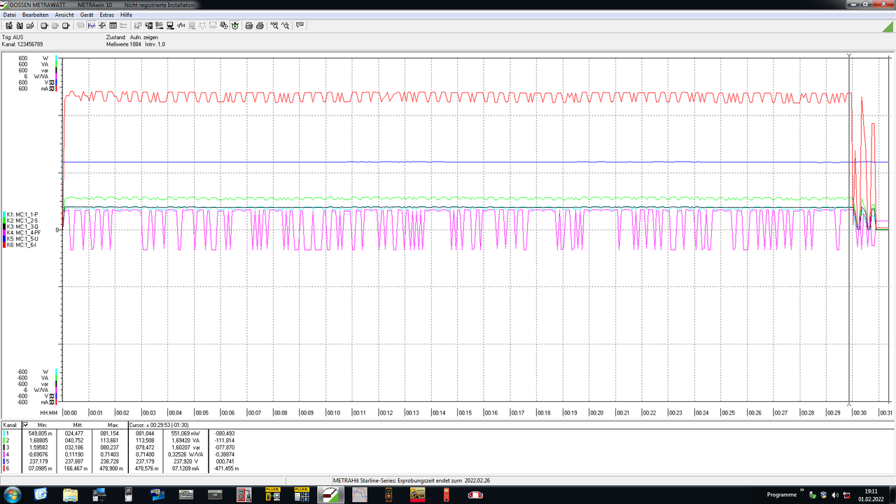

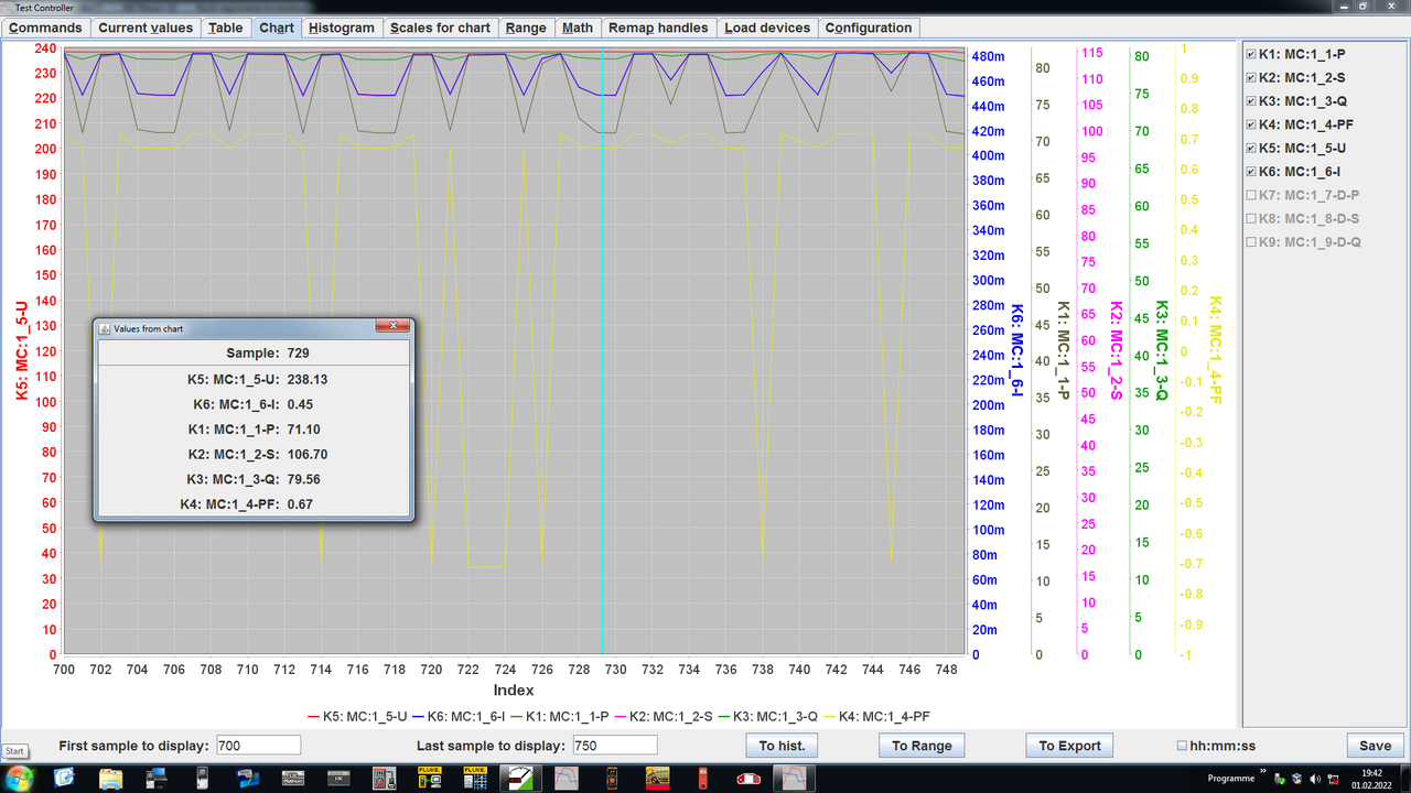

Offline PushUp
  • Posts: 189
« Reply #2265 on: February 01, 2022, 10:01:14 am »
@ HKJ:
Do you also have interruptions while logging with the Metrahit Energy?
No matter how many data or period of time I choose I always have breakdowns, which are obviously not there in reality, as other meters like Brymen, Keysight or Fluke work just fine at the same usb port / setup...
...and also METRAwin10 does not show these unforeseen interruptions?
I would prefer using TestController, but I can live with METRAwin10, so that I don't have any expectancy, just asking as I have no other Metrahit DMM to compare, as it is probably more like this Brymen USBHID-thingy, because the Gossen USB-IR-Interface also does not run under linux itself in contrast to Keysight or Fluke, which are the best brands for linux users...
I have tested different setups with Win7, Win10, Linux with VirtualBox so far and always have this problem with TestController. As there is a "serial fixed baudrate" there is also no difference whether I keep the 9600 or change it to 38400 in the "settingsLoad.ini".
Does anyone else have similar issues?

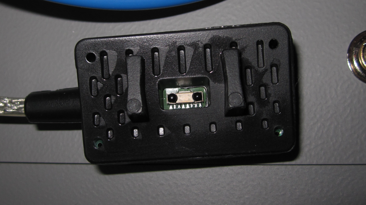

By the way:
Does your USB-IR-Interface look like this with this wide "opening":
...or like the one with two small wholes for the diodes:
Have they changed the design?
ThanX & Cheers!

« Reply #2266 on: February 01, 2022, 10:27:45 am »
I do not see any:
You can try reducing the sample rate and/or look at what else is running on the computer (The sample thread uses a fairly high priority and will usually not be affected by other programs).
By the way:
No, it has holes in the plastic for the leds like your second picture, but then my interface is more than 10 years old.
The following users thanked this post: PushUp

« Reply #2267 on: February 01, 2022, 07:07:22 pm »
As always: Thank you very much for your quick and helpful reply, HKJ!  :-+
Mmmh, very strange, I think I have to invest a bit further, but at the moment I have no idea, why there are no interruptions in METRAwin10:
However, the good thing is, that I am able to export the data as a *.txt file from METRAwin10 to your genious TestController, as you have thought of anything...  ;)
..., so that I have the best readability and a clear layout, to analyze the data, which is definitely missing in the ancient METRAwin10...
ThanX & best wishes!  :)
