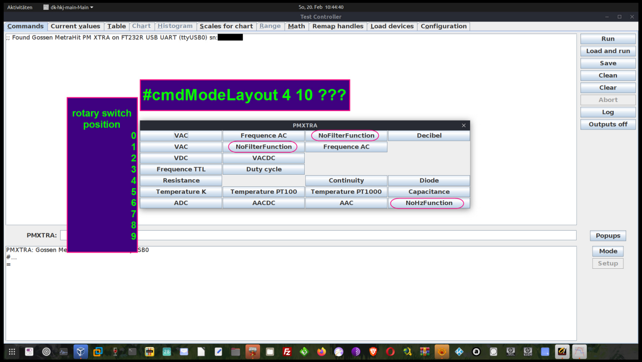

Offline PushUp
  • Posts: 189
« Reply #2305 on: February 18, 2022, 05:14:50 am »

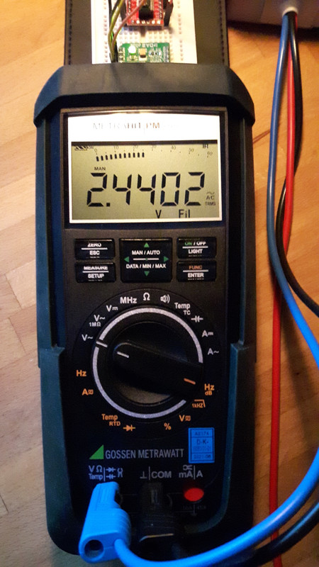

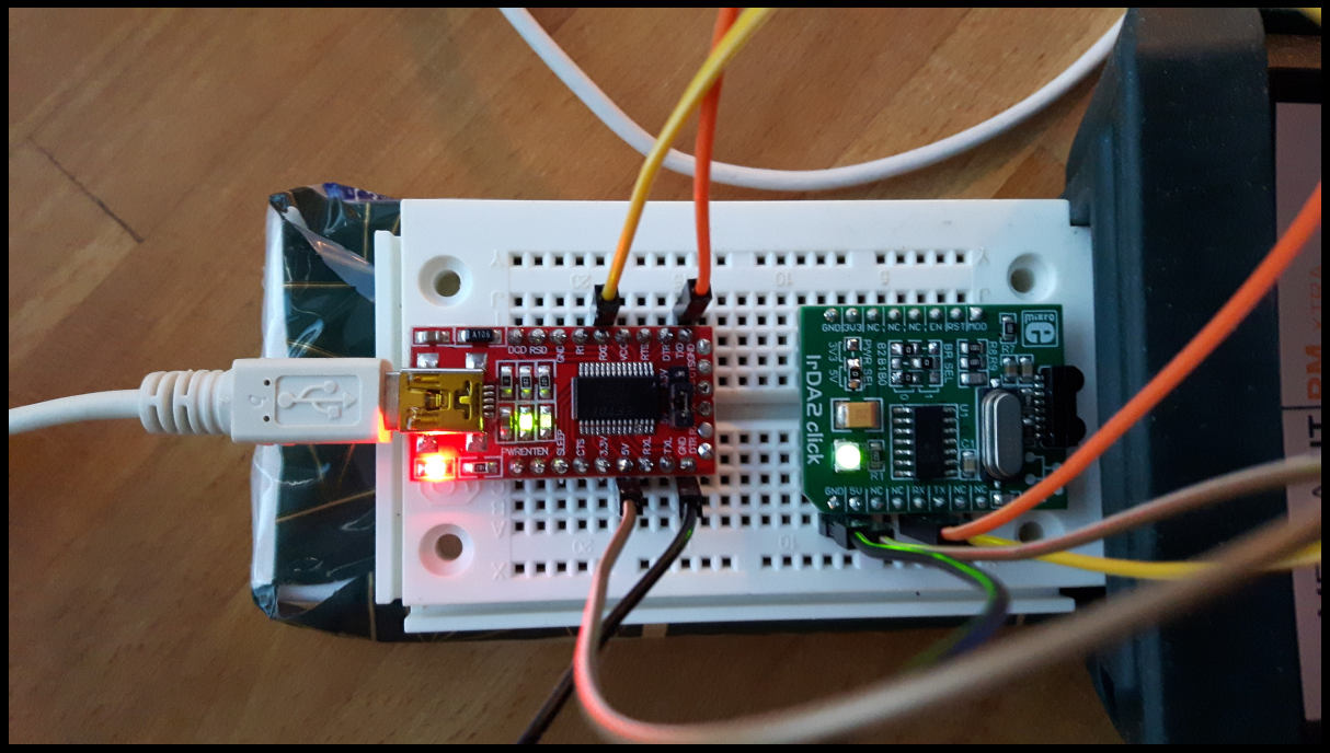

As I couldn't justify myself paying 300 Euro for the original USB-IR-Interface by Gossen Metrawatt "Z216C USB X-TRA", when you are able to build up three units for the price of 1/3, I have a question concerning the Metrahit PM XTRA.
The USB-IR-thingie is probably old and anyone knows it, but just to sum it up for later use:
You only need the "FTDI Adapter FT232RL USB to TTL Serial":
https://www.ebay.de/itm/223727784474?hash=item341737121a:g:m2MAAOSw7old366r
...and the "IrDA2 click IR by MikroElektronika".
https://eu.mouser.com/ProductDetail/Mikroe/MIKROE-1195?qs=5gSubTaN56myuTgGIeORag%3D%3D
These are just my links, where I bought them, feel free to buy from anywhere for any pricing!
As far as the "IrDA2 click" is concerned you only have to modify the Baud rate and power selection. Using a second solder iron is most likely the easiest way to move the components, when you don't have expensive desoldering tweezers:
The FTDI-Driver is already implemented in the lnux kernel and Windows probably needs the installation of the FTDI-Driver package...
https://ftdichip.com/drivers/
..., thus one can say, that it works out of the box.
In linux it is named the same as the USB-IR-Interface from the Fluke 289:
"Future Technology Devices International, Ltd FT232 Serial (UART) IC"
I haven't opened the Fluke USB-IR-Interface yet, but if you are able, to change the Baud rate from 115200 to 38400 the same as above, this could be the cheapest and easiest way to get a working USB-IR-Interface for the Gossen Metrawatt, I will check this later.
At the moment I only have them on a breadboard, to test them:
When the DMM sits flat on the table, it fits between the rubber holster on top of a package of handkerchiefs:  :-DD

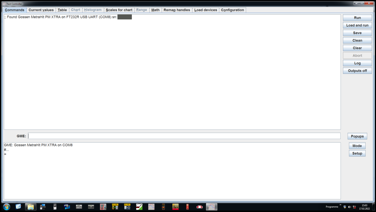

Well, in order to use it with TestController I took your script from the Metrahit Energy and modified the IDs...
... and started the debugging mode...
This is what I got...
;; Found Gossen MetraHit PM XTRA on FT232R USB UART (COM8) sn:
Look like it answers to *idn? command
;; GME: Rx <Error 01:Not implemented command:VAL:L?>
But not to the "VAL:L?"
You have to find the correct command to read the values, sadly GOSSEN have the opinion that the protocol is proprietary and they do not like to share it.
But somebody has for the Energy meter: http://www.pewa.de/DATENBLATT/METRAHit-Energy-Interface-Protokoll.pdf
When I change the measurement it is always shown correctly, but I don't get a reading. Is there something I can do? Do I have to modify your Energy-Script any further, to get a correct reading? Is it better to rename "GME" (= GossenMetrawattEnergy?) into something else, in order to have a distinction between both DMMs?
The definition for the Energy meter contains lots of stuff that is only supported by the Energy meter. For another meter it is best to remove that and then maybe add stuff that is supported by that meter.
The handle is not critical for the function and there will probably not be any problems using the same for another Gossen meter.
Only issue is that when loading saved csv files the handle is used to locate the device for information about how many decimals to show for each value.
The following users thanked this post: PushUp

;; Found Gossen MetraHit PM XTRA on FT232R USB UART (ttyUSB0) sn: XXXXXX
IDN? shows:
IDN?
;; GMC,METRAHIT PM XTRA,IDENT NO.: M250A,SERIAL NO.: XXXXXX    ,SW: 2.04

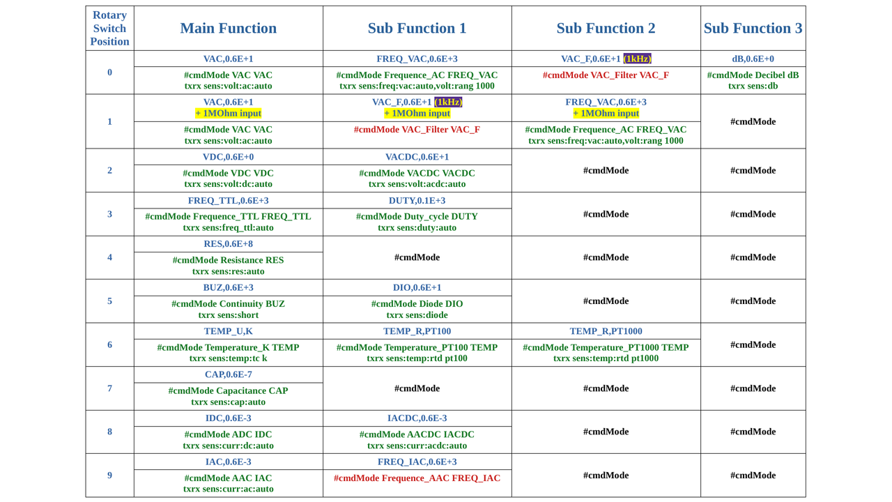

I think there are some points, where I need some help/hints, please...  ;)
With hindsight, I changed the handle to "PMXTRA", because "GMX" always reminds me of my E-Mail-Provider "gmx.de".
Well, generally speaking I think the Gossen Metrawatt PM XTRA will work now together with TestController - at least it does it for me with room for some improvements I guess! As I have a clamp meter, but no clamp sensor, I haven't considered the "Clip" thingie yet.
The big difference in contrast to the "ENERGY" is the fact, that the PMXTRA requires always the use of the rotary switch by hand any time you want to have another main measurement (= position of the rotary switch from 0 till 9 = 10 positions).
Therefore it is in a way useless to build a "mode popout", but as you can control quiet a lot with the Gossen Metrawatt in general, it would be a nice gimmick, especially to make a SetUp for changing some settings easier, than manually via the command line in TestController.
I think, that there is a restriction in TestController as far as the amount of "places" for the "mode popout" is concerned:
#cmdModeLayout 4 10
...is obviously too much...and although I know, that it is a waste of space, I wanted to have it this way:
..., in order to have a better overview of the correct rotary switch position (red colour = does not work).
However, it is not that important as you have to be close to the DMM anyway and as I couldn't manage to get three readings to work (the one that I put a circle around), it is still not fully usable; at the moment this is the maximum of space I can use, which is of course totally fine:
As mentioned above, the rotary switch has 10 positions (from 0 till 9); you ask for the current position of the rotary switch with "POS?". If it's wrong, you don't get a reading of course.
In order not to miss something, I went through any position and function/sub-function, in order to give you the possibility to look for errors or improvements within the script.
Unfortunately there is no difference in naming when using "set?" concerning my first two not working measurements via "mode popout", as you have position 0 for VAC with VAC_Filter (1kHz) and also position 1 for VAC with VAC_Filter (1kHz), but together with a 1MOhm input, which you can see here:
I couldn't solve:
Position 0 = 3rd function
VAC_F,0.6E+1 (with 1kHz-filter)
Position 1 = 2nd function, all with 1MOhm input
Position 9 = 2nd function
FREQ_IAC,0.6E+3
All rotary switch positions with main- and sub-functions:
Position 0 = 4 functions
set?
;; VAC,0.6E+1
set?
;; FREQ_VAC,0.6E+3
set?
;; VAC_F,0.6E+1
set?
;; dB,0.6E+0
Position 1 = 3 functions
set?
;; VAC,0.6E+1
set?
;; VAC_F,0.6E+1
set?
;; FREQ_VAC,0.6E+3
Position 2 = 2 functions
set?
;; VDC,0.6E+0
set?
;; VACDC,0.6E+1
Position 3 = 2 functions
set?
;; FREQ_TTL,0.6E+3
set?
;; DUTY,0.1E+3
Position 4 = 1 Funktion
set?
;; RES,0.6E+8
Position 5 = 2 functions
set?
;; BUZ,0.6E+3
set?
;; DIO,0.6E+1
Position 6 = 3 functions
set?
;; TEMP_U,K
set?
;; TEMP_R,PT100
set?
;; TEMP_R,PT1000
Position 7 = 1 Funktion
set?
;; CAP,0.6E-7
Position 8 = 2 functions
set?
;; IDC,0.6E-3
set?
;; IACDC,0.6E-3
Position 9 = 2 functions
set?
;; IAC,0.6E-3
set?
;; FREQ_IAC,0.6E+3
That is my little interim result with the script looking like this and with some notes, what is still to do/solve...
#idString GMC,METRAHIT PM XTRA,
#name Gossen MetraHit PM XTRA
#handle PMXTRA
#port comFixedBaud
#baudrate 38400
#driver SCPIx
#eol \r\n

;#cmdModeLayout 4 10 ...is too big!
#cmdModeLayout 4 7

« Reply #2311 on: February 21, 2022, 08:29:12 am »
When you have a rotary switch, use the:
#cmdModeGet Button_Text
definition, it will add a button that can inquire the meter about actual mode.
You can use multiple commands after #askMode and then use #askModeMathFormat to combine them to a longer mode string, this will hopefully allow you to select the correct columns.
Another solution is to use #modeFromValue if the returned values contains enough information about the actual mode. This means you can put everything in the "Setup" popup and leave the "Mode" popup undefined.
