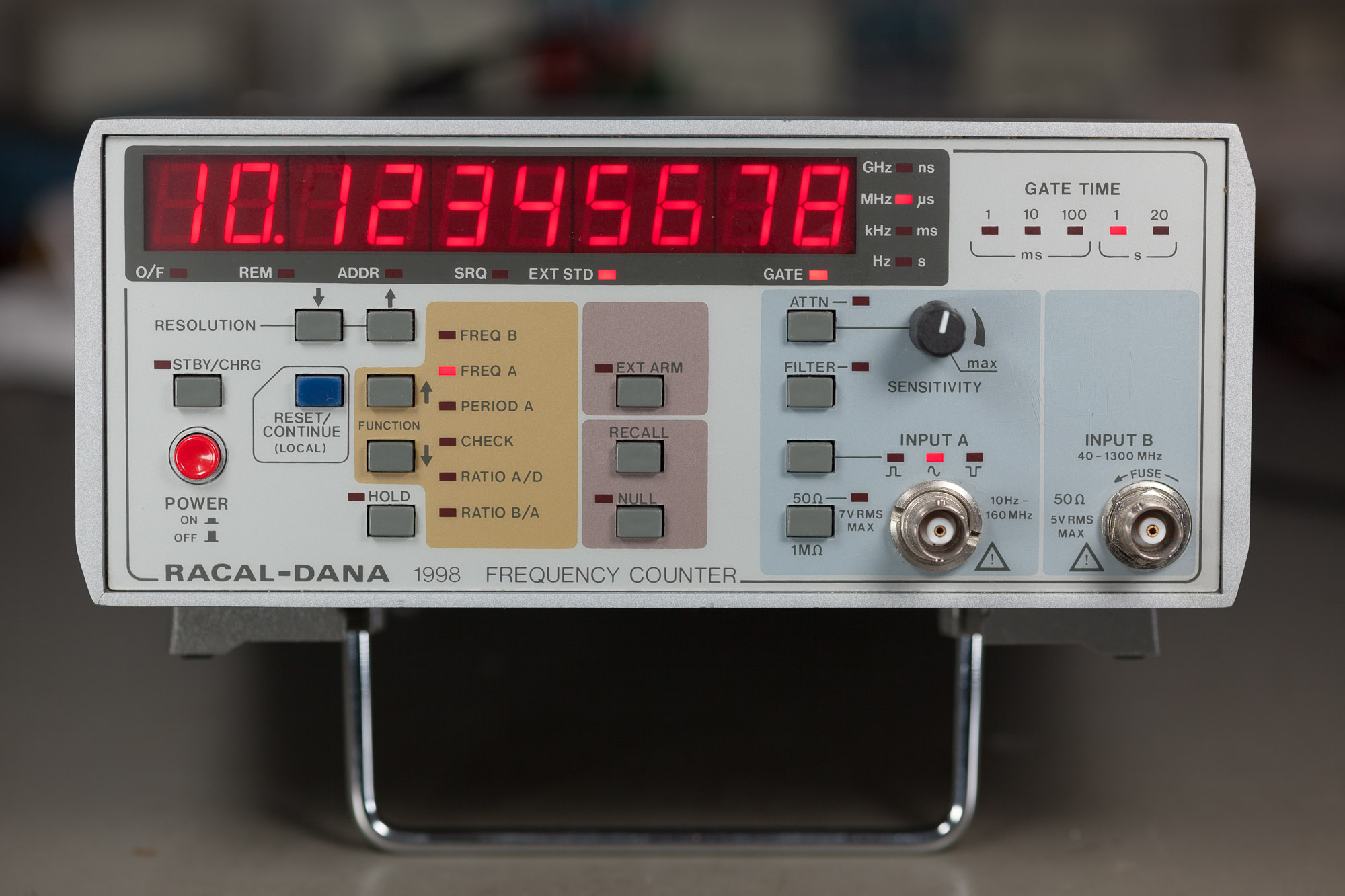

Offline Gertjan
  • Posts: 288
« Reply #2987 on: April 22, 2023, 11:51:10 am »
Hi HKJ
First I want to thank you for creating TestController, and the vast amount of your effort in the ongoing improvement and support!
I am writing a device definition file for the Racal-Dana 1998 Frequency Counter. (Almost done…)
This is a very nice counter because it is fast, easy to use, has a very clear display, and has the ability to show 10MHz with 1mHz resolution . It is popular amongst amateurs, also because it became available in large quantities as Army surplus.
All functions of the counter are supported.
I am using the counter in the single-shot mode, it takes one measurement in each logging interval.
There is more info, some tips and known issues in the header of the definition file.
As this counter is Pre-SCPI, I am using the Ascii driver. Most testing is done with the AR488 GPIB adapter.
I have two questions left:
I am using mouse-over tips (using the :tip: tag ) in the menu’s. For a few tips, I would like to divide a long line of text into 2 short lines (in other words, add a CR/LF halfway the line). I searched your documentation, but could not find the solution. How can I achieve this?
The Racal-Dana 1998 has a twin model, the 1999. Only difference is that the Racal-Dana 1999 does not have the “Ratio B/A” function. And of course it returns “1999” when asked for the model name,  instead of “1998”. So I added  meta definitions, to make this configuration file also work for the Racal-Dana 1999.
But I do not have a Racal-Dana 1999 for testing, so I can not check if I did the #meta and #metadef statements right. Could you have a look if I did the meta definitions right?
Please find the preliminary final version of the device configuration file below:
Racal1998-1999 v1.0
Regards, Gertjan.

« Reply #2990 on: April 23, 2023, 08:27:08 am »
I do not believe that is a good idea, but if it is the only way, you have to use it.
Test controller can have multiple threads fetching data from a device (mostly they will coordinate the reading).
I have not really done anything to support it, but Java has a trick to make multiline:
:tip: <html>Line 1<br>Line 2<br>Line 3A couple of other html tags are supported (it is a very old version of html Java supports).
At first glance it looks correct.
If you want to see the final definition you can put this line:
#metaDebug save
below the #metadef tag, this will write the processed definition to disk.
Please find the preliminary version of the device configuration file below:
Racal1998-1999BETA.zip
I look forward to the final definition.

I took a Photo of the Racal-Dana 1998, for if you wish to add it to your supported equipment page:
Racal-Dana 1998 and 1999 device definition file for TestController: Racal1998-1999.txt v1.0
Regards, Gertjan.
