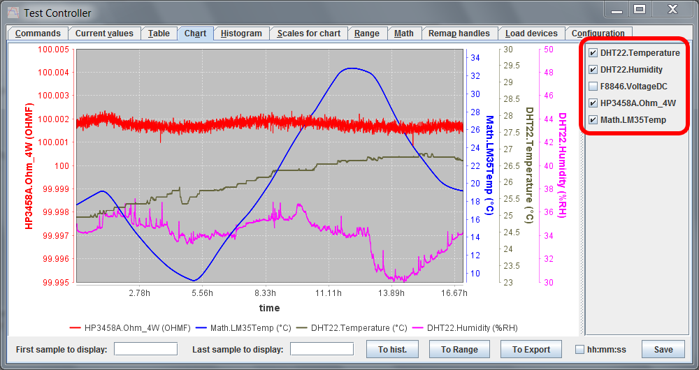

Hi HKJ,
At the moment I am using Testcontroller a lot. Usually logging with 3 to 6 traces on the Chart.
It gets annoying pretty fast that every time I stop logging (for example to fine-tune the measurement set-up), and starting the logging again, I have to re-select the traces to get them in the preferred order again...
It would be nice if the curve selection could be remembered... Maybe until other devices are loaded? Or an extra checkbox: remember trace selection?
TC chart screenshot-1000pix
regards, Gertjan.

« Reply #3071 on: June 16, 2023, 04:09:33 pm »
Hi HKJ,
As jmurray says above it can be done with a script and TC can auto-generate a script to recreate the current layout.
This is done by right clicking on the log window and select "Generate scripts" and then "Chart/Hist/Range script", you can generate it directly as a menu option for the log window.

Hi HKJ,
Thank you for the explanation. I tried it immediately.
When I click right on the log window and select "Generate scripts" and then "Chart/Hist/Range script", indeed something is running in the log & program editor window. I save the script.
When I stop, and restart the logging, I click "load and run", open the script, and click "run". Indeed the right traces are now selected, but unfortunately NOT in the right order....
So I must be missing something....
Anyway, this work-around seems like more work then just manually click the traces in the right order....
Regards, Gertjan.

I think I see the problem, I have not really seen the selection sequence as a important parameter, just that the right tracks are selected.
The script do more than just select the traces as you can see on the script commands.
If you email me a datafile and screen shoots of your selection, the restored selection and the generated script. I will take a look and if I agree you are right about selection is important and it is not too hard to fix it I will.
When doing this it might be best to generate a menu entry, it makes future selection very easy.
