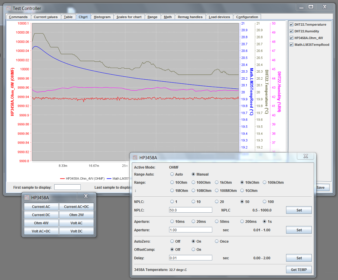

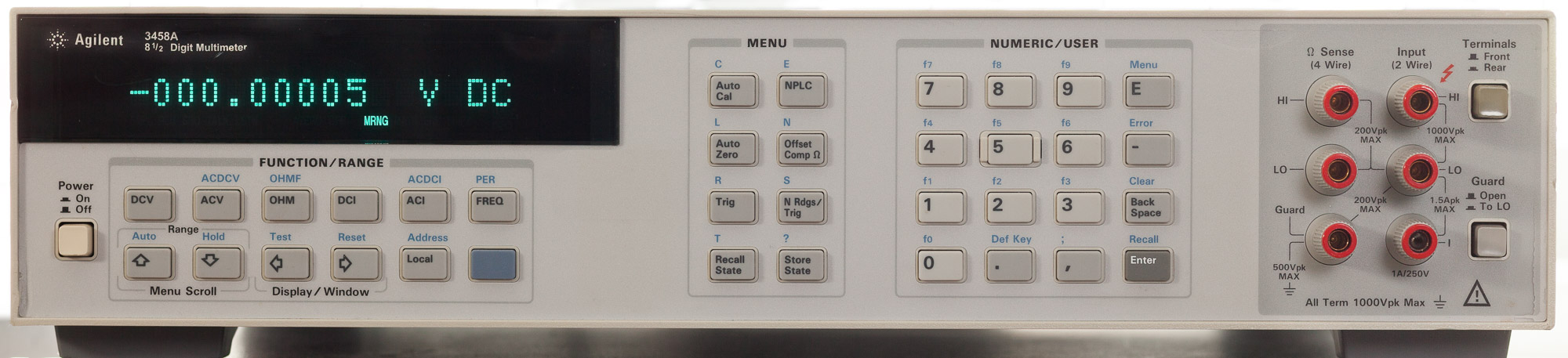

I wrote a configuration file for the HP / Agilent 3458A 8,5 digit multimeter.
The legendary 3458A is a complex instrument, designed for a broad range of tasks. From very fast systems measurements to very accurate measurements in calibration labs.
This configuration file is more targeted to high accuracy measurements then very high measurement speed. (For speed, I think the basic implementation of GPIB in TC is the limiting link. With single measurement data requests / readouts about 30 values/sec. But for system measurements there will be custom control software anyway…)
All configuration options I am using, and all settings that could be necessary for high accuracy measurements are in the menus:
There are double menu settings for the important parameters NPLC and Aperture (A/D converter integration time).
For quick setting of the most common values  one can use the piano buttons. But one can enter any valid value in the entry field of the number control if you want a different setting. (or a specific setting is specified in a procedure)
An advantage is that the numbers in the entry fields will always show the current settings used by the meter. No unnecessary luxury with so many settings that all influence the measurement result.  :)
It is also educational to see how NPLC and Aperture are interacting.
I have tested this configuration file with a Agilent 3458A, but it should also recognize the new black Keysight 3458A. (only the identification string should be different)
I implemented commands for AUTOCAL and TEMP? (internal temperature), so these can be used in scripts. But i removed Autocal from the menu as the risk of mishaps is too high (Auto Cal with cold meter, meter is blocked for 10 minutes, still voltages connected to the terminals)
Please find the definition file here: AgilentHP3458A.zip

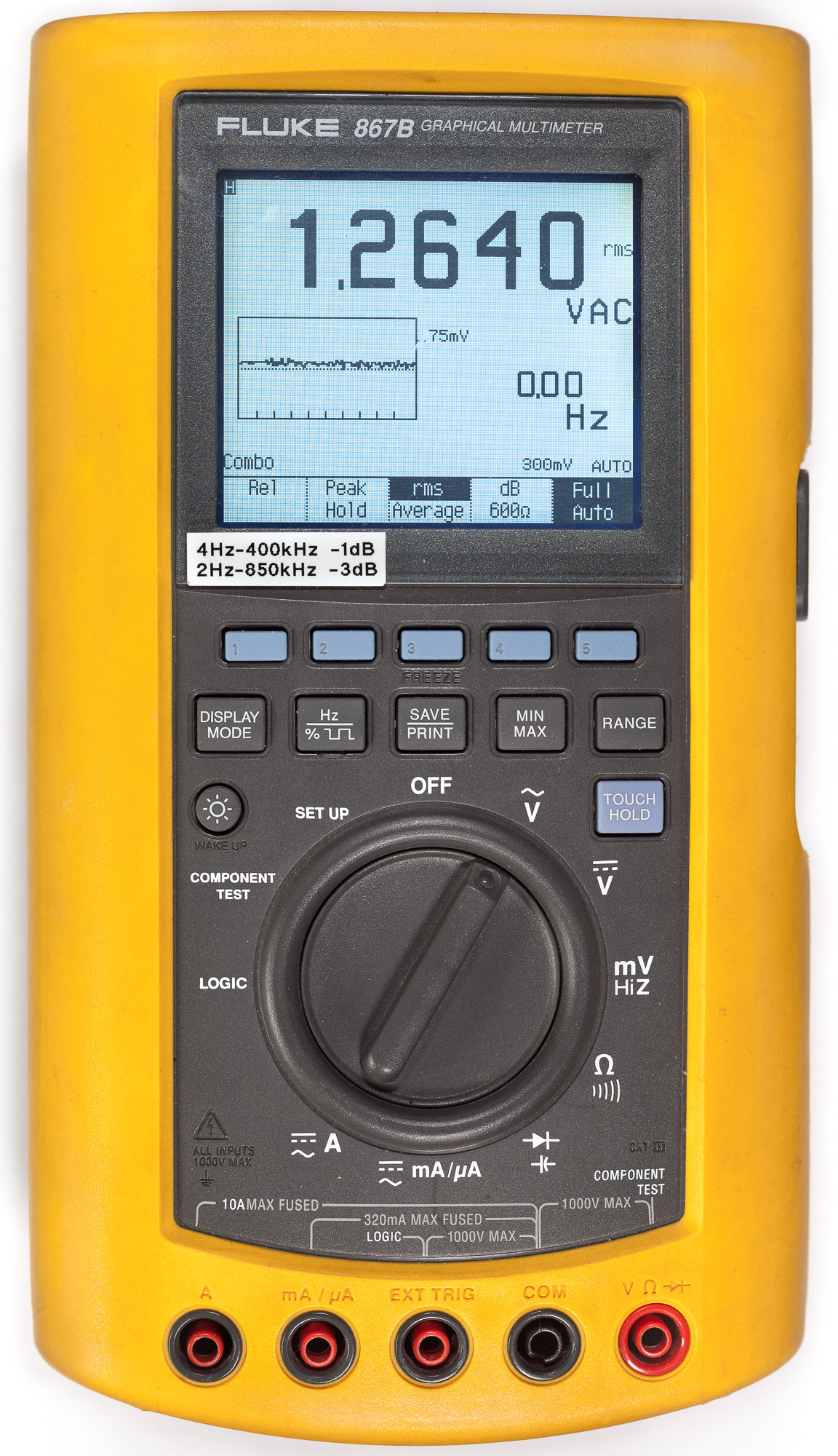

Here is a device configuration file for Fluke 863, 865 and 867B Graphical Multimeters.
I wrote and tested the definition with a Fluke 867B. But it should work for the other of the members of the 86x family too.
These meters have a mechanical rotary mode switch. So there are no menu’s. All function switching and mode selection is done on the meter itself. The actual mode is decoded from #askValues.
Actually there are two configuration files. I started with a definition which is only reading the main display, heeding your advice:

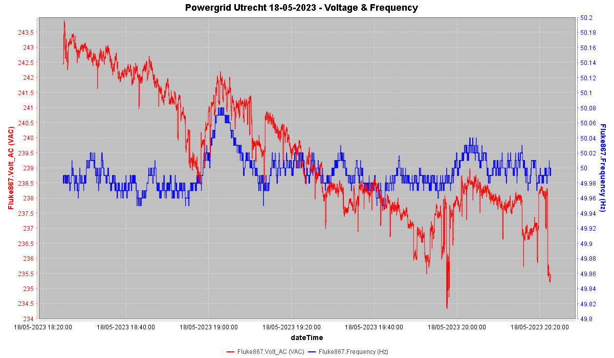

But this meter has a very nice and extensive dual display function.
And with it’s opto isolated RS-232 connection, and extremely well isolated mains adapter, it is very well suited for things like monitoring the mains. For such cases it is handy to log Voltage and Frequency with one meter:
So I also wrote a configuration file for reading both primary and secondary values. Indeed this definition reads slower. (It is not a fast meter to start with: calculating RMS etc. just takes some time with this meter…)
In practice both configuration files coexist happily next to each other. And I just choose the one that is most suitable for the occasion. In the past months I used both about the same amount of time.
Unfortunately my programming skills are insufficient to combine both into one configuration file. (and keep the advantages of both)  :-[

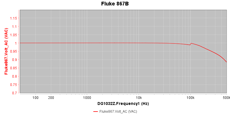

Just for fun, and for your Multimeter frequency response page, here is the frequency response of the 867B:
Chart is added to webpage
