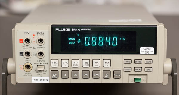

I wrote a definition for the Fluke 8840A Digital Multimeter.
These still popular meters have been produced for 20 years, starting around 1985.
Early versions of the 8840A did not have a GPIB command for identification. So, to be compatible with these early 8840As, by default this definition does not verify the model number.
But for later versions (ca post 1990) one can enable model identification by removing the semicolon at the start of this line: "; #verifyDevice "8840A" model?".
As usual, more info in the header of the definition. Detailed info on all the different GPIB board versions in this post: Fluke 8840A/AF GPIB board.

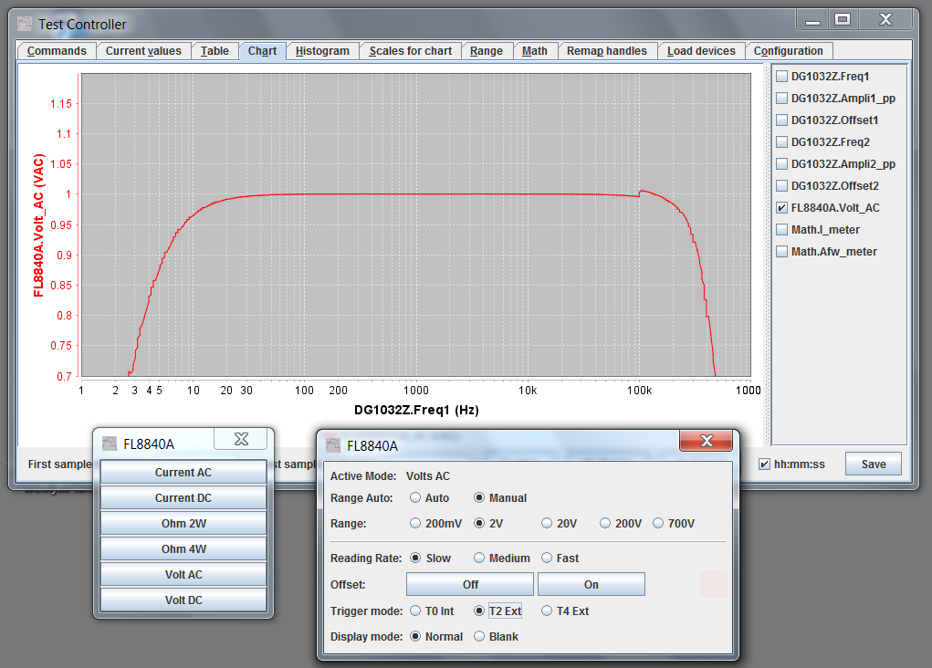

A screenshot of the menus:
The menu structure is inspired on HP 34401A menu by WA
I added the “Display mode: Normal / Blank” Menu item because the manual states that readings in the fast mode are more accurate with the display blanked.
Trigger mode and display mode options are explained in pop-up tips.
Beside the menus the screenshot is showing the frequency response of the 8840A.  3dB down at 450kHz is not bad for a meter designed in the mid-eighties!
The rest of the 8840A is very solid too: The reference is the famous SZA263 (also used in the Fluke 732A and early 732B Volt standards). There are very nice laser etched precision resistors on ceramic too. These meters are very stable. My meter is still in spec after a last cal in 1997...

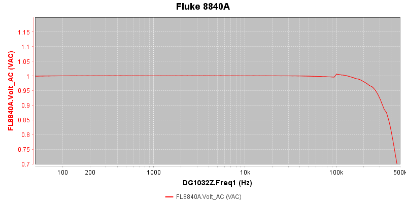

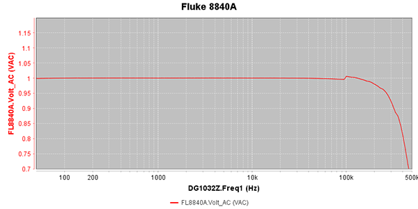

The same frequency response in the standard format for your Multimeter frequency response web page:
As usual, you are welcome to use my pictures for your website.
This will be included in the next release.
I have already included it on the page.
