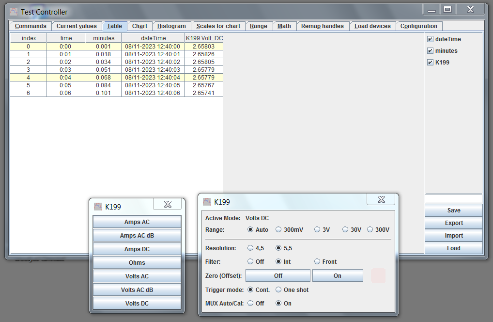

Hello again!
It seems to work now, thanks! I modded the already existing file and added a changelog. Continuity is now an option too (strangely the meter returns values in volts rather than ohms).
Best wishes!
Replace these two lines:
#value VoltageDC V D4 VDC, VACDC, DIODE
#value Resistance OHMS si OHMS, CONT
and report back.

Hello again!
These changes do not work, still reporting in "voltages". Even in the manual (and on the display) the value is reported in "voltage" rather than "ohms". So i guess it works as intended, just some oddity with this meter.

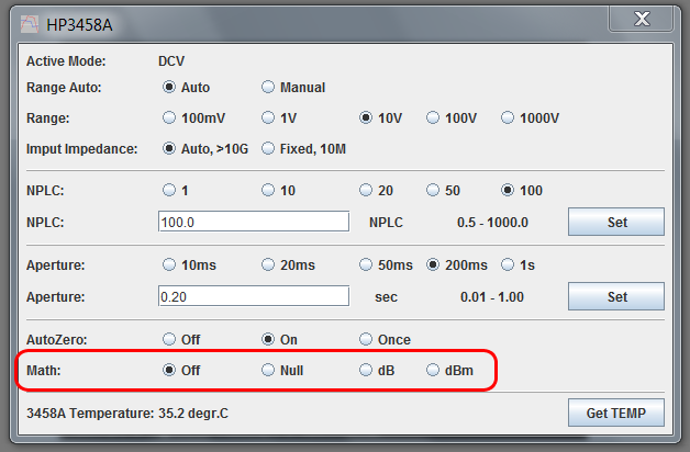

Hi HKJ,
Here are three updated definitions.
I added a few math functions to the HP / Agilent 3458A setup menu. (I needed the NULL / offset function):
Also I found a small bug in this definition. Checking my other definitions, I also found this small bug in the Racal-Dana counter definitions. So I updated those too.
AgilentHP3458A v1.03: AgilentHP3458A.zip
Racal1991-1992 v1.02: Racal1991-1992.zip
Racal1998-1999 v1.02: Racal1998-1999.zip
Best Regards, Gertjan.
All 3 will be update in next release.

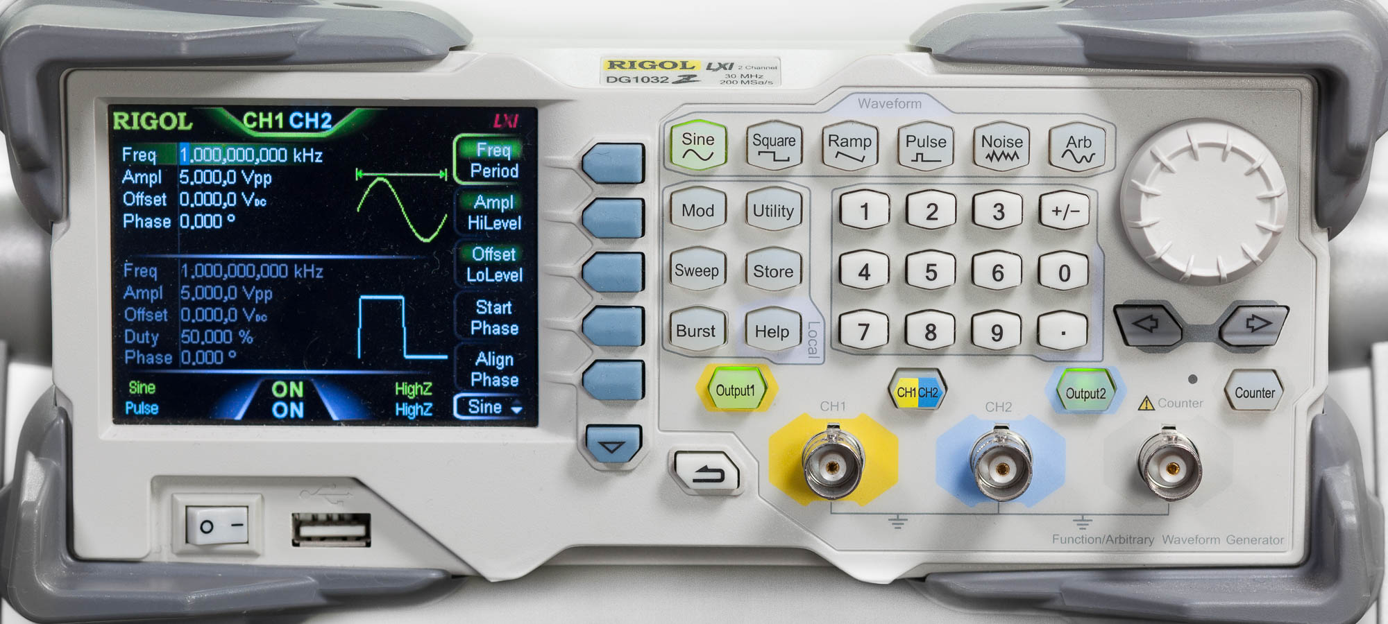

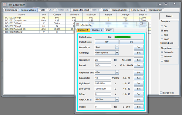

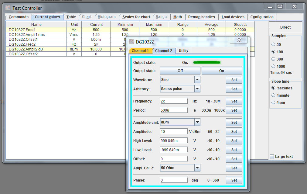

I wrote a device definition file for the Rigol DG1000Z series ARB Generators (DG1022Z, DG1032Z and DG1062Z)
This SCPI definition is based on the Rigol DG9xx config file by bateau020. Which in turn was based on the SiglentSDGxxxx definition by  HKJ and klausES.
Mostly is was an adaption to the capabilities of the DG1000Z. And work around the SCPI quirks of these ARBs. For instance, querying the (ARB) DC offset does not work. Instead of the offset for DC, the offset for Sine is returned. As a workaround, the DC offset value is now also written to SINe, to get the correct TestController read-out.
The setup Menu for DG100Z:
Please find the definition file here: Rigol_DG1000Z.zip
Regards, Gertjan.
They will be included, thanks.

   Added: Rigol DG1022Z, Rigol DG1032Z, Rigol DG1062Z arb generator (Thanks Gertjan)
   Updated: HP3458A and Racal (Thanks Gertjan)

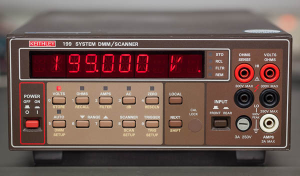

Hi HKJ,
Congrats with the new version. But is there room in V2.44 for one more definition? :)
This is a definition for the Keithley K199 System DMM.
This oldie but Goldie is still popular and rightly so. It is fast and stable. The big red alphanumeric LED display is a pleasure to use, and readable from a long distance.
It's non-heated reference makes the meter usable right after switching on. (although the draw back is of course a slightly worse tempco.)
Just like modern Keithley's, it reduces noise by using selectable intelligent filtering, instead of longer NPLC's. So it can be fast, and still have a stable, noise reduced, reading.
Over the GPIB there is an extra digit, that is still stable.
A nice feature is "Auto/Cal Multiplex". The Model 199 has built-in multiplex routines that automatically calibrate and zero the instrument, so as to maintain its high accuracy. When enabled this is done before every measurement.
All K199 functions are supported in this definition:
A lot of Keithley 199's are equipped with a scanner card. This definition does not support that scanner card. I tend to just use more DMM's :).
Also useful are the AC dB modes. TRMS, with 0dB=1V, or relative.  A continuos range from -75dBV to +49dBV, with a resolution of 0,01dB.
And the frequency range is also not too shabby:
With -1,21dB @ 500kHz, this frequency curve can compete with any modern meter. (-3dB 5Hz...880kHz)
Please find the Keithley K199 definition file here: Keithley199.zip
Best regards, Gertjan.
