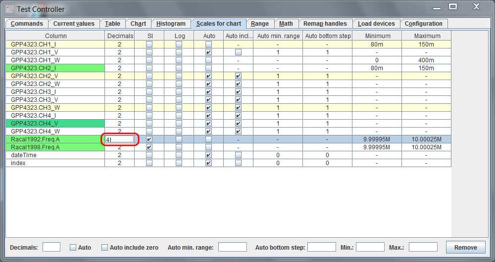

Hi HKJ,
I think I found a bug in the "Scales for Chart" tab. I can not change the number of decimals for the chart anymore:
One can enter a new value, but when (after entering the new value) pressing TAB or Enter, nothing happens. Only with Escape I can leave the field, which returns to the old value (always "2")
At the moment of pressing TAB or ENTER a list of errors are appearing in the debug log:

I tested on two systems, one is running Windows 10, the other Windows 7. On both systems the problem is the same, and the error logs are also (more or less) the same.
Both systems are running the latest version of TestController (2.44). Both systems are using Oracle Java, auto-updated to the latest version. (Version 8, Update 4.11)
Here are for your perusal both complete error logs: TC_debug_logs-change_decimals.zip
Thanks for the error report, I have found and fixed the bug now.
For a fast workaround, you can stop TC, edit Settings\settingsScales.txt, then start TC again.

« Reply #3506 on: June 08, 2024, 04:32:34 pm »
Hi HKJ,
That was quick. :-+  Thanks!   The workaround works for me.  :)
Regards, Gertjan.
