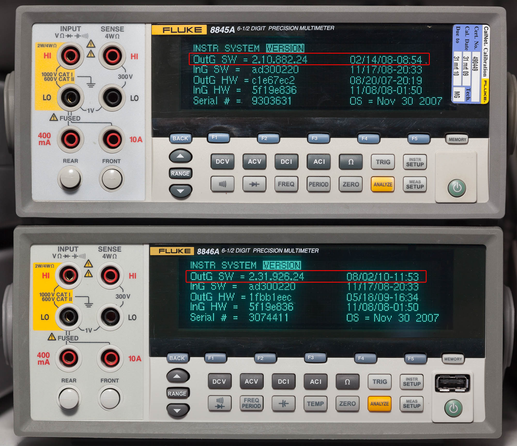

I found that the Fluke 8845A / 8846A  device configuration file is not working with meters with older firmware.
This definition is using the FETCh3? command for retrieving the measurement data. But this command is only available in later firmware versions (post 2008)
It is a known problem, described here: FLUKE 8846A does not respond to FETCH3? command
IMG 2991  Fluke 8845A-8846A firmware versions-2000pix
The upper meter, the 8845A has the older 2008 firmware, and there is no measurement read-out in TestController.
The lower meter, the 8846A, has the newer 2010 firmware and is perfectly usable in TestController.
For now, this is just a heads-up for 8845A / 8846A owners.
I am in the process of writing a new device configuration file for 8845A / 8846A, using commands available in all firmware versions.
(The existing definition is just a skeleton. Apart from the FETCh3 problem, it has only a Mode Menu and no advanced configuration (Setup Menu) at all)
regards, Gertjan.

Hi HKJ,
I am working on a new definition for Fluke 8845A / 8846A. I also want to support the GPIB connector.
I found something odd (maybe a bug?) using [LOC] to terminate the GPIB connection, and set the meter back to local control.
[LOC] does not seem to work. However, sending ++llo and ++loc from a terminal program to the 8846A works as expected, setting the meter to remote and back to local.
The relevant part of the definition:
#port GPIB
#driver SCPIx
#finalCmd [1000];[LOC];[2000]
The resulting log:
;; FL8846A: Delay: 1000ms
;; FL8846A: Delay: 2000ms
;; COM9: Close
The delays are executed, but between the delays nothing is happening.... The meter stays in remote.
But when I change the definition code to this:
#scpiCmd gpibExit
[LOC]
#finalCmd [1000];gpibExit;[2000]
The [LOC] command is executed:
;; FL8846A: Tx <gpibExit>
;; FL8846A: Tx <[LOC]>
;; COM9: Tx: <++LOC.> 2B 2B 4C 4F 43 0A
;; COM9: Close
Now the [LOC] is sent to the meter, and indeed the meter goes back to local as expected.
What is going on here, and why does the first approach not work?
I am using the latest version of TC (v2.53) and AR488.
regards, Gertjan.
