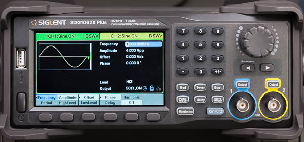

I updated the Siglent SDG definition with extra #metadefs for the new black Plus generators: Siglent SDG1022X Plus, SDG1032X Plus and SDG1062X Plus.
IMG_4486_Siglent_SDG1062X_Plus_front-2000pix.jpg]
Most work was the testing of all functions in this very nice and very comprehensive definition :). (It is an excellent example for other ARB definitions).
All functions in the definition are working perfectly with the new generatior. Very nice to see that Siglent is very consistent with the commands for all SDG generators!
I tested with a SDG1062X Plus, V1P.1.1.1.42R2 and TestController v2.64.
First impression of the generator: very nice 16bits generator, but with a looong boot time (44sec!)
Please find the updated Siglent SDG definition here: SiglentSDGxxxxX.zip
As always, you are welcome to use my images for your website.
regards, Gertjan.

« Reply #4448 on: August 30, 2025, 01:16:04 pm »
I did not forget the definition. Please find the link here :)
I am gotten to used to included files.
I cannot find the 1022 in the file, but there is a 1025?
Online Gertjan
  • Posts: 290
« Reply #4449 on: August 30, 2025, 01:42:16 pm »
Hi HKJ,
This time I stand corrected :). Good thing you proof-red the definition...
I updated the definition, please re-download the ZIP file.
regards, Gertjan.
