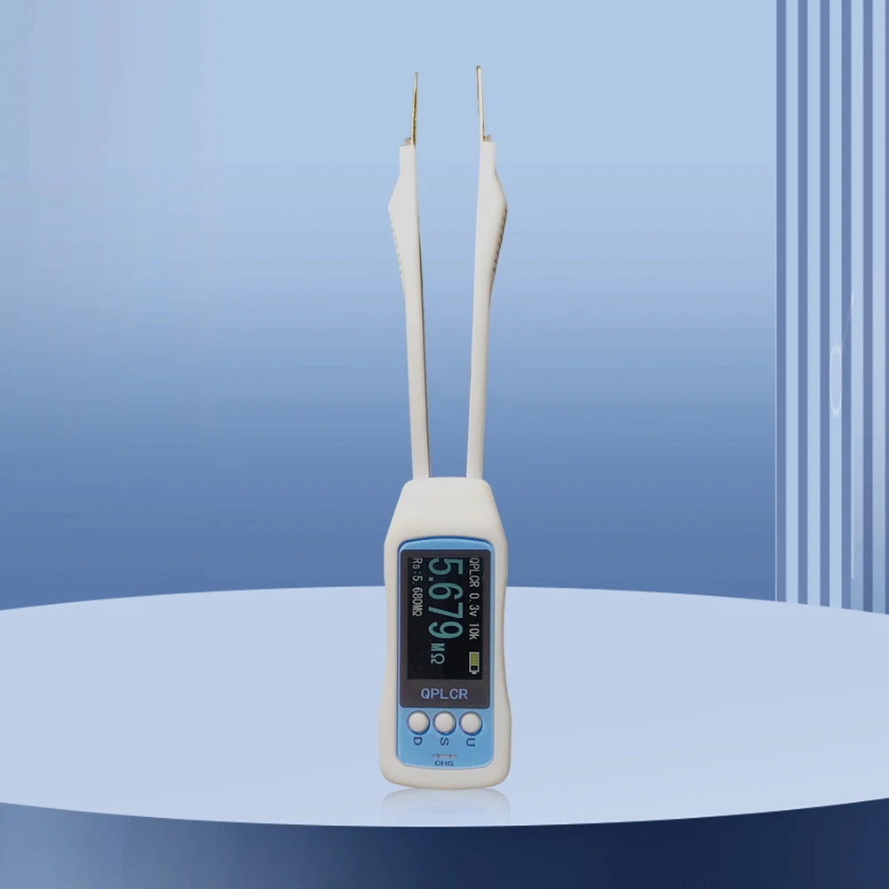

Relative Cheap LCR Smart tweezers are coming out of China in bulk these months.
Specs.
0. Measure voltage (up to 16V)
1. Measurement frequency: 100Hz/120Hz/1kHz/10kHz/100kHz
2. Measurement voltage: 0.1Vrms, 0.3Vrms, 0.6Vrms
3. Measurement type: resistance, capacitance, inductance, voltage, on-off, diode
4. Resistance range: 1Ω~10MΩ
5. Capacitance range: 1pF~22mF
6. Inductance range: 1uH~22H
7. Voltage range: ±0.1V~±16V
8. Basic accuracy: 0.5%±2
9. Use time: 7 hours continuously
10. Battery capacity: 500mAh
11. Charging voltage: DC 5V
12. Charging current: 200mA
13. Screen size: 1.47inch, 172*320 resolution
Shell material: ABS+metal
Product size: about 138.00x22.00x15.00mm
Product size: 5.43x0.87x0.59inch

Good luck to everyone! I finally got the QP LINK LCR1S tonight. It looks like a good device. And the calibration complete board looks like a kind of dummy, since only resistors are soldered on it, there are no inductors and capacitors, there are only seats for them.
Online DaneLawTopic starter
  • Posts: 661
What's your impressions sofar, does the Tweezer also perform?
As speculated above, It does looks to be from the same "QP" vendor, that also makes the 3'button-white QPLCR, that is making the QPLINK when looking at stores, though the screen UI is also very similar.
Tons of sellers pop back up on Aliexpress.
from around 60$ and up (incl. danish EUVAT)
The following users thanked this post: ivan1956
Offline ivan1956
  • Posts: 4
  • Country: ru
I bought it at the "House Improve Tool Store".
The tweezers for SMD parts turned out to be very good (for comparison, I also have Shannon ST42, FNIRSI LCR-ST1, HP-990C and some other devices), it is much better than FNIRSI LCR-ST1.
Measures the voltage (deviations from the source of the reference voltage are hundredths of a volt). At the same time, it also measures the internal resistance (ESR) of chemical power supplies, giving readings close to those shown, for example, YR1035+.
It measures both the capacitance of capacitors and inductance quite accurately, while showing Q-factor readings close to those of ST42.
This device has control modes for "left-handed" and "right-handed", it is configured in the menu (by long pressing the left button), there is an "Auto" mode (in which the image turns over depending on the position of the tweezers), there are also fixed positions.
In the "Menu" there is a choice of the type of equivalent connection - "serial" and "parallel". However, the connection type is not displayed on the display (as in, for example, ST 42).
The control of the tweezers is convenient, the purpose of the control buttons is easy to remember (there are no instructions included with the device, but as soon as I picked it up, I began to use it, as if it had been with me for more than one year). By the way, there is no charging cable (USB TYPE-C) included, we must also keep this in mind.

Now about the disadvantages. It makes measurements of diodes, one can say, no better than FNIRSI LCR-ST1 (with firmware version 1.5). That is, it determines the polarity of the connected diode, shows some kind of voltage drop at the semiconductor junction, but it seems impossible to believe this (like FNIRSI LCR-ST1, it does not show the sum of voltage drops on series-connected diodes, as Shannon ST42 and HP-990C do, but some abstract number). It does not recognize two series-connected silicon diodes, it recognizes only germanium diodes (Schottky diodes were not used).

Thanks a lot for the user manual for LCR 1S! Do you also happen to know if a FW update is available (or have a link to QPLink site)?
I have played a bit with the tweezers and it looks like the 100kHz mode is a bit gimmicky and not really a fully functional one. For example it refuses to measure caps above 1nF at 100kHz (although the manual stated it should work).
Surprisingly there are a few features supported in the cheaper models (FNIRSI, ZOYI, Aneng etc.) that are missing here. For example the measurements recording, diode polarity detection etc.
Overall I am not sure the higher asking price of LCR S1 is justified unless the additional functionality it has is a must have for the intended usage.
