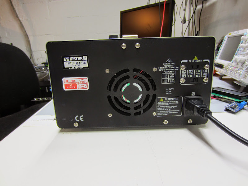

The fan didn't kick on until I had the supply loaded full out for a few minutes, but it was noisy getting up to speed. I'm not particular about these things, but being a used supply, it may simply need some attention.

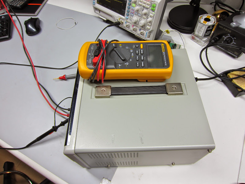

The power supply is a nice size (87V for comparison); smaller than it appeared online.
a
Voltage and current readings were spot on throughout both independent ranges, series and parallel. Unfortunately the lack of resolution on the display and lack of granularity on the single-turn control pots makes this supply unsuitable for powering low voltage cores and the like. However for my intended use, it's perfect for supplying regulators, split DC bus rails, etc:

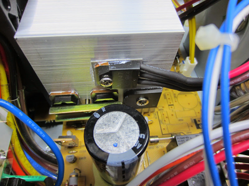

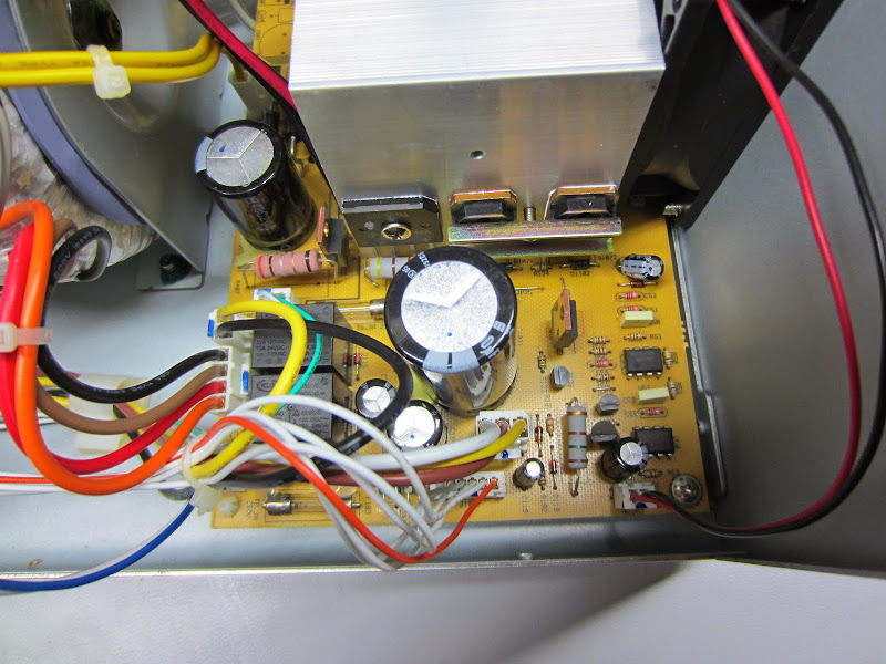

Channel 1 arrangement with rectification, power amps, tap selection relays, etc.
Channel 2, with the addition of a power NPN, presumably for the fixed +5V/3A output. This flying lead arrangement seems a bit lazy, but otherwise the internal construction is on par with the price point this supply hits (a good one, in my opinion).

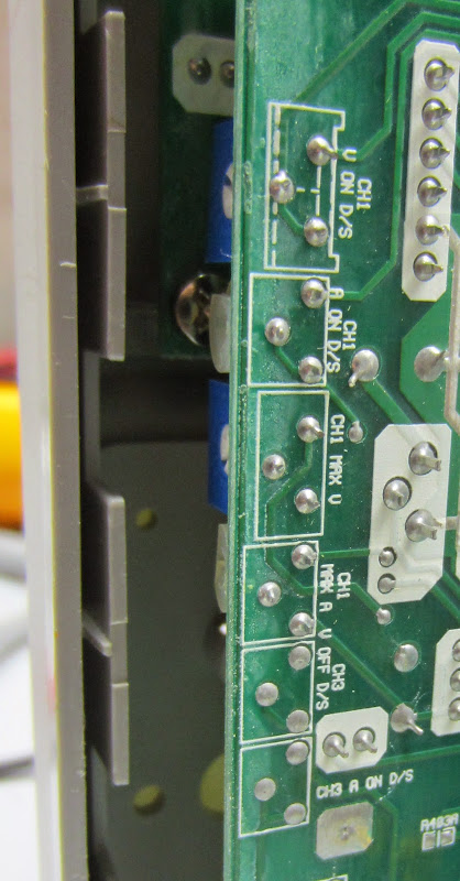

There are a plethora of adjustments surrounding the front panel PCB, each labeled accordingly. A full adjustment procedure is attached to this post. The supply actually maxes out around 32V/3.3A per channel.

Furthermore, my little unit uses a pair of 2SD1047 NPN transistors for the Ch1 / Ch2 series pass transistor and a single 2SD1047 for Ch3 (fixed 5V / 3A).
(Frank mentioned that the Siglent uses IRFP150N MOSFET devices)
Another thing is that my GPS3303 only uses Jamicon 4700uF/63V caps as the primary Ch1/Ch2 bulk caps versus the Rubycon 6800uF/63V shown in the Siglent.
I've oft heard it mentioned that we need somewhere close to 2000uF per output Amp as a good 'rule of thumb'.
(I guess I should throw a scope on those caps sometime when I am sucking out 3A into a dummy load?)
Still, the devices are so strikingly similar that you have to wonder at the level of incest that was involved.
You'd have to start thinking that there was only ONE way to layout the internals of a PSU?
I am willing to bet that the same 0-6-18-30 windings exist on the xformer for Ch1/Ch2?

It's definitely quite a similar design... But even the power PCB layout on my GW-GPS-3303 differs a bit from the pix Frank shows.
I think that's perfectly reasonable decision to reuse the proven design and not to reinvent the wheel just for the sake of it. Provided none of them just ripped off the other's design, that is (and there's no reason to suspect they have). It just felt a bit weird for me to find this as I spent some time tinkering with my unit (see Frank's thread). Kind of like getting in someone's car and realizing it's basically the same design as yours, only with the little different body and shape of switches on the dashboard, I guess. I believe mine (Siglent SPD3303S) has 4 gears... err, I mean transformer taps ;)

I've got a couple of these power supplies and they are great. Here is the main board view as it may help someone else. Definitely no room for multi-turn pots..
