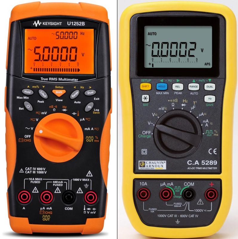

Just an old find, which may change your mind:
Last week I bought an used "Chauvin Arnouix C.A 5289" via our local ebay (now called "Kleinanzeigen"). Some years ago I sold my Agilent U1272A as I am still happy with my Keysight U1273A, but the settings of the C.A 5289 reminds me of the good old Agilent, so that I am quite sure that one of those - maybe Chauvin Arnoux (sorry CA, if I am mistaken!) - is a rebadge?!
This time, however, I prefer the rebadged DMM C.A 5289 as I am no fan of the button design and colour of description of this Agilent/Keysight. Both can measure up to 500 MOhm resistance and up to 100 mF capacitance, which was the reason for me to buy it, as all new DMMs are not able to reach these values anymore - don't know why???
...and yes I have enough LCR-Meters, to prevent a longterm discussion about the use of DMMs having this ability, because no one can deny the fact that it is still useful being able to measure capacitance, to get a fast overview before going any deeper in measurement... ;-)
...but other than that, I don't know the inner values in order to compare any further...perhaps some other users have any better information about it...
The build quality and feel is simply perfect - even after all this time!
Cheers!  ;)
The following users thanked this post: EEVblog, shakalnokturn, Markus2801A
