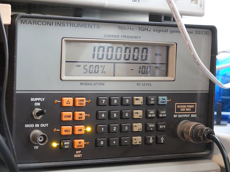

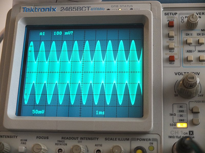

I have both Tek 2465BCT and Agilent DSO3062A on my home bench, however the DSO is only used if I need it's specific abilities (to capture a single shot or a very slow process, to export a picture to my computer), for any live circuit work the analogue scope works much better for me due to the instantaneous beam response and WYSIWYG. That means I use the Tek 99% of the time. At work I have much fancier DSOs however it is a real pain if I have to work on a live HV/RF circuit with a DSO and I miss my Tek greatly. I may yet persuade my boss to get me a refurbished Tek 2465B/BCT  :) .
Cheers
If your DSO 'beam' isn't responding instantly then maybe you need to adjust a setting. The DS1054Z can grab 30,000 wavforms/sec if you let it.
Who made the DSO3062A?It doesn't look very Agilent, is it an older rebadged Rigol? Id so I concur, I'd be reaching for the 2465B too.
As I've said, I have some better DSOs at work - the Tek MSO2024 and Agilent DSO1014A and still I would prefer the 2465B. The Agilent scope at home is old but still adequate for it's capture capabilities when I need these, so I'm not upgrading it any time soon.

Well, just as a teaser - could somebody post a screen shot from the Rigol DS1054Z (or a similar DSO scope) of a 100Mhz signal with 50% AM modulation at 1kHz. A screen from the Tek 2465BCT is below.
Cheers
Alex
« Last Edit: November 07, 2015, 10:43:41 am by Alex Nikitin »
Source: HP 8656B, 50% 1kHz AM modulating 100MHz -10dBm carrier.
Rigol DS1054Z suffers beating and intensity gradient doesn't work at all well (24Mpts, 1GSa/s).
Tek MDO3054 has similar difficulties with intensity grtading (10Mpts, 1.25GSa/s).
Aglient/Keysight MSO7104B looks better, but by no means perfect. Looks better if the timebase time is reduced and therefore sampling rate increased (8Mpts, 400MSa/s).
So in short I think you're going to struggle to get an analogue style display on most DSOs with this particular test. Whether the test is a reasonable and regularly experienced scenario, I'll leave for others. Certainly it's not one I encounter in practice, although I'm aware it's a common test albeit usually with a much more relaxed carrier:modulation ratio. I'd be using a frequency domain instrument first and foremost for this myself!
A classic two tone test waveform for an SSB transmitter is a good example for showing the relative strengths and weaknesses of analogue vs digital scopes.
In the time domain a decent analogue scope CRT (eg something a class above the Tek 2465 CRT) is really nice to look at provided the CRT is well set up. The 2465 really isn't a good choice here. Some of the older Tek scopes really are wonderful to use like this as they have a really sharp display. eg the Tek 453 series or even my old Tek 585.
But the DSO will be king in the frequency domain because the analogue scope can't compete here at all. Even my little TDS2012 can show the bandwidth of the signal using the FFT mode and it can display distortion terms of AM or SSB signals quickly and easily with decent refresh rate and reasonable dynamic range as well.
Partly why I keep my old Tek 465 is for (casually) looking at modulated RF waveforms in the time domain because it is so easy to use for stuff like this. I've not found a DSO at work that can compete (at a realistic price point) for time domain stuff like this. But pretty much everywhere else, even my old TDS2012 kills the 465 in terms of scope performance.

Most unfair since the DS1054Z is a 50MHz scope. And yours is not a screenshot. Analog scopes don't do screenshots.
Actually, that is exactly where the term 'screenshot' comes from - taking a picture of the image on an analog scope's CRT with a special photographic camera.
BTW, what modern scopes like the DS1054z do is not a 'screenshot', it's actually a 'screen dump' because they don't take a 'shot  of the screen but dump the content of the video memory into a file. It's just because people were more familiar with the term 'screenshot' so they still use the term for DSOs.
« Last Edit: November 08, 2015, 07:47:24 pm by Wuerstchenhund »

Next try, this time I did even pay attention to the timebase settings  ;)
Again, source is a R&S CRTU-RU at 100MHz modulated at 1kHz AM 50%. The scope is a provisionally assembled LeCroy WaveRunner 64Xi, and since the CRTU-RU has no Mod out it's triggered from the input signal.
These screenshots show the signal in Persistence (intensity graded) mode at 500MS/s and 1GS/s:
https://www.eevblog.com/forum/testgear/recommendation-request-new-rigol-ds1054z-or-used-tektronix-2467bhd/?action=dlattach;attach=180776;image
And this is what it looks like in Normal mode:
At 2GSa/s:
And at 500MSa/s:
Anyways, as it was said above that's a pretty synthetic test for a digital scope which is unlikely to matter in a practical sense.
« Last Edit: November 08, 2015, 08:17:00 pm by Wuerstchenhund »
