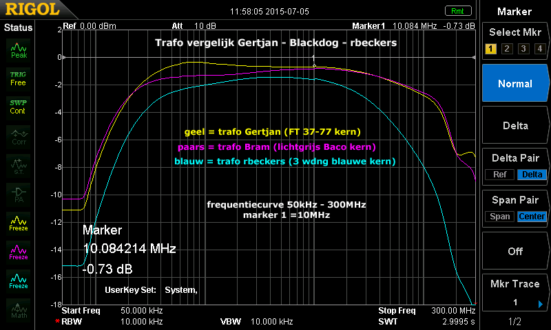

Recently I did a lot of measuring frequency curves of 10MHz transformers.
I noticed the amplitude discontinuity at 10 MHz, but with a new normalise it would disappear.
The problem was worst at a TG level of 0dBm. Taking the TG level a few dBm down made the problem much less bothersome.
Here is an example, comparing frequency curves of three transformers:
Regards, Gertjan.

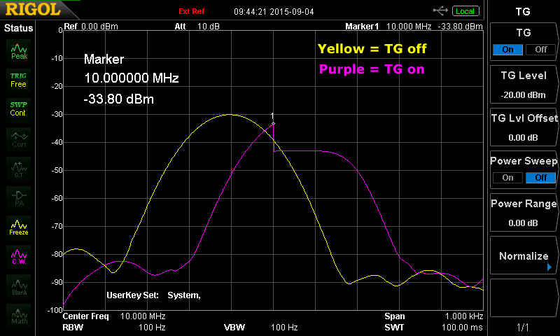

I tried to replicate Howardlong's findings, exactly following his test setup.
On my DSA815-TG I cannot reproduce the amplitude discontinuity. The 156 Hz frequency upshift of the displayed spectrum however does appear as soon as I activate the TG.
Yellow: 9.9999 MHz (from a DG1032Z) without TG active,
Purple: with TG activated (level of TG does not seem to have any influence), note 156 Hz shift.
Also notice the 1.5 dBm lower peak level... what gives?
« Last Edit: September 04, 2015, 07:33:06 am by pa3bca »

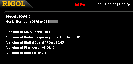

I reproduced exactly the same screen shots as pa3bca:
It appears the difference is in the version of the Main Board.....
pa3bca has an older Main Board, version 00.04 (with boot 01.03)
I have a newer Main Board, version 00.08 (with boot 01.04)
So it seems that the problem was not in the original design of the DSA815, but introduced in a later revision......
regards, Gertjan.
