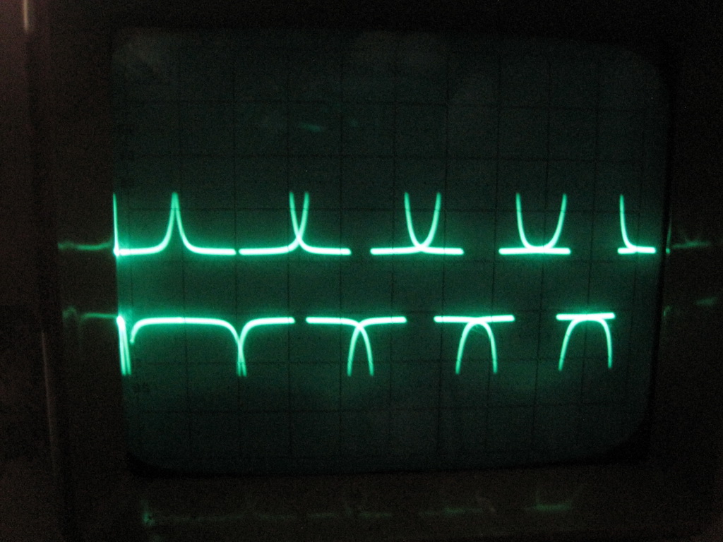

If I use the scope's calibration signal (3Vpp @1khz) I get this on the screen at .2ms horizontal:
The trace is folded over such that the rising portions of the trace are BELOW the falling portions.    Hardly useful!

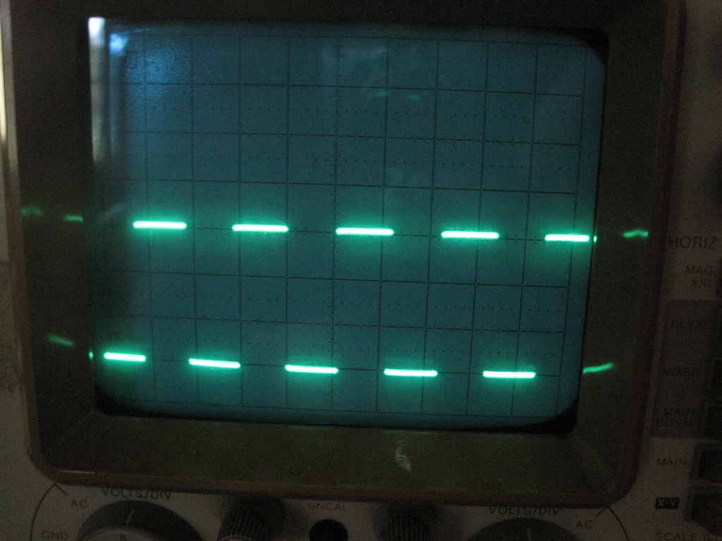

If I change to .1 ms horizontal we get this:
What a mess that is...
Has anyone seen anything like this before?     It does the exact same thing on both the A and B channels.
An interesting data point is changing the sweep to 1 second or slower results in the two split parts of the trace sweeping across the screen and then sweeping back in the other direction at the same intensity.   This behavior is not visible at sweeps faster than 1 second.   Obviously the 1khz signal has no hope of displaying properly at these sweep rates, but I don't think it is supposed to be sweeping backwards!

first trace looks like a "Compensation" error.
Where is the 0V level displayed on the scope in relation to the trace pictured?
What probes are you using to connect to the calibration output, and what settings are on the scope?
You should be using high impedence probes (1Mohm or greater) and DC 1Mohm input on scope. Not 50ohm input.
You should then be able to adjust the probe compensation to get a good square wave without the overshoot.
The second image looks like two traces displayed at once. This is most likely a triggering issue, and you should be able to eliminate the second trace by careful use of the triggering settings. Use "normal" not auto trigger, and adjust the level untill you see a stabilised trace.

The probe is a Tek P6104, 10Mohm
I am using the DC input, timebase at .2ms, normal triggering, sweep mode MAIN.   No other switches pressed on the unit.  Adjusting the compensation on the probe has little/no effect.

With the probe not on the calibration post, there is one bright dot at the far left of the screen.   With it on the post, but not sweeping (i.e., adjust the trigger level so there is no sweep) there are TWO bright dots at the left of the screen.    When I increase the trigger level to cause a sweep, it looks like the pictures in the initial post.
These are the things leading me to believe there is a fault in the unit...

Just take a piece of wire small enough to fit in the center of the BNC connector, stick it in there and touch the other end to the calibration output.  This will allow you to decide if the weirdness is in the scope or the probe.  At 1KHz it will look fine on the scope if the scope is OK.  Of course, if you still see the same thing this won't tell you if the problem is in the calibrator output or the scope input.

The description of the dots when the trace is not triggered is not normal.
This is caused by the gate control circuit not blanking the beam if it hasnt been triggered.
You also described seeing the trace on the return sweep, which should also be blanked, again suggesting problems with the gate control circuit.

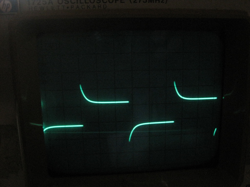

OK I am feeling a bit silly now...   seems the probe is bad, and in fact, has failed completely at this point!    I get nothing on the scope with the probe connected so it now resides in the trash bin.
The image below was made using a lead from a multimeter instead of the probe:
Looks pretty good, with it set to 1 volt per division the deflection is 3 volts under the 0v line as expected and I am seeing the expected number of pulses on the screen at what looks like in the ballpark of the proper width.
EXCEPT!   we now have NO vertical traces.   ugh.
Good news is the double tracing is gone, as is the double dots on the left side.   So I guess that mess was a symptom of the failing probe but seems we may still have a fault in the scope with the missing vertical traces.

They aren't there because the beam is moving to fast in a vertical
direction to leave a trail in the phosphorous.
My 475a looks pretty much the same on a really fast rising signal.
It looks fine to me.  Just crank up the sweep speed and you will be able to see the signal rise (or fall) at some point.
I would agree except increasing the sweep speed has no effect.   Up until the point where a single pulse completely fills the screen there is still no vertical trace.    Increasing the volts per division (less vertical distance for the beam to move) does not help either.
This makes sense if the signal rise and fall is really that fast...
I will assume that the basic fundamentals of the scope are working at this point and focus on cleaning the contacts on the controls since some of them still seem a little noisy.     Will re-visit the troubleshooting if issues remain after that.

Mine's Tek, not HP, but the rise time on my old scope's calibrator signal is on the order of 1 microsecond.  You might need to turn up the intensity quite a bit, too.
