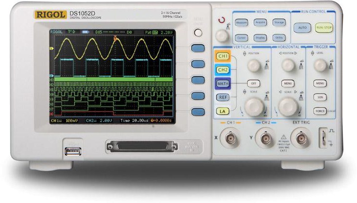

Most low end scopes take measurements from the screen, I can confirm 100% the Rigol 1052e does this.  It does hold to its published accuracy of ~0.4%, see spec sheet for details.  Like typical analog scopes, measurement is most accurate when waveforms fill the screen without overshoot, and you have at least 3-4 cycles on screen.  If you play with amplitude and/or number of cycles, keep auto measurement on, you can watch the measures change dynamically, starting with the LSD of the values.
On the smaller screen of Rigol, you can always turn off menus to get the biggest screen real estate possible, toggling in and out as needed.   You can also pan and scan captured waveforms before and after the trigger point.
The only issues I would find with long term usability in the smaller Rigol screen size is if it were 4 analog channels and/or with digital signals, but I can work with it.  Here's a sample of the screen at its most crowded in the D version of the Rigol.  I think they put the real estate to maximum good use.
As it is, the Rigol 1052e can display 4 waveforms simultaneously, 2 analog, math and a reference waveform.
However, working it is not an issue.  When I need to time a waveform, I view only one channel.  If a need a relationship, I use both analog channels, flip the other one off to measure one channel better.  If I need FFT or math, I view 1 or 2 source channels and FFT to insure all is well, then use FFT alone to get maximum resolution.
The only hardware issues with the scope reported in the past 2+ years are the encoders get dirty with time, act erratically, some knobs crack spontaneously, and rarely folks seem to damage the On/OFF switch knob [ very commonly if you open the case.]  Hellene and others reported much higher base noise than most models.
Firmware 2.05+ have mixed bug reports, depending on which firmware version you have.  Google Rigol problems.  My guess is in an attempt to twart hacking, they've introduced bugs that didn't exist in older firmware versions, so whomever you buy it from insure its easy to return it too.
http://hardcoreforensics.com/blog/2011/01/15/rigol-ds1052e-gash-product/
See eevblog archive posts for photos too.  The only issue I've had is the erratic encoder switch but its not bad enough I'd want to disassemble the unit and clean or replace it as others have, my firmware is 2.04.
