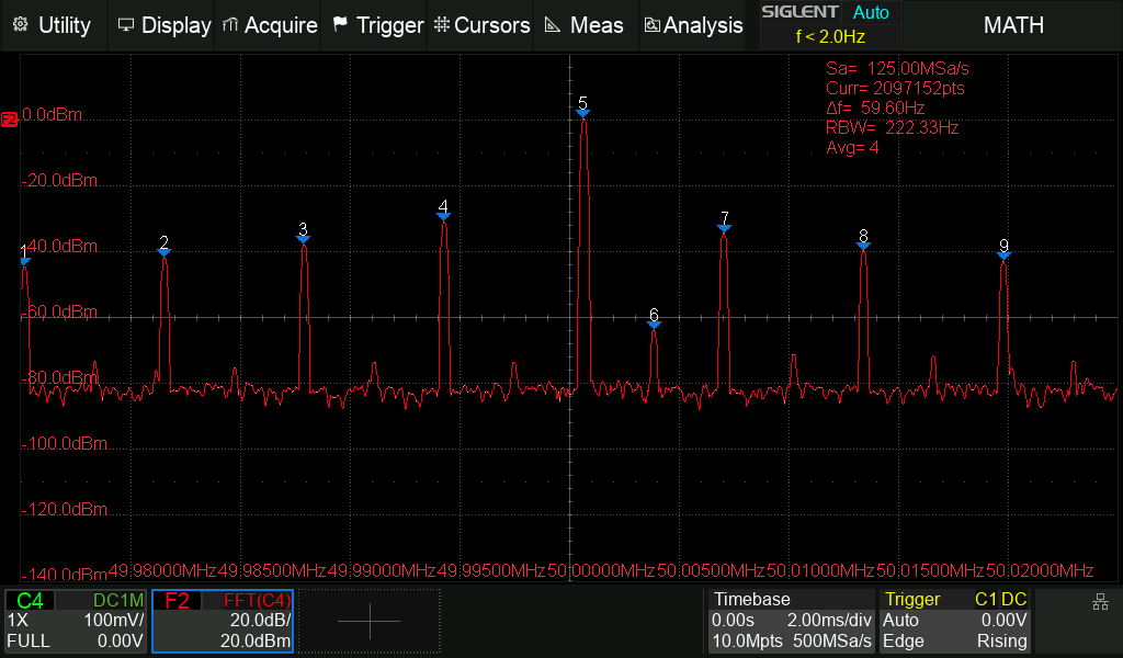

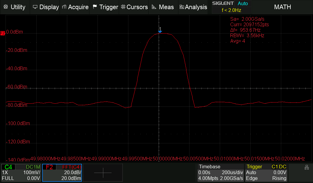

Again 50Mhz 0dBm, Siglent 824X HD, 50Ohm termination.
Span 10khz, so far so clear.
I have combined 2 tracks, the current one is at a vertical setting of 110mV/div (C1), the REF B track(purple) is at 100mV/div.(C1)
Hi Martin,
could you try again with also 50KHz and 1MHz SPAN ?
Here below my results, very same settings :
10KHz SPAN :
50KHz SPAN :
1MHz SPAN :
I would say unusable, in order to eliminate false spurious at this center frequency you have to raise RBW to a much higher value (222Hz ---> 3.56KHz) :
and the whole picture is much less interesting.

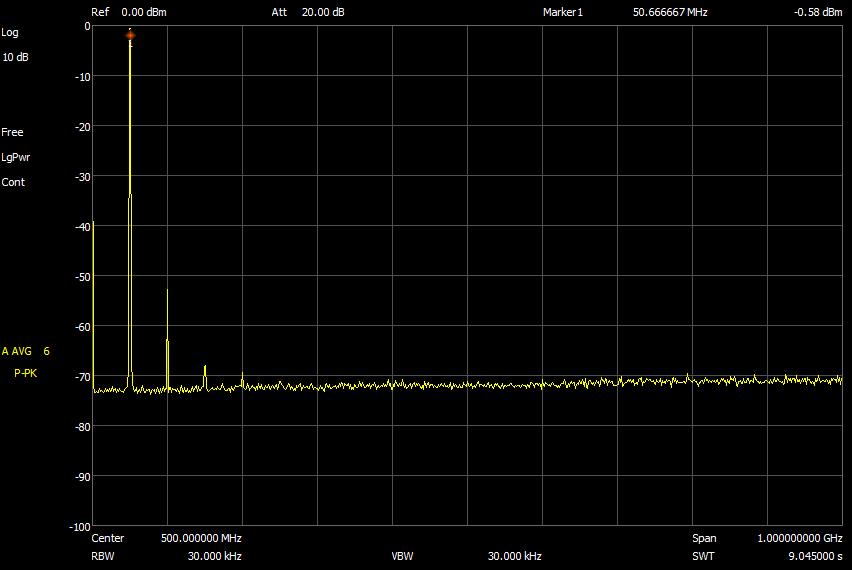

Useless to say, sourced signal is clean with SSA :
where are missing also the small spurious present in 10KHz SPAN spectrum images (your and mine).
I would say that SDS800x FFT is not usable at low RBW (in relation to the central frequency), if you guys can say with certainty that there are no bugs in the FW FFT implementation my interest in this functionality, apart from a few cases at quite low frequencies, ends here.

From these pictures, it appears that this phenomenon occurs when the number of points is >= 10M.
So, potentially an error in the down-sampling to the FFT's 2 MPt maximum?

1MHz SPAN :
* Could you capture 100M samples of this signal at full 2GSa/s sample rate and post the .bin file?
   My feeling is that what you see in the FFT graph is already contained in the samples. I tend not to blame the FFT for that.
* On a larger 0...1GHz span, how do the levels of the harmonics compare between FFT and SA?
* Does a larger V/div (200mV/, 500mV/,...) reduce the amplitude of the close-in spurs (and harmonics)?
Not necessarily an error. If there exist harmonics beyond 75 MHz then it is expected that they will fold into the first Nyquist zone, and if the carrier deviates only slightly from 50 MHz, the folded harmonics can indeed form a comb in the neighborhood the fundamental frequency.
The following users thanked this post: ebastler
Good point. I just tried to reproduce the effect, and indeed it disappears when the incoming signal's frequency is adjusted such that the SDS800X HD sees it as exactly 50 MHz. The scope's time base clock is off by approx. 1..10 ppm -- well within spec of course.

I just tried to reproduce the effect, and indeed it disappears when the incoming signal's frequency is adjusted such that the SDS800X HD sees it as exactly 50 MHz. The scope's time base clock is off by approx. 1 ppm -- well within spec of course.
So do the other instruments, which markone and others compared with, have a better clock accuracy (either due to tighter specs or luck), and hence did not see the folded-back harmonics? And/or do they see less harmonics due to better linearity of the input stage?
Should be easy to verify this on the other scope models, by adjusting the frequency.
Could you also do a FFT with 0...1GHz span at 2GSa/s, in order to see the levels of the first 19 harmonics (w/o folding)?
And if you have a SA, then for comparison the same also on the SA.
The -30dB reading at marker 5 in markone's screenshot is quite a lot. What max. spur level do you see?

Screenshots of the full 1 GHz spectrum and of my recreation of markone's settings are attached. The input signal was nominal 50 MHz from an (upgraded) SDG2042X.
The highest spurious peak in the "folded back" setting is -30 dBm as well, as in markone's measurement. But in the full 1 GHz spectrum, all harmonics are below -50 dBm. What's happening there?

1MHz SPAN :
100MSa are available @ 2GSa/s | 5ms/div, with this setting FFT works up to 25MHz, 50MHz CF is possible up to 2GSa/s | 2ms/div that corresponds to 40MSa, not relevant to you request but it's important to know.
My feeling is that here we have a "beat" phenomenon between ADC sample frequency and input signal frequency, not an expert in FFT math but I guess there are techniques to mitigate it.
Anyway, do you have an application able to dump the whole acquisition buffer ?
It's all up to RBW setting related to CF, any SPAN/CF combination has a RBW thereshold under which the spurious fest start, anyway the SSA provides this spectrum image :
Tried infinite settings, this is definitely not the case.
Those spurious, that of course do not actually exist, appear with many FFT point size settings , as already mentioned to boredom it's all up to RBW setting toward CF value.

« Reply #370 on: May 11, 2024, 01:51:27 pm »
Let's put it simple : the selected RBW values are not working correctly, it's useless to make comparison between utterly wrong spectrum images, if you want to get something similar to reality @ 50MHz CF / 1MHz SPAN, set RBW minimum at 3.36KHz (as I did in the "clean" spectrum that I posted).
I think the discussion has already moved beyond your "selected RBW values not working" and "utterly wrong" statements. gf's observation that the lowered sampling rates which are associated with your long captures (125 MSa/s only in your most recent screenshot!) will result in folded-back harmonics makes good sense to me.
The presence of harmonics can be confirmed with a high-bandwidth FFT, and the foldback effect can be confirmed by carefully tuning the input signal to an exact 50 MHz (as perceived by the scope). Please take a step back and re-read the recent posts.
Online 2N3055
  • Posts: 7467
  • Country: hr
Re: Siglent SDS800X HD Review & Demonstration Thread
« Reply #371 on: May 11, 2024, 02:13:36 pm »
Here is my scope.
same settings, I even tuned the AWG for scope to show 50.00067 MHz so we can see if there are some specific beat frequencies..
Dr. Richard W. Hamming
Offline markone
  • Posts: 730
« Reply #372 on: May 11, 2024, 02:14:04 pm »
You can move beyond what you want, but the sad truth is still "selected RBW values not working" and "utterly wrong"
No need to re-read considerations based on false spectrum readings, because also your "high-bandwidth FFT" is fullfilled with non-existent spurious, if you want to look at the "truth" please make use of a real SSA as I'm doing.

« Reply #373 on: May 11, 2024, 02:14:53 pm »
Here is my scope.
Model of your scope ?
EDIT : please try to set the SPAM to 1MHz just to align settings.
« Last Edit: May 11, 2024, 02:16:43 pm by markone »

« Reply #374 on: May 11, 2024, 02:16:10 pm »
Here is my scope.
What do you mean? SDS824xHD of course. That is one we are discussing here...
