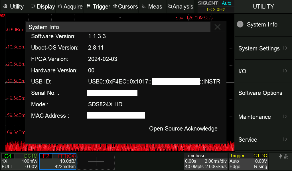

Offline markone
  • Posts: 730
Re: Siglent SDS800X HD Review & Demonstration Thread
« Reply #381 on: May 11, 2024, 02:57:49 pm »
AWG is SDG6052X.
Ok, so for sure you signal is cleaner, do you know second and third hamonics level ?
Do you maybe have an SDG2000X ?
FW version is latest one without public number.
If the problem is not strictly harmonics related it could be that FW guys did some work on FFT math ... I want IT !

Offline Performa01Topic starter
  • Posts: 1729
  • Country: at
« Reply #395 on: May 11, 2024, 05:04:19 pm »
I don't expect the original sample data to reveal the true cause, which is already registered in Siglents internal bug list.
In short: a problem can arise whenever the FFT sample rate is not equal to the acquisition sample rate. There seems to be an exception for the 1:2 ratio.
In this particular test case, you can try using constant sample rate of 250 MSa/s and then, with 5 Mpts record length, the FFT will use 125 MSa/s, resulting in the smallest possible RBW at 50 MHz, without excessive spurious signals:
SDS824X HD_FFT_C50M_S1M_Sa250_125
