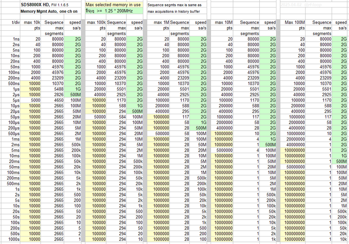

Has anyone else experienced acquisition memory limitations on the SDS824X HD with firmware version 1.1.6.5? When set to 10kpts, it drops to 5kpts at 5us/div, and the 100Mpts memory depth is only available for acquisition times of 5, 10, and 20ms/div. For other timebases, the available acquisition memory decreases. Is this an intentional limitation or a firmware bug? Thanks for any feedback!
Your scope is sampling at 100Mpt/s?
It is simple math.
If you are sampling at 100e6 point per second, how many points you get in 50µs (50e-6) worth of time?
It is simple math.
5,000 points are obtained in 50μs at a rate of 100MSa/s
But the oscilloscope I know only has 1200 points per refresh
With memory management auto and one channel on, here can see how it use memory and use samplerate depending what maximum memory user have selected and what time base (t/div) is in use.
It works just as it is designed.
Yes there is some kind of exception if look this table. When step t/div down and samplerate drop after 500MSa/s it do not drop to 200MSa/s  but it drop to 100MSa/s  and because this, also memory need then reduce half for this step. Next step down in t/div speed do not drop samplerate, it stay 100MSa/s but it increase memory back to max selected.
Naturally when two or three and four channels are in use then many of these numbers are different. This table is just only for what ever one channel is in use alone.
« Last Edit: August 04, 2025, 02:56:31 pm by rf-loop »
Thank you!
The attached Excel calculation is correct or not?

There is something wrong with the acquisitions anyway. If you decrease the mem depth, then the trigger rate drops significantly, even in segment mode.
