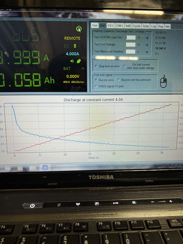

I am using a Digitus DA-70156 USB 2.0 to Serial (FTDI/FT232RL) on Win 10 with no issues from ASSMANN Electronic GmbH 8,67 EUR + Shipping on Amazon.
Scoping Kunkin KP184 serial communication with the stock National Instruments based light application I noticed there are a lot more register addresses available than the ones listed on the product manual.
The manual states on page 14:
If you need more specific information about communication protocol, please contact the technical support department of our company to get it.
I sent an email to sales@kunkin.cn but it could not be delivered.
Does anyone have this complete protocol information?
Does anyone have an open English speaking channel with Kunkin to ask for more information?

New software written in Python for Kunkin KP184 V1.0.1.0:
Setup KP184 Software V1.0.64.0
User_Manual
« Last Edit: February 14, 2024, 08:05:46 pm by interflexo »

New version 1.0.2.0:
Capacity (Ah)/Energy (Wh) calculations error fix.
Minor bug fixes.
New software CVL mode with current limiting capability. Operates Kunkin in CC mode and a PID configurable control loop holds the configured CV setting by permanently adjusting the CC load.
User Manual updated.

New version 1.0.3.0:
1. Plot graphs are now placed on the same directory as the configured .csv file.
2. A matching “.png” plot graph image file is also added to the same output directory for easier document insertion.

New version 1.0.4.0:
1. Fixed an issue with the battery capacity test max duration
2. A new log tab allows the user to keep a track record of the current session activities and results. Events like over temperature, over power and over current are also logged as well as its recoveries. Right click on the text widget and select “Copy to clipboard” to export the complete log in
text format.

New KP184 Software Version 1.0.5.0:
Changes:
1. Fixed some data logging hiccups during application main window drag
2. Fixed graph y-label slightly clipped
3. Several support modules were updated in the Python ecosystem.
User_Manual
Just use the new .EXE file over your previous v1.0.4.0 installation to preserve your configuration.

New KP184 Software Version 1.0.6.0:
Changes:
1. Added some thread locks around logged data handling
2. Several support modules were updated in the Python ecosystem.
User_Manual
A user reported some documented problems in logged time on a iMAC I5 from 2015 running Windows 10.
In spite of my best efforts I could not replicate the described problems using a Lenovo Thinkpad T520 I5 2,5Ghz 8Gb RAM running Windows 10 Pro 64 bits.
Nevertheless I examined the code and added some thread locks around logged data handling, compiled a new build (v1.0.6.0) and put it through a 2 hour hell burn in test - battery discharge test data log with continuous cycle of simultaneous write (from within application) of more than 200 csv files without any problems.
Any feedback would be much appreciated.

Before pressing the Load Switch icon you switch to the "Log" tab to watch the log lines in real time an inspect how Kunkin is being commanded.
The following users thanked this post: CyberWalker, F64098

New KP184 Modbus Software Version 1.0.29.0:
Changes:
1. New solar panel test mode (SOL) added. A user defined CV sweep mode records de solar panel characteristic I-V curve and MPP data for device diagnostic or manufacturer specifications comparison.
2. The data acquisition report button now handles both report types (battery capacity discharge test and solar panel test) according to the last test mode.
3. Correction on the non static programmable profile cycle (CYC) load mode startup.
4. Some settings were not available on the configuration dialog window.

A couple of videos explaining operation with KP184 Modbus Software:
« Last Edit: November 29, 2021, 11:23:34 pm by interflexo »
