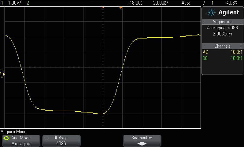

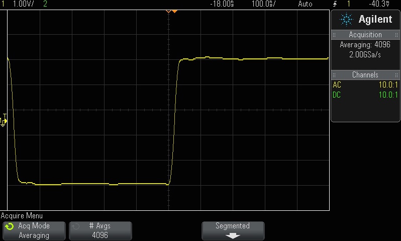

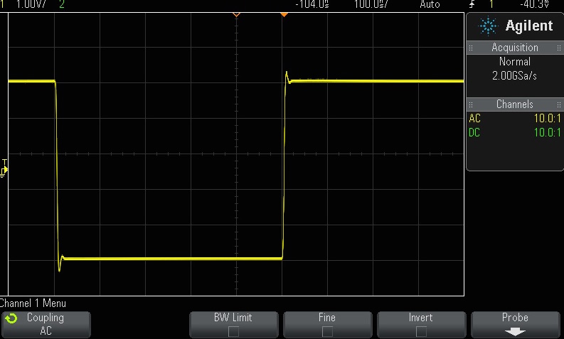

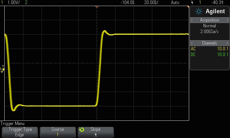

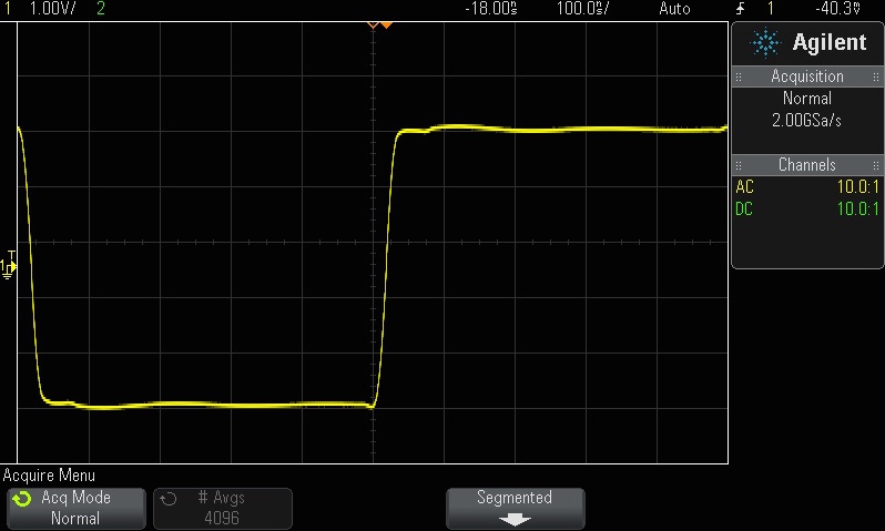

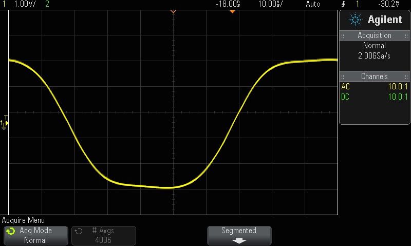

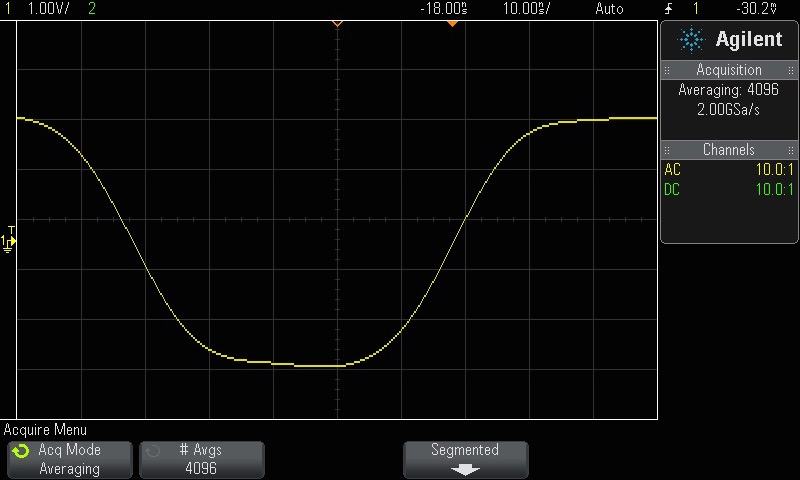

I have the results from two generators. One is a GW Instek SFG-2110 (10MHz bandwidth). The second will the from the built in wavegen function of my Agilent DSO-X 2002A (10MHz bandwidth).
First up: GW Instek SFG-2110
1MHz
5MHz, jitter is starting to creep in.
5MHz, with averaging switched on.
10MHz, at full chat now and jitter is quite bad.
10MHz, with averaging.
Next up is the DSO-X 2002A built in wavegen option. This seems to have better jitter performance, but not as good with the high frequency harmonics.
1MHz
1MHz with averaging
5MHz
5MHz with averaging
10MHz, full chat. I checked and it is still supposed to be outputting a square wave.
10MHz with averaging
