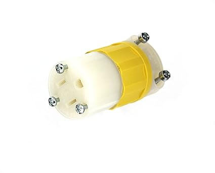

As I was constructing a new power cord for my Agilent 6675A 120V/18A power supply, I came to the horrid realization that the pre-made cables you can buy on eBay and Amazon are pure crap. I wanted to have a 12/3 portable cord (SJTOOW or STOOW) with a quality NEMA 6-15P or NEMA 6-20P plug on it (e.g., Leviton or Hubbell). I couldn't find anything of the sort, just cheap Chinese made crap with molded on connectors catering to the "buy at the lowest possible price" crowd.
Then I started to shop around for 6-15/6-20 extension cords. Once again I ran across the same crap with 14/3 (or 12/3 if you got lucky) crap cables connected to even crappier male/female molded-on connectors. Quality was nowhere to be found, no matter where I looked. Everything was made to the cheapest price point and then sold for ridiculous prices, leading me to the following conclusion:
If you want a quality cable with quality connectors, you have no choice but to construct one yourself.
Am I crazy in this desire for a quality cable with quality connectors or do others share my opinion?

What I expect for my minimal value 5-15 terminated crap cable (i.e., extension cord):
Plug end:
Connector end:
In between, decent 12/3 cable, e.g.:
What I don't want is 16/18 AWG crap with molded connectors in black, orange, yellow, blue or green. Made in China by the hundreds of millions (billions?) for under $1 USD each, then sold on Amazon in 6-10 ft length for $11-$19, I kid you not:

The SharpEars checklist for "quality power cable." All of the following must be true for it to be regarded as a good cable:
  • You cut at least one finger trying to strip the jacket off of the cable with a razor blade or a box cutter due to the toughness of the insulation. Bonus points if the cut required stitches and a visit to the ER.
  • Your Irwin VISE-GRIP Self-Adjusting wire stripper can't get the insulation off of even one of the three (12 AWG or larger) wires inside, no matter how many times or at what angles you try. It can't even score the insulation - all it does is stretch it.
  • When you finally resort to using large diagonal cutters to get that darn insulation off of the individual wires, at least one of them loses a copper strand due to you cutting too deep with the cutters into and through its insulation. All is well though, because its just one strand out of the thirty or more in the wire.

So what you want is expensive rubber cable with expensive connectors which can't be fitted by automated tooling.
Yes, you will have to make that yourself.

Of course you're not going to find an industrial cord from consumer suppliers!  What did you think?  And of course you're going to build one - just like everyone else has to build one for that ampacity rating.  It only takes a few minutes, so I don't see what the big deal is.  Just go to your local electrical supply house, buy it, and be done with it.  I'm even able to find decent connectors at Home Depot these days.  The new connectors are so easy to terminate, a rhesus monkey could do it.
And if you're having that much trouble stripping the jacket off, you're not doing it right.  Bend the cable where you want to cut, then just touch it lightly with the blade.  The jacket will split nicely without harming the wire insulation underneath.  Do that around the circumference, then peel off the jacket.  You may need to do a length-ways slice if you're stripping off a long piece.
Your wire stripper is dull.  Throw that one out and get a proper one from Ideal.  I think you can get them up to 10 ga or 8 ga.  If you're stripping with dikes, you're almost certainly breaking the strands in the process.

This is what I use for nearly everything save for Romex:
http://www.idealind.com/prodDetail.do?prodId=stripmaster_wire_stripper&div=3&l1=wire_strippers
Two sizes will cover nearly every type of wire you will run into, save for 1/0, coax, etc....  They're $45 each on Amazon and worth it.

You're alone.  Save for ampacity requirements like your 20A situation, I hack the $3 pre-molded IEC cables all the time and have had I think one bad cable over many years.  The cables may be from China, but are largely safe and reliable.

Thanks for that! I just bought the #8-#12 wire version from Amazon. Let's see how it works out on the 12/3 and 10/3 I need to strip.
