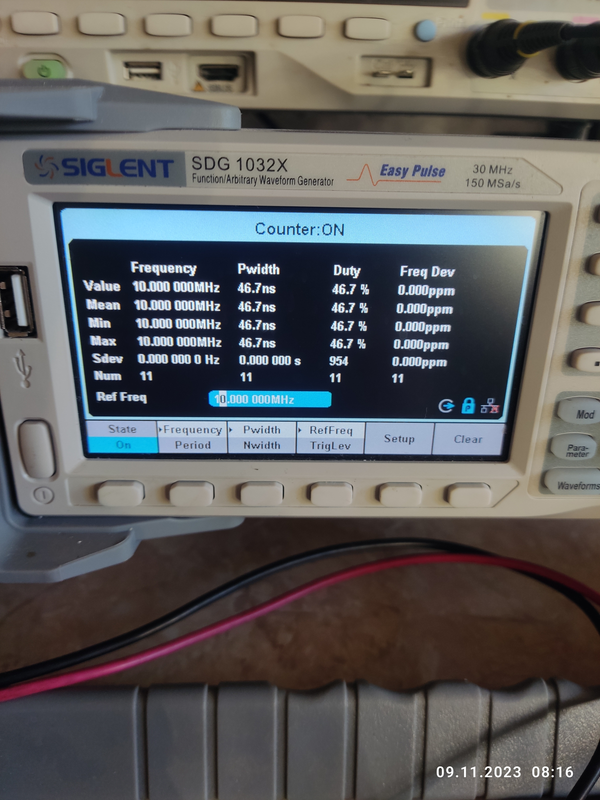

« Reply #11 on: November 09, 2023, 06:31:08 am »
Nothing special with the frequency counter:
