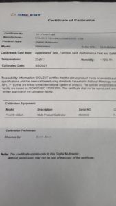

Form Siglent:
I had a chance to take a look at your SDM3065X today and I put it on the calibration stand and it passed the DC performance verification. I know you had some measured values that also showed it was out of calibration, 6 - 15 mv on several ranges, so I also tested it with our Keysight B2901A PSU. All of the test equipment in our lab has been calibrated within the last year. I measured at the same values you did, 5, 10, 20, 30, 40, 50, 60 V on both the SDM3065x and our HP3458A 8.5 digit multimeter. I noticed that if I did not add the accuracy of the Keysight B2901A into my calculations the SDM3065X and the HP3458A would seem out of calibration. So I think this is where the problem is. You have to add the accuracy specification from the PSU you are using. This will then give you an accurate measurement.
I am planning on sending your unit back next week.
So they are saying that the 3 meters I compared it to are not accurate and all have the same error?

The response is a little odd: if you use a supply and than compare the reading from 2 meters (e.g.  DUT and 3458), there is usually no need to include the accuracy of the supply. At least this would not the normal accuracy, but only the stability for the time between the 2 readings, reduced by possible repititions.
There could still be a little tricky point. There could be some superimposed noise or ripple, that may effect both meters different. With a meter like the 3458 there is also some possible disturbance from auto zero switching. It is supposed to be not very large, but hard to tell how sensitive the supply reacts to this.
So they kind of confirm the meter is no in cal if the KSB2901A accuracy is not included (which is usually correct !).

You should ask for their accuracy verification report showing how it meets spec on P14 of the service manual:
https://siglentna.com/wp-content/uploads/dlm_uploads/2019/05/SDM3065X_ServiceManual_SM06036-E02F.pdf

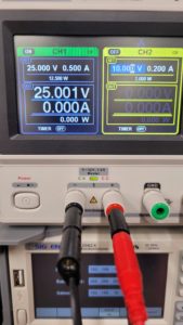

Power source is a Siglent SPD3303.

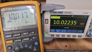

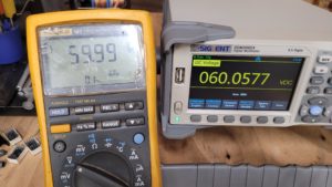

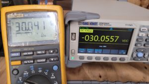

« Reply #25 on: August 03, 2021, 05:09:30 am »

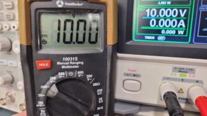

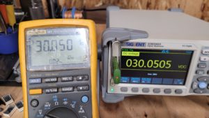

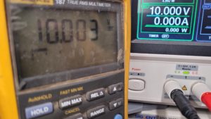

I e-mailed Siglent the questions about the accuracy verification report and if the 3065X and The HP3458A agreed if hooked in parallel over the weekend have not received a response.
I have some photos of the 3065X hooked in parallel with my fluke. (I Did not take many but enough for my documentation)
Cold and off For 1 Hour or So Right After Firmware Update. The fluke and SDM3065X Almost Agree.
After an Hour or So. (The Error Kept Drifting Up on the Siglent) even with a shutdown and restart after an hour the error would be small but increase over time.
30V I know the Polarity on the silent is reversed but did the same the other way around.
10V
60V
« Last Edit: August 03, 2021, 05:38:01 am by KG7AMV »

So you're saying the error increases with power on time even after the meter is power cycled warm?  And even a short power cycle will reset or greatly reduce the error?  If the Siglent tech wasn't aware of this, perhaps the meter could pass a performance check cold?  The first photo shows no error, and the second, assuming the PSU drifted down and the Fluke 187 is more or less correct, an error of 500ppm, which is only possible if at least one of the meters is out of spec.  However, unless you subject the Fluke 187 to a similar hours-long test with a presumed good meter, I'm not sure how you can convince anyone that the Siglent is the one that is faulty.
Offline KG7AMVTopic starter

« Reply #27 on: August 03, 2021, 05:41:41 am »
Short power cycle had no change.
Yes, i told siglent this went back 1 firmware revision the error was less. That is how I discovered that when you upgrade the firmware it agrees with the PSU Output and the Fluke.
Even if you shut the meters off for an hour and turned turned them back on the error would be present only time they would agree would be upon a firmware update and just for a few min.
Both meters were on and off the same amount of time.
The output displayed on the PSU agrees with the Fluke when psu is on for 30 or so min will read flat 10.000 on the fluke.
Generic
I am sure if I had the Siglent in parallel it would have read 10.053 or higher.
« Last Edit: August 03, 2021, 06:21:49 am by KG7AMV »
Offline bdunham7
  • Posts: 8004
Re: Siglent SDM3065X Issues? RMA Time?
« Reply #28 on: August 03, 2021, 05:50:18 am »
The output displayed on the PSU agreed with the Fluke.
So if I was trying to look at the temperature coefficient and power-on stabilization time for a meter, I'd connect two meters and a PSU in parallel, like you have.  Then I'd leave the PSU and the known-good meter on overnight to let them completely stabilize, then turn on the test meter in the morning to see how it behaves.  If you turn them all on at the same time, its hard to know which one is doing what.  Your 187 and PSU are probably right, but that is a hard case to make when both of them are so much less precise (on paper) than the 6.5 digit DMM.  Hopefully Siglent can respond in a way that is convincing one way or another.
 :o

Got a Siglent Reply..
As I mentioned in the first email I put your SDM3065X on the Fluke 5522A Mulit Purpose Calibrator and tested it and it passed all of the DC voltage performance verification. This alone is enough for us to verify your SDM3065X is within specification.
Then knowing you performed your tests without a Fluke 5522A I used our calibrated equipment to run the tests again using the accuracy specs for instrument in the test. All the equipment used here for testing has been calibrated within the last year. Here is my process of testing.
First I calculated the B2901A Accuracy from data sheet (% reading + offset) ±200 V range - ±(0.015 + 50 mV). Then I set the B2901A at 30 V and based on the setpoint accuracy the true ouput range will be between 30.0545 and 29.9455.
Here is my math.
30  * .00015 = .0045; .0045 + 50 mV = 54.5 mV; 30 + .0545 = 30.0545; 30 - .0545 = 29.9455; range is between 30.0545 and 29.9455
Then I took the SDM3065X data sheet on 200 V range specification which reads DC Voltage Accuracy±(% of Reading + % of Range) 0.0050 + 0.0005.
Here is my math.
Example measurement was 30 V on 200 V range – taking my B2901A source accuracy range which is between 30.0545 and 29.9455 I added and minused to get the measurement range.
30.0545 * .00005 = .00150272; 30.0545 * .000005 = .00015027; 30.0545 + .00150272 + .00015027 = 30.056153
29.945 * .00005 = .00149725; 29.945 * .000005 = .00014972; 29.945 - .00149725 - .00014972 = 29.943353
The measurement range is between 30.056153 and 29.943353.
The picture I have included shows your SDM3065X measuring the B2901A @ 30 V. It measured 30.0085. Which if you see the measurement range is between 30.056153 and 29.943353 so your SDM3065X is well within specification.
« Last Edit: August 03, 2021, 08:32:00 pm by KG7AMV »

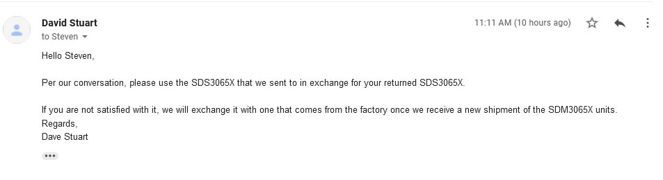

I just got off the phone with Dave the GM at Singlet I explained to him whats going on.
They will be sending me a new replacement.
The following users thanked this post: egonotto, 2N3055, mawyatt

Broken meter was his claim based on fact that cold it agrees with 20 year old, never calibrated Fluke 187. That is no verification for all the reasons explained. As far as I know it could have been Fluke drifting..
You are correct about temperature coefficient, I did misread,  it is outside 18-28°C, unlike what I understood. I made a mistake there. Corrected calculations are:
   At calibrated temperature                        What can it really be:
         Accuracy   .          .   .   Measured   .          Min              Max             P-P error
      .   0,0300%    +   0,003   .   30,04100E+0   .   30,02899E+0   30,05301E+0   24,02460E-3
   .   .   0,0300%    +   0,003   .   10,01700E+0   .   10,01099E+0   10,02301E+0   12,01020E-3
   .   .   0,0300%    +   0,003   .   59,99000E+0   .   59,96900E+0   60,01100E+0   41,99400E-3
So my calculations for the tempco were very much off. I apologize for that.
But still, basic errors for F197 are in the order 12-44mV P-P for measured values. Providing it is perfect. Which there is no reason to believe it has to be.
They also said that SDM3065X and 3458A agreed between themselves while measuring B2901A. Rest is trying to explain how large errors can be if you only use B2901A as reference .. It is written a bit confused..
Anyways, I'm not saying meter was perfect. I cannot know that, short of testing it myself.
But whole thing went about kinda wrong way.
If I buy two meters: Keysight 34465 and SDM3065X, connected them in parallel, and they differ 20 mV while measuring 30V, which one do you send back ?
Even in that case proper answer is you verify both. You might say that Keysight might be less likely to be wrong (years of experience etc..) but that is wrong. If error between those two instruments is so large, there must have been some damage in transport or something like that. Those can happen to any vendor.
But if you take 60000 count meter that is very old and never calibrated, you can maybe start suspecting that your brand new SDM3065X is not doing well, but you cannot be sure which one is wrong.
Would you be so eager to say the same it if it was Uni-T 60000 count meter.. I personally have experience those are very accurate, albeit bad mechanical quality so they start falling apart after some time... But as long as they are new they are very accurate.
So yes, OP could have suspect something was not OK with his new SDM3065X, but I would try to compare it at least with another 5.5 digit meter (that one could have been good enough to verify such a large claimed error). Fluke 187 is only good enough to rise suspicion and prompt an additional action.
But good news is that OP will get a replacement one, just to make sure this is solved for him in satisfactory manner. That is all that matters. And that is, after all the effort, good support.
This indicates to me Siglent did the right thing for the customer, and what one would expect from them. Sure it took a little effort but in the end they supported the customer, so hats off to Dave and Siglent :-+

bdunham7,
I will for sure be doing the same checks with the new replacement when it arrives and will post results.
mawyatt,
Yea, Dave handled it well he said it would ship tomorrow 08/05 or the next day.
I just checked their site it is showing (1 week lead time) so I will just have to wait and see if thats the case.

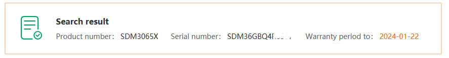

Receive a package today, it seems like they ship old stock.
Per Siglent Site: https://int.siglent.com/account.php?module=warranties
The one I sent in had a Warranty expire date of 01/22/2024
The Replacement has a Warranty Date of 10/28/2023
I know I am splitting hairs here but time is time! Right now will keep it boxed up!
It doesn't surprise me that SiglentNA would have slightly older stock then Amazon.  The have to travel by boat, so those units may have arrived more recently than you think given the state of global shipping lately.  Anyhow, I'm pretty sure they start the warranty from the purchase date and those dates are just there as the default if you don't have the receipt.  You can clarify with SiglentNA, but I'm pretty sure your warranty and cal are OK and you should just unbox it.
Splitting entirely the wrong hairs too !
Siglent's factory warranty conditions DONT apply in the US. Period !
Where instead US warranty is from proven date of sale.
https://siglentna.com/service-and-support/warranty-information/

I have very little trust these days with company's especially with ones as young as singlet and the prior customer service I received. The first after sale service interactions crossed off to many of the never do or say to a customer items fermenting the distrust.
What I did not mention publicly was that the box had already been opened and resealed! I was Awaiting the Reply from Siglent which I receive this morning.
On the call this morning From David.
He explained they only have "old stock" they all have expired cal-certs after 6 mo on the shelf and they have to open them and check the calibration on them prior to shipping reason the 1 week lead time. He understood my concerns of an open box (I was worried I receive B stock or another customer return). He told me that all they did is check calibration units was not a return  / refurbished etc. (He understood my concern about the calibration procedure and explanation on the returned one) He wrote me an e-mail reassuring me if I am not happy (even being old stock) just use it and they would replace with an unopened current stock when it arrives.  That was good enough for me!
Have a Coffee or two!! Grab the blade and carefully open the box. There is an envelope containing a Cal Cert Dated 08/05/21 Scott Rocco
I fire up the PSU and the DC Load and Let it warm up! Plug in the 3065X power it up let it burn in a bit go about my day.
Many Hours Later!
I hook up the Fluke, DC Load, and 3065X In Parallel and Proceeded to check volts up and down. See if they Agree!!
Side Note: The Siglent PSU is 3.5 years old and was calibrated using the procedures in the SPD3303 service manual with a friends Keysight EDU34450A. I hope I can talk him in to bring it back down with him one day.
The big moment do they agree after a few hours? I checked 1v to 60V. Here is 25V!
Fluke and SDM3065X
Siglent DC Load a Little disagreement but acceptable. (Leads are shorter to the DC Load)
So Why is it that this 3065X agree's with the PSU, Fluke, and DC Load and the other one did not? This one seems to be stable also after a few hours will keep it on for (week) 168 hours and recheck.

« Reply #71 on: August 20, 2021, 08:13:28 am »
Obviously the other one was broken.  It would be interesting to figure out what the exact issue was with it, but I guess we'll be deprived of that particular learning experience.  At first glance it might appear to be a tempco issue, but I actually think it is more likely to be an issue with some sort of tempco compensation scheme and related stored values, as Kleinstein suggested earlier.  I think a the undocumented (publicly at least) nature of many modern instruments is a huge drawback.  We aren't likely to ever know exactly how this system works.
David is very reasonable person and listens to logic. If you ever need assistance from Siglent talk to David. Scott in my opinion need a lesson big in customer service (pink slip type) I have other words I could use but will not express them publicly.
Frustration at this sort of debacle is understandable, but I'm jaded enough to actually prefer an honest but wrong opinion to carefully rehearsed PR bullshit.  The tech in question tried an experiment to try and confirm or refute your assertion of a defect, apparently got the concepts wrong and I suppose things went downhill from there.  Perhaps he felt strongly that he was right--it's not uncommon for support people to think that their customers are idiots because often times they are.  That's why I predicted that things might get ugly--and I'm glad to hear that everything was quickly resolved, although not perhaps at a technical level or for technical reasons.
And for those that doubted the F187, don't ever bet against ancient Fluke or HP meters, even if they have tire tracks on them.   :)

It would be nice to know why Serial # SDM36GBQ4R0577 was that far off and drifted with time. I was going to post the SN earlier then deleted.  I figure the SN should be public just in case it's resold as a factory second / refurbished unit and someone has the same issues with it they may find this post.
