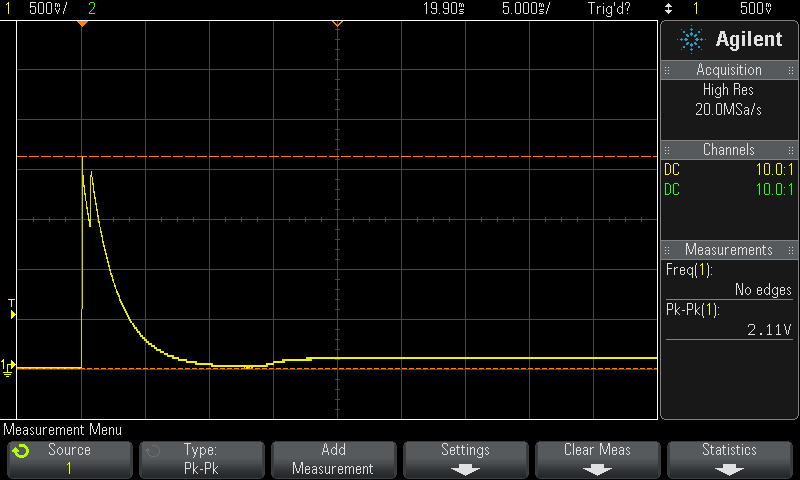

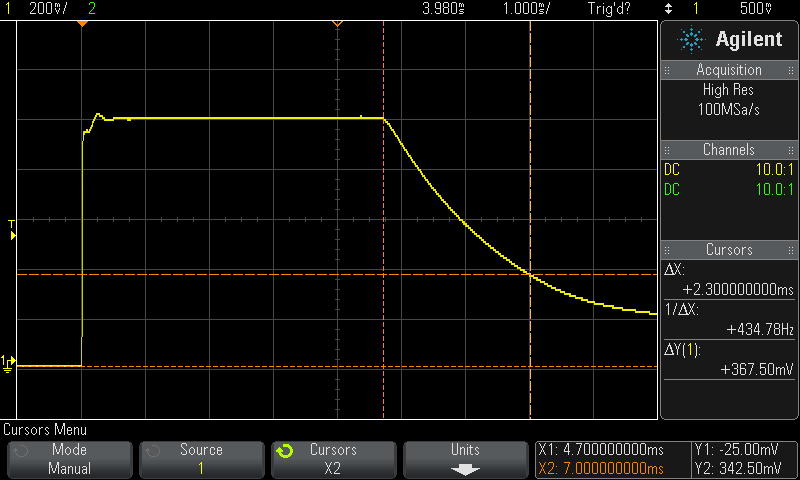

Does anyone know what the output capacitance of this supply is?
The Rigol DP832 has 1000uf directly across the output, which seems to me like it could defeat the usefulness of the current limit in some cases. The Korad programmable thing has 330uf. I was wondering what this one had.
Thanks
  • Posts: 2375
    • Frank Buss
Re: Siglent SPD3303D review
« Reply #82 on: November 22, 2014, 03:30:28 am »
That's an interesting question. I measured it:
Test setup: Channel 1 on, current limit set to 10 mA with "fine" adjustment, voltage to 1 V. Then I connected a scope to a 10 ohm resistor and then the resistor leads to the power supply output while it was on. As you can see, it needs 2.3 ms to discharge to 37%, so with t=RC <=> C=t/R I think the output capacitor is 230 uF.
But the interesting part is the 4.7 ms delay before we can see the current limitation. So I tested it with 100 ohm and 5 V output voltage:
For 40 ms twice the selected output current is not good.
This made me wonder what happens if you turn on the channel with load, when it should go to CC mode immediatly. New test setup: 10 ohm and scope connected to the channel 1 output, channel 1 is turned off, current limit set to 10 mA. Then I turn on channel 1:
As you can see, it starts with 2 V, which means for the first millisecond there is a current of 200 mA instead of 10 mA. And after 10 ms the output voltage drops down to nearly 0 V, then rising again to the expected 0.1 V for the CC mode. Same problem for 100 mA current limit, it starts with 200 mA. But I guess no problem for most circuits, even a low current fast fuse would not blow in a millisecond.
But it is worse with 1 ohm (screwed to the power supply output terminals) and 100 mA current limit, output voltage set to 10 V:
Within the first few microseconds there is a peak of 3.2 A, the maximum output of the power supply, 32 times the selected limit. Again, it is too short to harm most DUTs, so I can live with that, but looks like there is room for improvement for Siglent how to implement the current limitation.
