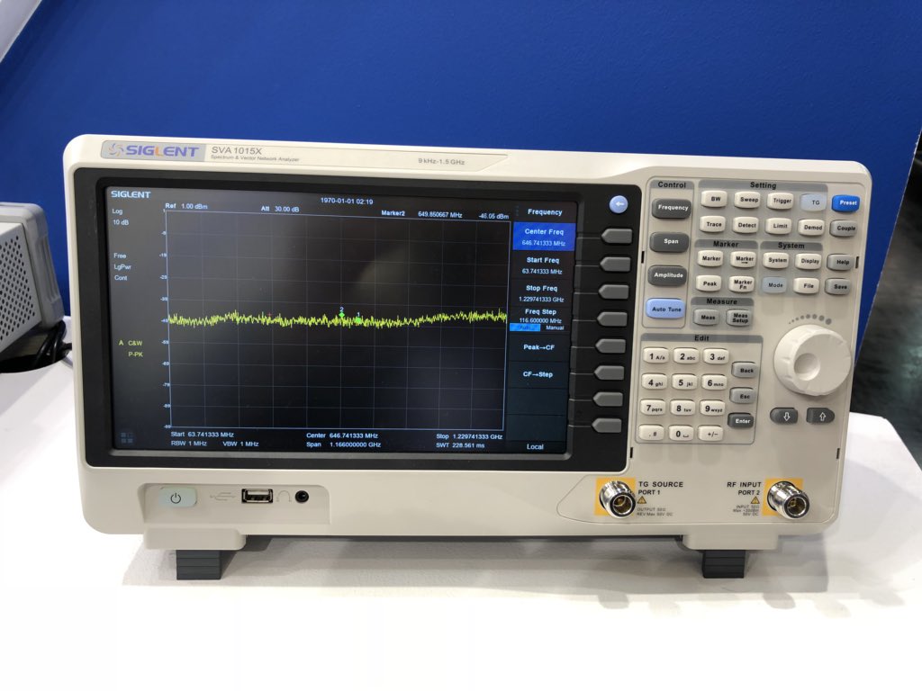

"The new SIGLENT SVA1015X helps minimize test time by combining a swept superheterodyne spectrum analyzer with a two port VNA. The available Distance to Fault, EMI, and complex impedance measurement options..."
"...improved UI with new touch screen, mouse, and keyboard support."

Offline Dubbie
  • Posts: 1115
Siglent SVA1015X 1.5GHz Spectrum & Vector Network Analyzer (Coming)
« Reply #3 on: March 09, 2018, 09:50:04 am »
1.5Ghz seems rather low for a VNA these days.
Is there a 3.2 and or 6Ghz version as well?

Offline PA0PBZ
  • Posts: 5259
Re: Siglent SVA1015X 1.5GHz Spectrum & Vector Network Analyzer (Coming)
« Reply #6 on: March 09, 2018, 12:46:56 pm »
(Seems the picture was posted on Twitter, withou blurr)
There:
« Last Edit: March 09, 2018, 12:49:00 pm by PA0PBZ »

Offline simone.pignatti
  • Posts: 384
« Reply #8 on: March 09, 2018, 06:47:09 pm »
HEY those images are from our twitter account! Where is the credit!
I took them at Embedded World 2018 in Nuremberg (DE)
https://twitter.com/BatterFlySrl/status/969967096951132160
https://twitter.com/BatterFlySrl/status/968819477646381057
  • Posts: 384
« Reply #11 on: March 09, 2018, 07:57:30 pm »
I would say similar to SSA3000X
btw the SVA has a 10.1" touch screen display

Offline PA4TIM
  • Posts: 1164
« Reply #12 on: March 09, 2018, 08:16:32 pm »
Wow, it looks very modern for a thing made in 1970 , or is it a bug in the firmware  >:D
Offline rf-loopTopic starter
  • Posts: 4135
  • Country: cn
« Reply #13 on: March 09, 2018, 09:57:32 pm »
1.1.1970 is UNIX "epoch time" - (and its little cousin linusnix).
We also remember this old method for modify SSA3000X using this "epoch time" trick.
Offline hendorog
  • Posts: 1635
« Reply #14 on: March 09, 2018, 11:53:56 pm »
Looking at the port labels I am guessing that it will need an external coupler for S11 measurements...?
Offline TheSteve
  • Posts: 3785
  • Living the Dream
« Reply #15 on: March 09, 2018, 11:58:13 pm »
Ouch, hopefully the labeling is just incorrect, otherwise it is awful lame and better be crazy cheap. Pretty hard to call it a two port analyzer.
« Last Edit: March 10, 2018, 12:00:09 am by TheSteve »
VE7FM
Offline Bud
  • Posts: 7276
« Reply #16 on: March 10, 2018, 12:01:28 am »
Apparently the Chinese know a way to do it without one.  But my bet is they have no idea how to do it at all.
Offline hendorog
  • Posts: 1635
« Reply #17 on: March 10, 2018, 12:15:34 am »
Actually it isn't really a bad decision for a combo device, as you can buy what you need. Also they already have a coupler for the SA range.
But _if_ it is the case there will be quite a bit of port swapping needed.
Offline orin
  • Posts: 445
« Reply #18 on: March 10, 2018, 01:11:30 am »
You don't need a system that uses an external coupler to measure S11.  The DG8SAQ VNWA is a two port vector network analyzer that will measure S11 up to 1.3GHz and it uses a resistive bridge internally.
The difficult part is the phase of S11 (or indeed of any S-parameter they are measuring) - how do they compare the phase of the reflected signal with that of their source signal?
Offline hendorog
  • Posts: 1635
« Reply #19 on: March 10, 2018, 01:30:12 am »
Yes, I meant coupler or bridge.
It can also be done with a circulator or even a splitter. Circulators are normally not wide band, but  there is a older solid state design that Charles Wenzel has published for low frequencies and low power. It would be interesting to see how high in frequency that could operate using the fastest op-amps available now.
The phase comparison part is not difficult. Internally there would be a second, reference, detector which is fed with a portion of the TG signal. The detectors are just mixers and ADC's. The some maths in the FPGA and bobs your uncle.
Offline KE5FX
  • Posts: 2096
    • KE5FX.COM
« Reply #20 on: March 10, 2018, 02:01:15 am »
It probably has only two receiver channels internally instead of three or four.  They may have a single directional coupler (more likely a resistive bridge) on the main port to support S11 measurements, and a conventional non-directional ALC sampler on the TG port.  S21 measurements would be scalar only, implemented by treating the tracking generator output as a transmit-only "port 2."
Not necessarily a bad way to go, at the right price.  But it limits your calibration options.  It had better be cheap... very cheap.
Offline Neganur
  • Posts: 1173
« Reply #21 on: March 10, 2018, 03:44:45 pm »
You don't need 4 or two receivers to measure S21 - one is enough, and also phase can easily be measured with just one receiver if you compare the received phase to the phase at the TG output.
Implement a switching matrix (e.g. four RF SPDT switches) to change the DUT direction and then just have another switch path to select for reflection and transmission + the math.
Very crude compared to modern stuff but sure it works.
The following users thanked this post: hendorog
Online nctnico
  • Posts: 28429
    • NCT Developments
« Reply #22 on: March 10, 2018, 03:58:04 pm »
That is assuming the DUT doesn't affect the phase and amplitude of the TG. AFAIK most DUTs will affect the amplitude and phase of the TG so you'll need to measure the TG output while it is loaded by the DUT.
Offline Neganur
  • Posts: 1173
« Reply #23 on: March 10, 2018, 04:21:53 pm »
Could you elaborate how you think the phase is being affected and how is this relevant if you are comparing the phase at the input to the output?
It’s a relative measurement after all.
  • Posts: 384
« Reply #24 on: March 10, 2018, 04:50:13 pm »
I have few more images about it which show the different mode. The unit was not connected to a signal or component. Would you like me to post them?
Technical Support
