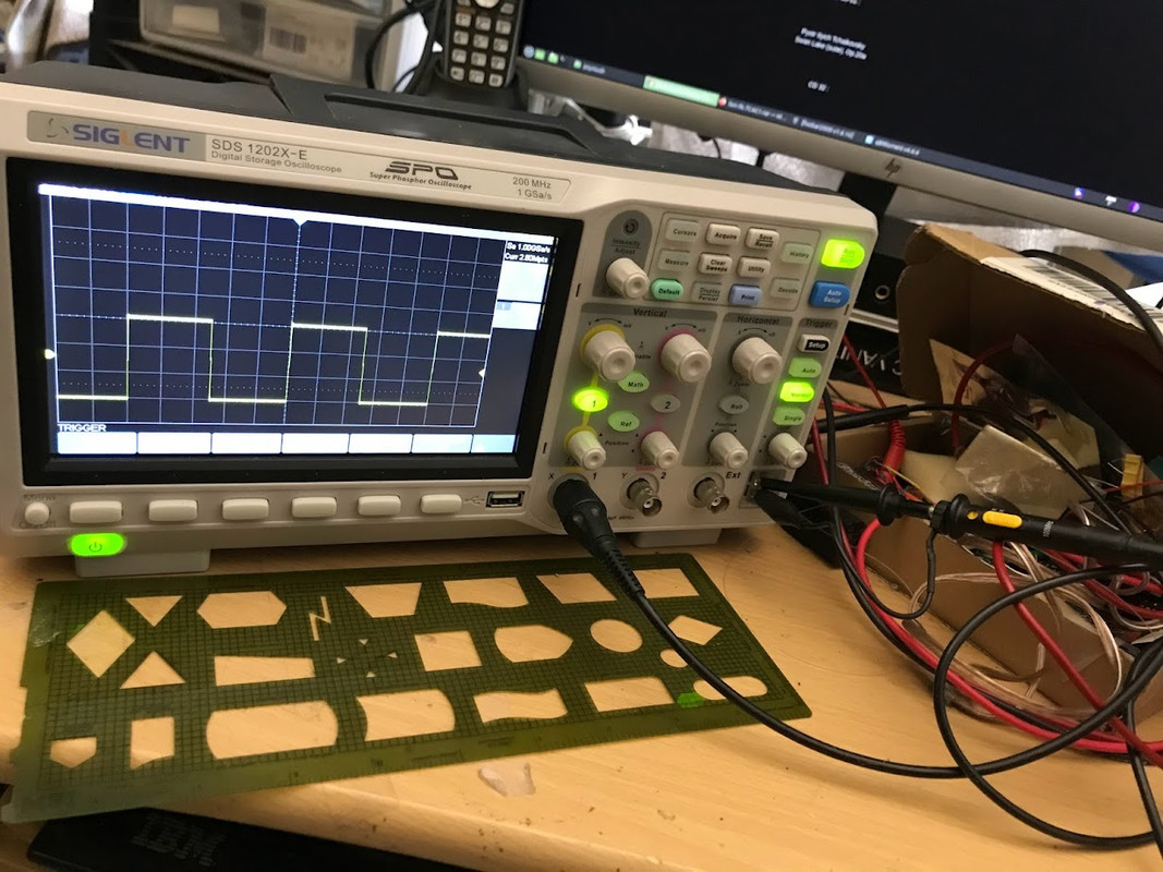

Cold-boot reliability still on wait-n-see ...
The only thing that I can think of that would cause this and be internal to the scope would be if the input capacitance of a particular channel were changing.  I think it is pretty unlikely that the calibrator output would misbehave so as to cause that display, but if you have another scope, you can check easily enough.
If the problem is changing input capacitance, testing with the probe set to 1X isn't going to help.  Instead, if you try this fairly simple procedure I think you can figure out if and where there is a problem.
1) Connect a probe to each channel, set to 10X, and connect both of them to the calibrator output.  Remove (completely) and set aside both ground clips, you don't need them and they might cause confusing results.
2) Set both channels identically so that the calibrator signal appears on screen and the two signals are right on top of one another.  It doesn't actually matter whether you select 1X or 10X on the scope, but just to keep things straight use 10X.
3) After the scope is all warmed up, adjust each probe's compensation as needed for the nicest square edge you can manage.  Observe for a little bit and make sure the display is very stable and the traces are right on top of one another.  You can alternately select each channel and it should be right on top of the other one, as if there was only one trace.
4) Turn the scope off overnight or for as long as you think it needs to cool down.  Turn it back on and see if there is any problem.

About my probes ... pretty std. Velleman 100 mhz, 1x/10 x probes. Not high end but typical probes (2010 price) puch'd at a local electronics shop. See: https://www.jameco.com/z/PROBE100-Velleman-4-Foot-100MHz-Oscilloscope-Probe-Set_2130618.html
About my issue ... "Auto Setup" seems to be the magic button, at least for warm boots. It fixes everything. If I don't press Auto Setup, and warm boot OFF---> ON  (the flashing power button, in standby mode I assume) , and have the probe connected to the front-panel 1k sqrwave  / gnd tap for self test, I get a horizontally rolling pattern. I must go into Trigger Setup, and manually select Source (CH1 or 2) and Slope Falling (but sometimes either Rising or Falling will stop the rolling ...... WTF!!!!!!!!!!!!!).
Not sure about Cold Boot. I don't have lot of time to invest in this experiment.
Bottom line: After the 1k square wave looks good, square and steady ... and I unplug the device as is ... and re-plug and pwr on, a day or two later,  with the probe still connected to 1k  test tap, the Siglent should show the SAME steady 1k square wave, EXACTLY as when I pulled the plug. My Tek 465 can do that.
There is your problem, you MUST power down with the front panel button for this scope to save settings.

Let me reiterate what so far several people told you:
Modern scopes are NOT anything alike your Tek 465.
They are basically computers put in scope case.
You have to boot them, and shutdown them nicely. Like computer.
They have literally 10s of triggers and trigger modes.
But they don't have alternate trigger.
Modern digital scopes are much more powerful than old analog ones. They also don't have some stuff old ones had, some stuff because they are digital and some because people changed the way we use scopes..
But that brings both complexity and new ways of thinking, before we are able to use them them to full extent.
They don't have physical switches. You set them up from menus. What software remembers is important.
You can set scope to boot every time to a reset state. That is default. You can also go into menu and set them to boot to any combination you like. You can save many different setups and recall them.
Digital scopes are different.
Bottom line is that you seem to not understand exactly how to use digital scope and you need to read the manual to learn how. You will have to invest time. Otherwise you will never know how to use it properly..
I understand your frustration. But that is just how the world is today. Take it or leave it.
I have same problem with these new cars. There are quite few today that don't even have a knob to set heating. You set it on a stupid touchscreen. It annoys me to no end. But I had to drive one few days ago and I had to learn how to navigate menus because alternative was to freeze because I refuse to learn how to do it. That seemed stupid, because I don't like cold. So I spent few minutes learning to navigate menu system.. I was still annoyed by why is world going in that direction but I was able to operate it so it serves my purpose.
Being stubborn at your own expense is never good choice..
What I proposed will take you 2 minutes to set up at night and 30 seconds to check in the morning.  And stop unplugging your DSO before you shut it down, that's not the proper way to use it.  Do you yank the plug out of the wall on your computer or LCD TV and expect it to go right back to where it was when you plug it back in?  After all, my old RCA Colortrak would do that just fine....

After overnight cycle ... the Siglent seems to be behaving upon start. "Fascinating!"

Given your setup as pictured and assuming this is at power-on with no adjustments, I've no idea why you would have "horizontal rolling" on startup at times.  As for the probe compensation pattern issue that you were originally complaining of, you would likely need to have the probe set for 10X to observe such a problem.  I explained this in an earlier post.  I'm squinting and guessing, but it looks like your probe is set for 1X.  And it looks like you have AC coupling on, although we can't read the screen at all.

Now if you could just learn to use it DC input coupled and only use AC coupling when required I'll leave you to enjoy learning the capabilities of these fine little DSO's.  :popcorn:

RTFM.  It's in the utility menu.  :box:

Scope recovers from power outage just fine. Works perfectly, it seems. It just resets to defaults because you need to save your favorite settings first. But you need to learn how to do it..
In order to be able to think out of the box you first need to know what is inside the box.
I have two news for you: good and bad.
Good one is that your scope is all good and well. Not a single problem with it. So no need to worry.
Bad news is that you don't know how to use it and refuse to learn.
