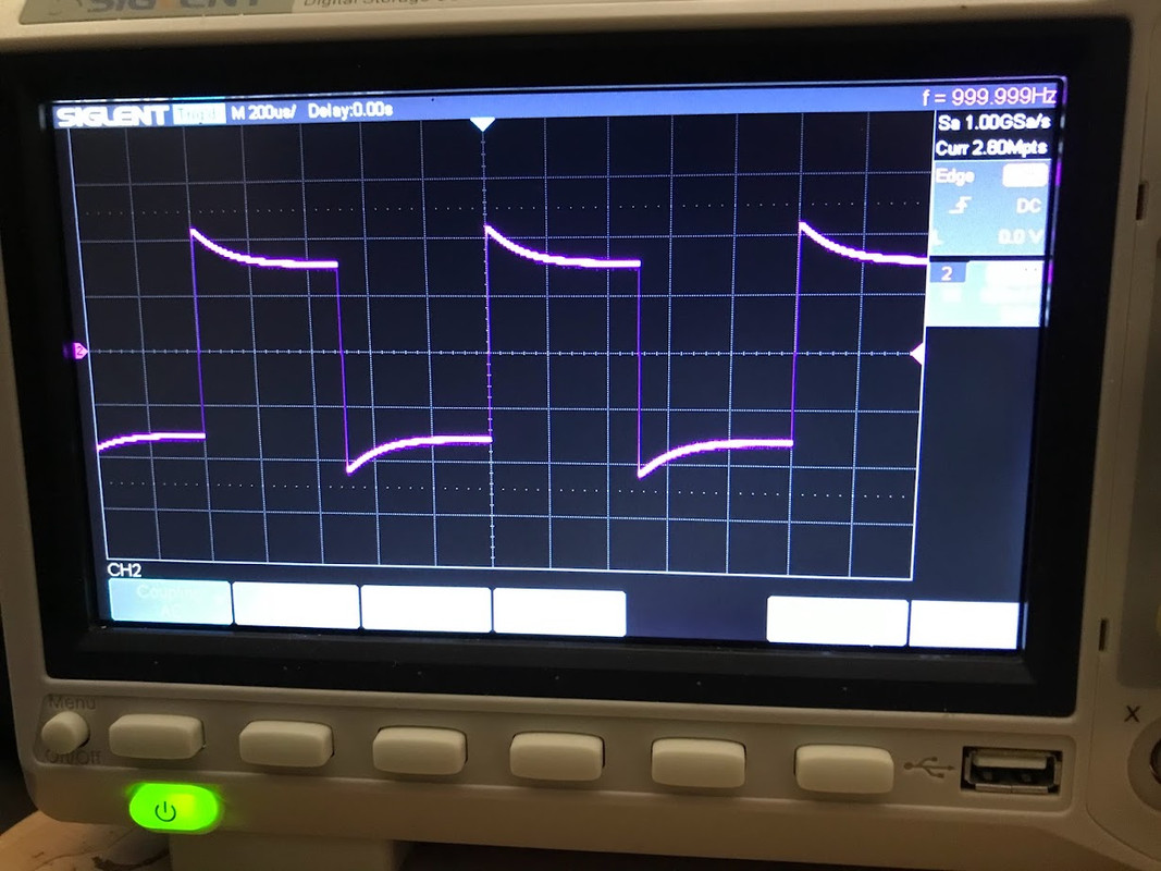

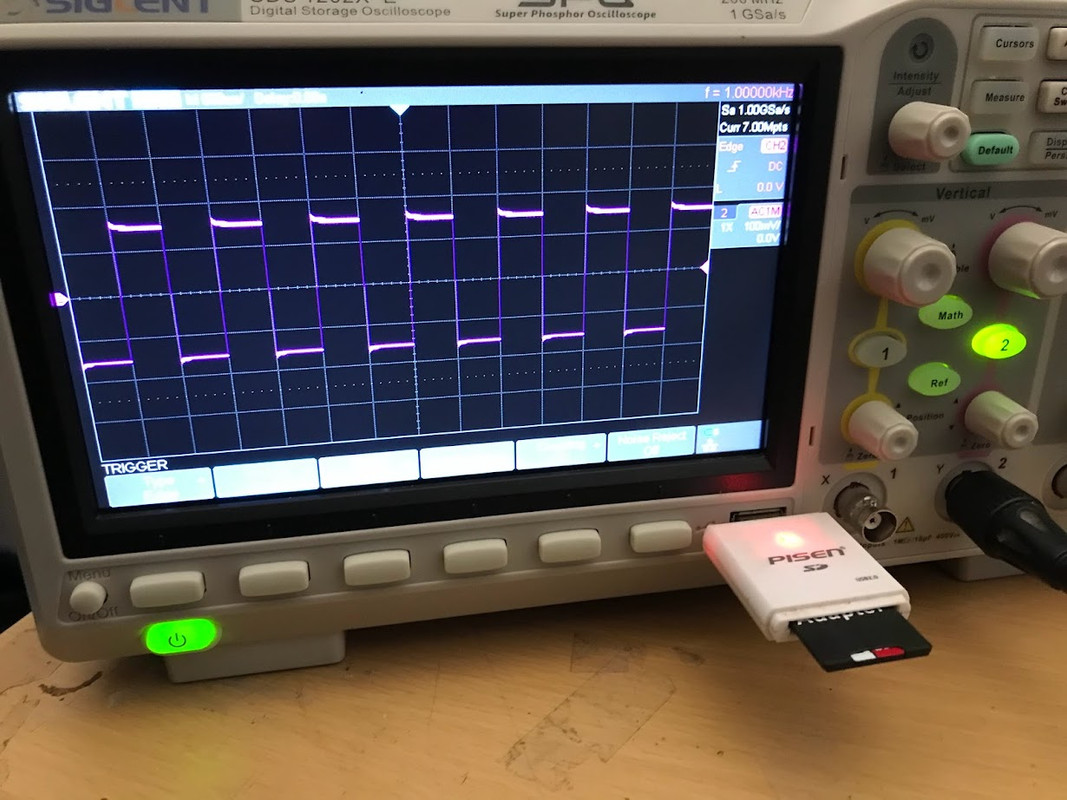

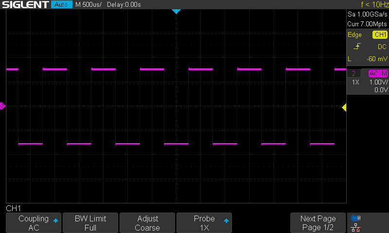

I purch'd this scope about 2.5 years ago. Haven't used it much because I'm a bit addicted to my old analog Tek 465.
That said, if any of you own this scope, share your thoughts. For example, how does it compare to similar priced Rigol models? How about day-to-day reliability?
Please share any tips and tricks with this scope.
One strange "anomaly" (??) of the Siglent I ran into was that if I swapped my probe from Ch1 to Ch2 -- the probe tips and gnd on the same DUT -- Ch2 did not lock trigger. I don't know how to do that.
If I have both Ch1 and Ch2 probes -- say comparing two logic-chip outputs -- then Ch 2 does lock (as does Ch1).
Have look at this waveform displayed on my Siglent. It is MCK output from an audio USB-I2S adapter (see bottom photo; the Owon meter was used in another experiment). I am using the alligator probe for gnd.
Anything look unusual?

If you are triggering from a different channel then you need to select which channel that is in the trigger menu.
Also set the trigger level to get the best rising edge, where it is in the image could result in irregular triggers.
« Last Edit: February 17, 2023, 09:35:59 pm by TheDefpom »

You also shouldn't really switch probes between channels because they will need to be re-compensated.  Probe compensation is channel is specific to each channel.
Wouldn't make a huge difference, but for the sake of best performance and all ..
Yeah, for some reason I can't permanently set EDGE trigger for both channels. If I turn on edge for one channel, the other channel trigger is null. And so I must manually do it. Weird.
Also very weird is the cold start ...
If I've had the unit off -- unplugged - - for, say  over a few hours or longer, and re-start, I have very rough 15-20 minutes of 'settling-in time'. Nothing locks (trigger), As I rotate the vertical or  horiz., or other buttons, I can monetarily see the correct signal.  This even applies to something as simple as the 1k square wave /ground tab on the from. The first test of 'scope reliability.
And then -- after 20 min or so -- normal. Very weird!
I have not used this 'scope enough to establish some sort of what-is-normal behavior. And of course, the 'scope is out of warranty! Life lesson: open and test your new instrument thoroughly and extensively upon delivery! It might come outta the simulation factory ... possessed.
You're in the DSO world now and not all CRO features migrate to DSO's, ALT triggering a fine example.

1/ Previously you have been asked but haven't responded which firmware version is installed ?
To be up to date Sys Info in the Utility menu should display Version V1.3.26
2/ This DSO should perform perfectly from the moment it is powered ON on one proviso, it has previously been powered OFF correctly.
That is with a 2s press of the power button to allow the instrument to power down in a controlled manner and save all previous settings.
If by chance firmware is up to date and scope is still playing up press Default to return the instrument to factory settings.
Yes, that is evident and you really need spend more time with it to learn all its features.
First for me is what I see on the display which tells me heaps about how you have it set and how you have used it.
We are here to help and first exercise is to grab a USB stick and learn how to capture screenshots to it by just pressing the blue Print button. These captures are just a few 10's of KB not some 2.5 MB monster done with a camera.
Cleverly done you can capture an appropriate menu too to convey to us more info on how you have the scope set up.
Learning to use the power of the scope starts with setting channel input attenuation and probe attenuation correctly
so measurements are correct which removes the need for mental arithmetic on the fly to arrive at waveform values.
Typically we set the probe and channel attenuation to 10x and leave it there. Each probe also needs to be assigned to a channel by fitting the colored rings and in 10x mode compensated.

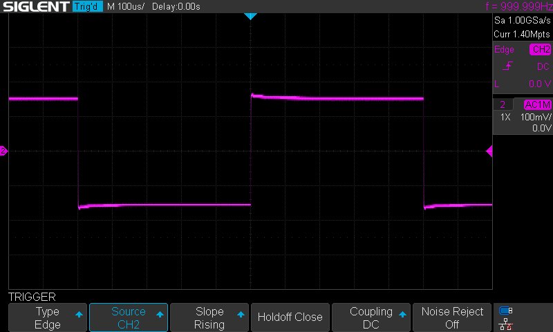

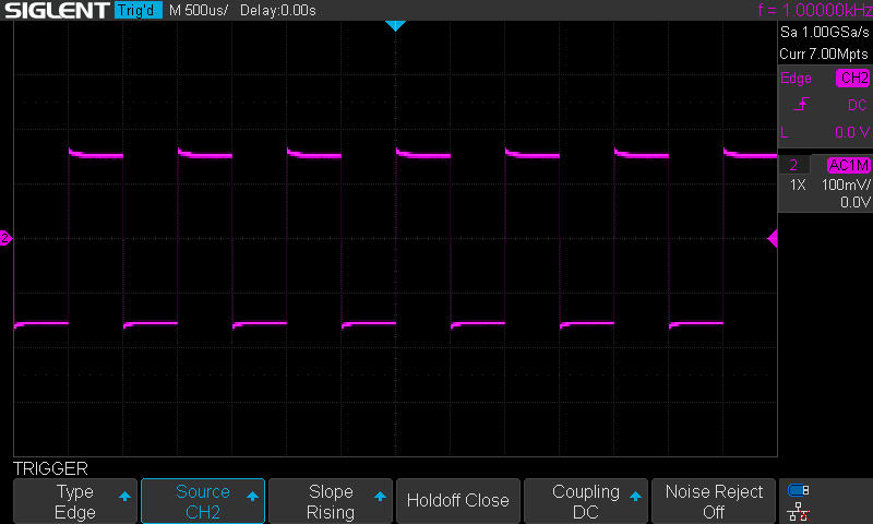

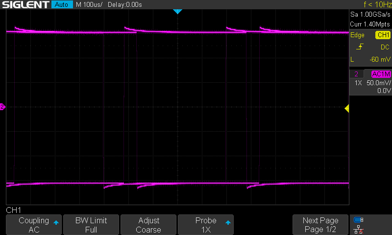

No. This is what the signal looks like. For example, I looked at Pi2Aes
And with raspberry pi4

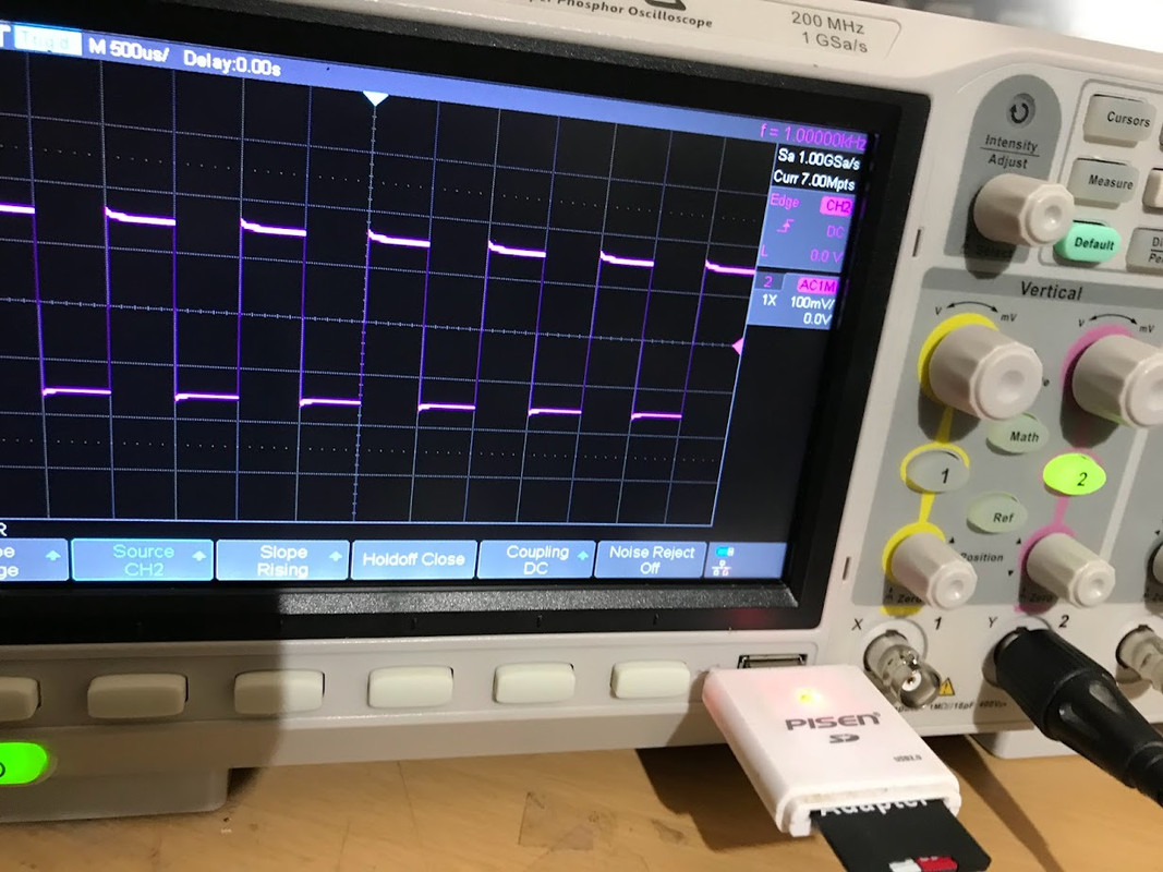

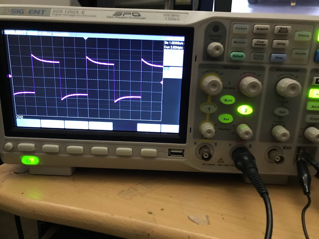

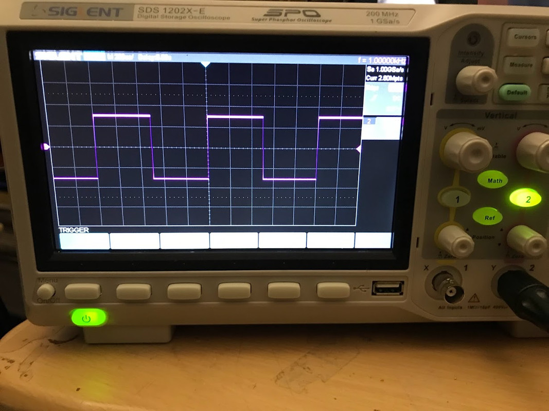

No, I have not updated FW.
Today, I had the unit unplugged for a few hours. Came back to it, plugged it in, put the probes (1x) on the 1khz sqr wave/gnd test tab (see photos).
Got weird NON-square 1khz form for a few minutes. And it settled  to a nice, clean square. This is what I was referring to before. The cold-start weirdness can vary quite a bit -- waves look strange or can't lock, etc.
Un-updated firmware causing this garbage --- really ? Even so, what a major SNAFU in quality control.

Don't call me clueless sonny as I've sold more of these scopes than you might imagine !
Again, we can't see your settings in the piss poor pics you took due to the lighting glare.
Please take a screenshot to USB with the blue print button then we can see what's going on.

Do you need help or you just enjoy this kind of conversation....?
You need to work with people that are trying to help you.. Sort of help them to help you..
That being said, please apply newest firmware for your scope. Manufacturers make fixes and upgrades and sometimes that is all that needs to be done to fix something.
Second, how do you know it isn't the probes that is problematic ? 1X/10X probes can have noisy switches and also cable and BNC can have bad contact.
Does the overshoot that is visible gradually (slowly) sets to normal squarewave or it is distorted for few minutes and then suddenly switches to proper squarewave ?

Cold boot this morning. Not as distorted as yesterday, but not SQUARE given the probe is connected to Siglent's own, pure 1k sqr generator tab.
This is the ENDS issue.
Have it both ways, folks, as your are deflecting! But concentrate on the ENDS, not the MEANS: This issue ain't about the USB capture ;) So don't let your dream get distracted ;)
MEANS: iPhone capture:
MEANS: USB "Print" capture
EDIT:
I just noticed that for all the images above, my probe switch was on 10x while the scope was MENU-set to 1x. So that may have caused this morning's issue.
Returning the probe to 1x made waveform look normal (see below)
This looks better, but the Siglent has been warming up for about half hour now, so the issue may very well cont. to exist???
The iPhone capture supports my point that USB Print is not a major issue; in fact, it may be the better storyteller.

Your explanation and imges tell that you have not adjusted probe LF compensation. (Probe 10x aka 10:1)
Of course when probe is 1x square looks quite ok because when probe is set for 1x this LF compensation do not affect anything. (how you set oscilloscope input probe factor do not matter in this, only what matter is probe itself)
But when probe is set for 10x then also this compensation need adjust. In your pictures it is now very clear that it is not adjusted ok and you need do it. You , user, are responsible about it, not Siglent.
You need adjust it so that bottom and top is as flat as possible.
