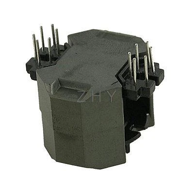

« Reply #33 on: April 08, 2024, 02:58:13 pm »
Thanks for the recommendation Topquark!
In fact, I'm looking for BNC ends so I can use them with my RLC meter. I measure L of small coils like the ones shown below and it's a bitch to do it with the normal kelvin clips  ;D

Well if you already have a LCR meter, then you'll need the BNC type for sure.
But playing the devil's advocate here, LCR tweezers are definitely the easiest way to go for winding transformers. Bonus points for ease of taking it to the drill press / grinder when grinding the air gap iteratively for flyback coupled inductors.  ;D

Well, yeah I thought about tweezers but I need to use the first pin as a reference and then measure the L from pin1 to every other pin. I don't see it happening without a fair amount of swearing... Plus I need to have free hands to go through the menus, etc...

Well I was trained to use chopsticks before learning how to walk, so as not to starve. So the fact that it is a pair of tweezers but not two metal sticks as probes is an absolute luxury.  :popcorn:
But for real, it is actually quite easy to test different coil pairs with tweezers, but YMMV.  ::)
