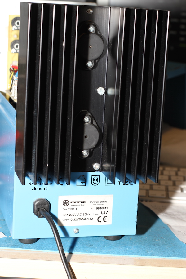

Oh dear, a non-detachable power cord. Also, no mains earth. Strangely, it has a 4mm earth jack on the front. Despite displaying the double insulated symbol on the rear it's got a metal case. Any electrical appliance encased in a metal enclosure wants said enclosure earthing in my opinion. So, I detect a lovely little Saturday afternoon project approaching. I can kill two birds with one stone here:
1. Get rid of that affixed power cable that snags on everything and follows you around like a lost puppy whenever carrying the unit about.
2. Get the case earthed!!!!

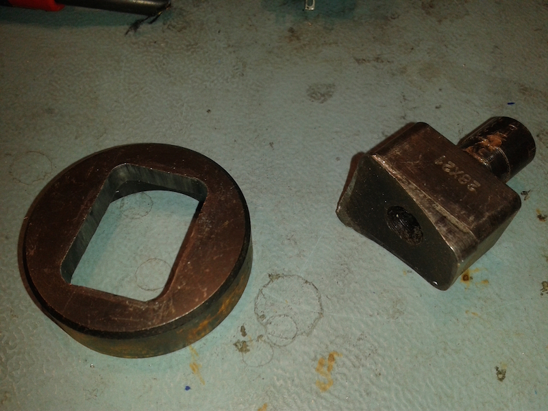

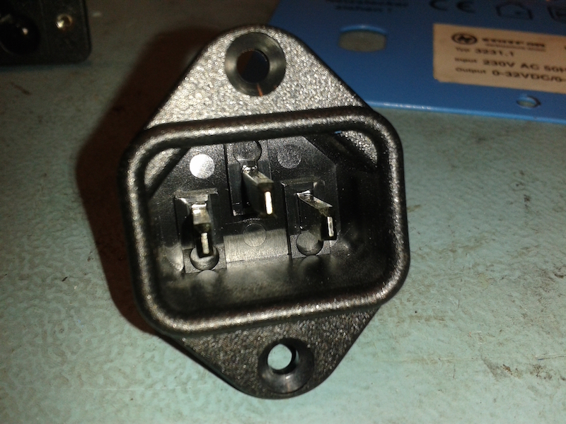

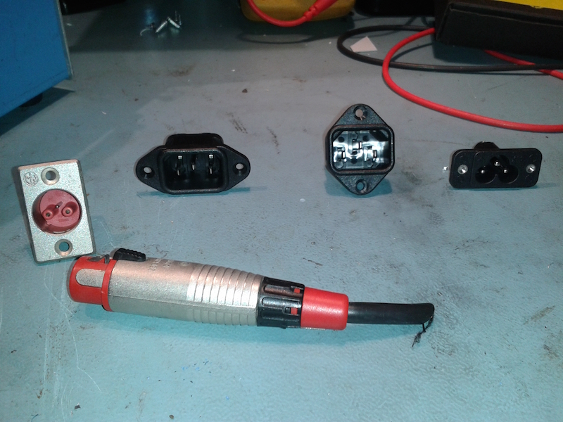

I had a few options to choose from in the IEC 60320 range with regards to the power inlet socket. I had also considered the obsolete XLR-LNE connector due to initial concerns with space. The C6 would work, but C5 leads, although common enough, just aren't as handy as C13 leads, so I eventually figured that I could fit the C14 inlet with the vertical flanges in the space.

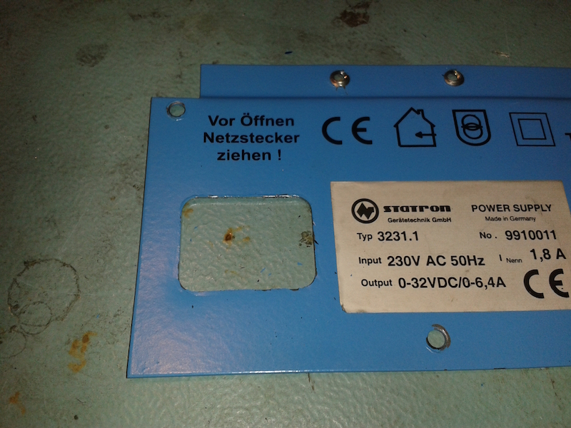

Now, with that settled, I needed to remove the old lead and create an aperture to accept the C14 connector.

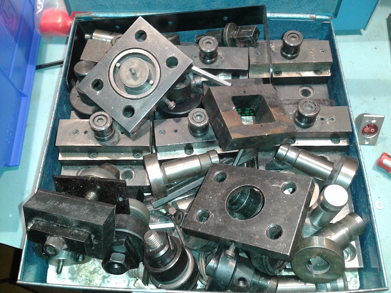

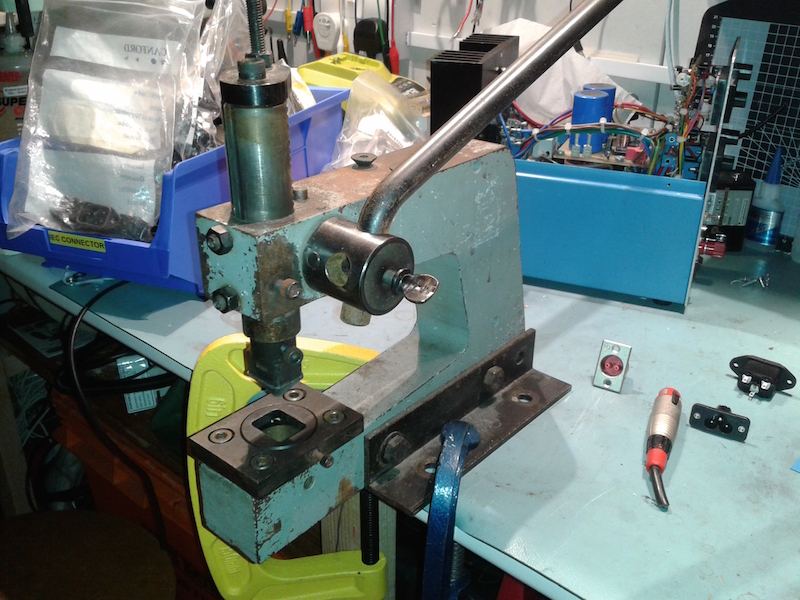

Some scratching around in my die and punch set box was required to find the correct tool combination. It's a bit of a mess, I really ought to sort it out.
Found it.
Unfortunately, I don't have enough bench space to accommodate my die press in a permanent position, so I have to affix it to the bench with big clamps each time I use it, which luckily is infrequently enough not cause too much of a nuisance.

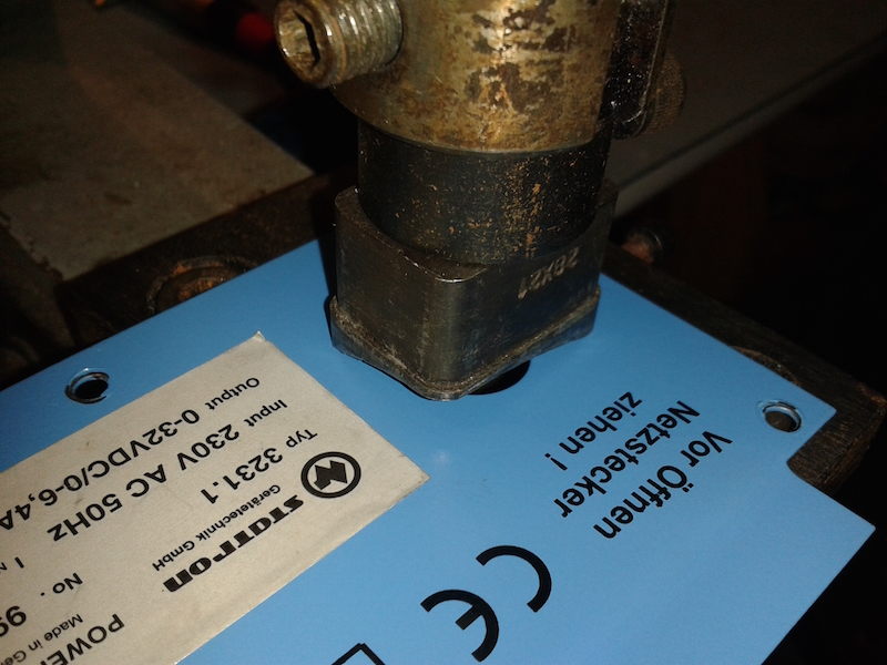

So, I have removed the small metal panel below the heatsink and here I am aligning the tool. The thing with these punches is that they remove a lot of material in a relatively short amount of time which makes the job quick. However, due to this, you need to be sure of where you are cutting, as there is no going back.
Wallop! It's done. I'd have to drill the screw holes later.

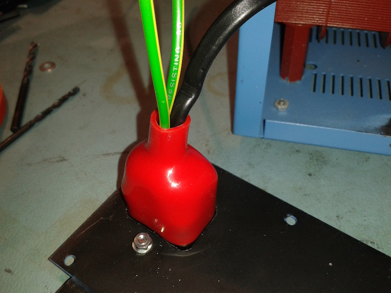

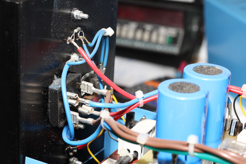

Here I have mounted the C14 receptacle and connected up the wiring and employed an insulating boot to cover the whole lot up.

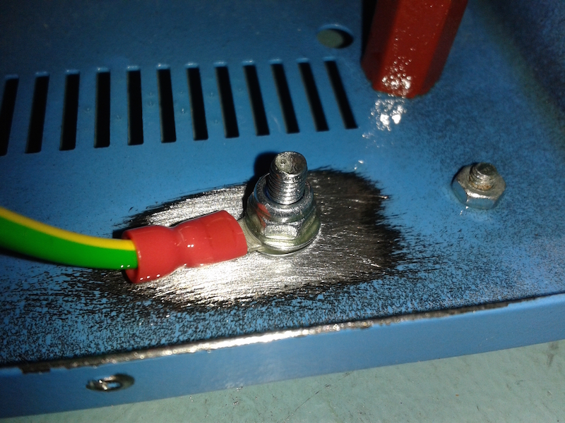

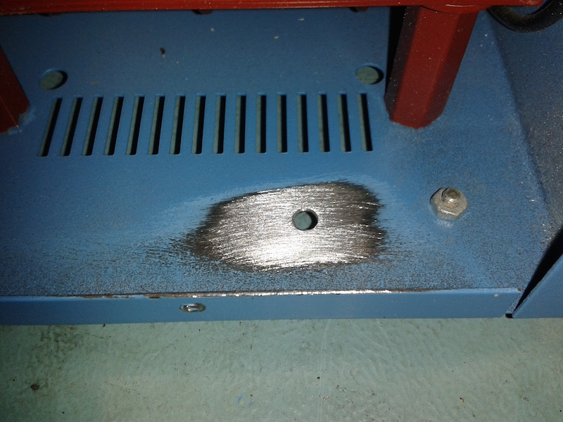

Now, to make an earth point, I drilled a hole in the bottom of the chassis through which an M4 bolt could pass. Then I removed the paint from the area with a small section of emery cloth.

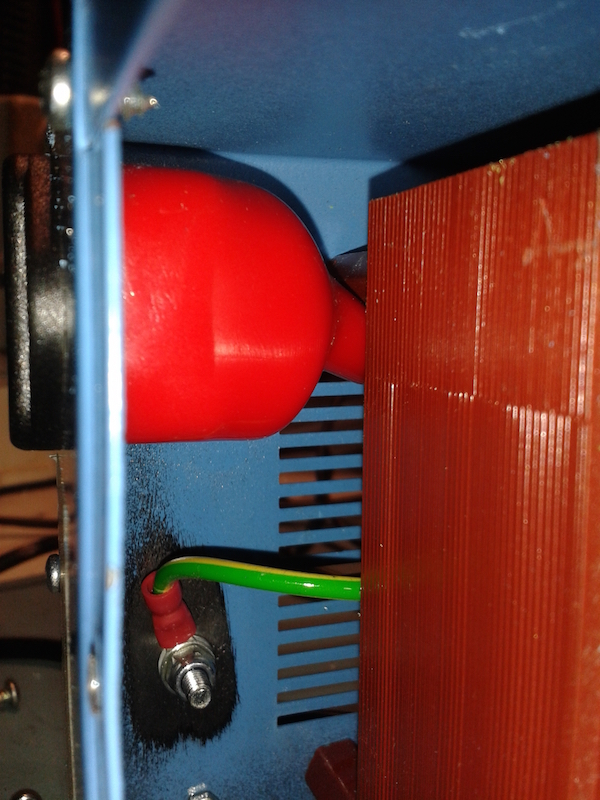

Now, one of the earth wires from the C14 connector is terminated in a crimp terminal and bolted firmly down with a nylock nut and an internal star washer between the case and the terminal. Once fastened, I sprayed a layer of clear lacquer to prevent corrosion from compromising the connection.

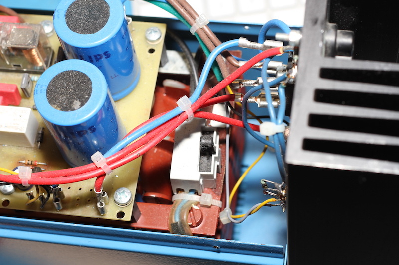

Upon offering up the rear plate, some of the wires proved to be a bit cantankerous causing the insulating boot to be pressed into an unfavourable position.
I solved this by altering the course of some of the wires around the other side of the mounting post for the transformer.

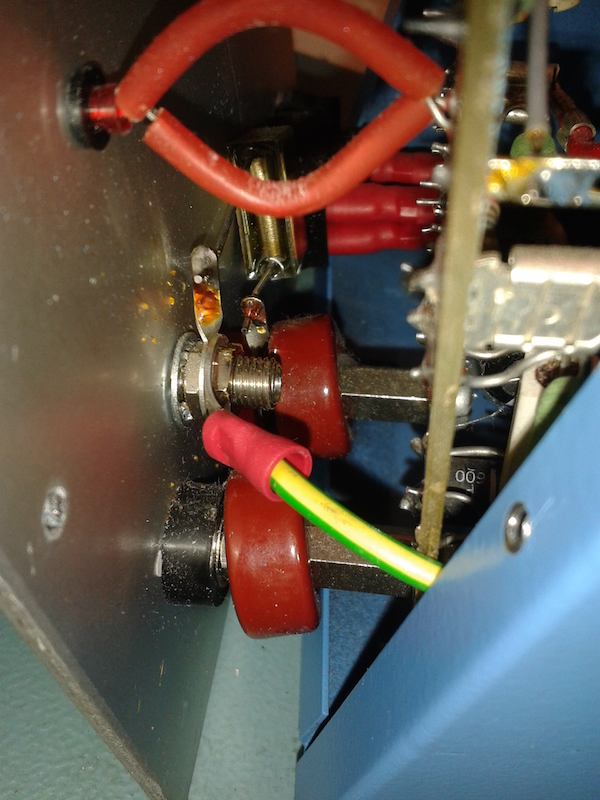

Now, given that the main enclosure is of steel construction and the front panel is of aluminium, I decided that galvanism may contribute to an unreliable connection at the interface of the two metals. In addition, the two are only joined by a few self tapping screws, which provide durable construction, but an electrical connection may, again, be unreliable.
So, to overcome this problem, the second of the two earth wires originating at the C14's earth terminal will have it's other end terminated in a crimp on connector and bolted down to the rear of the earth terminal presented on the front panel.

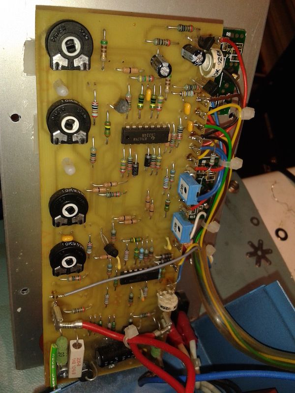

Here is a view of the whole of the PCB mounted vertically behind the front panel.
Here is a side view with my modification applied.

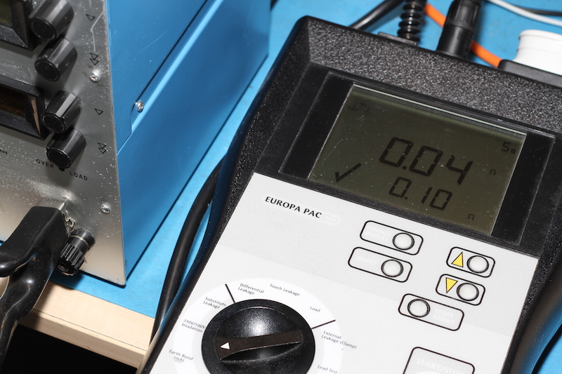

After re-assembling the product I thought it prudent to conduct some tests. Of course, I'd need a power cable. My brother only has a tiny work space, so I thought a shorter custom length cable would be helpful to him.
I also took the time to construct some test leads. One set are standard 4mm to crocodile clips. The other set is terminated into an XT60 connector which is commonly used these days on electric models due to it's 60A capacity. My brother and I share a mutual interest in electric models.
So, on to the tests. Let's start with Mr. HSE. We've got to keep him happy from time to time.  :-+
Although I am confident in my own workmanship, it's nice to just go the extra mile, especially for my younger brother.
Power lead OK. Please excuse the blurred image, I had neglected to check my camera's shutter speed.
An earth bond test revealed 30m? at a 10A test current and 40m? at a 200mA test current. Very good.

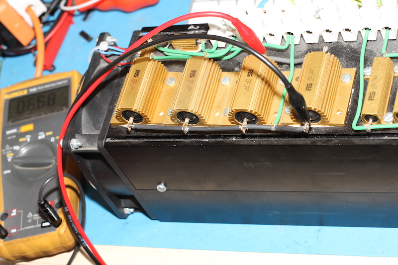

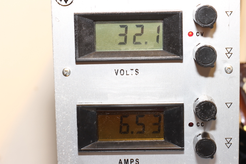

Now for some good old load tests. Behold, the load bank. In the below images  I have actually overloaded the power supply with a 4? load with the voltage adjustments at their highest settings. You can see that it is in constant current mode passing close to 7A. This sort of condition did cause the current to drop rather steadily as you can see, in the time it took to take a photograph of the resistor bank, the current displayed on the multimeter (and indeed the PSU ammeter) had reduced. There is nothing to worry about here as this is an overload condition. Although the particular resistor array arrangement was only worth about 120W, it had not heated up enough to cause that much of a drop in current. The heatsink to which the resistors are mounted is massive.
Even in it's overloaded condition, I could detect no appreciable noise on the output.
What about operating the PSU within the constraints of it's advertised specifications. Crazy though such a proposition may seem, I thought I'd re-arrange my resistor bank in such a way as to present a 5? load to the PSU. A 5? load would drive the PSU to the brink of it's advertised limit at 32V. Indeed, 6.4A should flow and it does. Again, at this point my resistor bank is overloaded (two 10? 75W resistors in parallel). The mass of the heatsink is keeping the resistors from melting (or even warming up for that matter).
It not only met it's specifications, but it sustained them for a good ten minutes before I decided that the pass transistor's heatsink was getting rather too warm. With forced cooling it'd probably be happy with that output all day, although the transformer hum at those power levels may begin to cause some irritation. The transformer does look man enough,but I do wonder about it's full load duty cycle. Despite my tests, I'd be staggered if my brother finds need to operate this unit above 50% of it rated output. for any sustained period of time.
