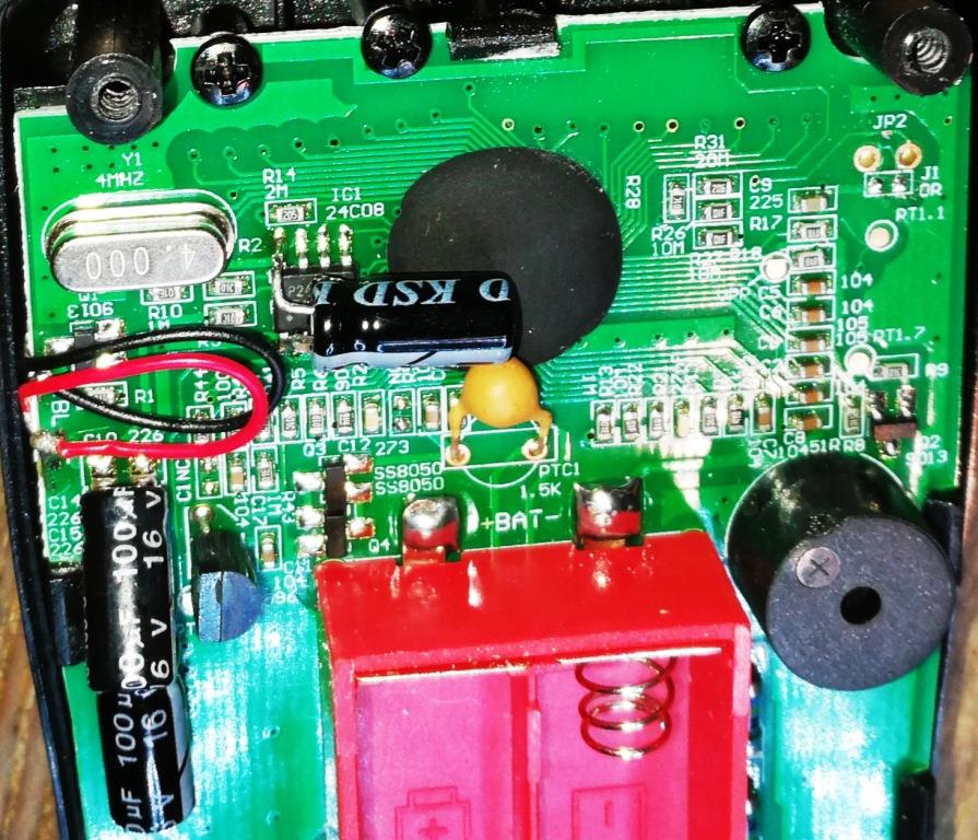

Just replace the electrolytic caps on the filter for the digital ADC with 6 ceramic smd caps 96nf each + 1 tantalum 630uf

The only 1 problem with this multimeter is the mechanical switcher :(
Basically when i'm going to set the Ohm range i need to not miss the perfect spot for the switcher,because the multimeter will play with random numbers ...
So basically at this point i still need to check the switcher and see what's going on there.

I'm unsure what you are improving, as you haven't identified a problem or defined it.
Why is this thread called 'super ultra' - when there is no benchmark or reference test of stability?  Do you mean it is just has a stable display?
Are you just applying extra filtering to the battery dc supply to the chip?  If you want to do that appropriately then you need to apply the filtering as close to the chip as possible.

I have made this topic,because a lot of users which own's this dmm have the same common problem regarding the slowness and random reading on the Ohm range.
So basically there is noting of wrong if i call my topic Super ultra stable aneng especially when i've fixed it's childish sickness from factory.

Yes! i'm perfectly aware of that,but in any case after my so called "RESEARCHes" i found that ceramics or tantalum caps are the the best for this kind of task and this is because the electrolytic caps tend to jam the measurments.
This effect is caused due charge/discharge after you turn on or off this particular model of DMM.
« Last Edit: September 29, 2019, 10:42:55 am by Free_WiFi »
Is this what you and others have observed?  What is the actual observation?
I've never had anything abnormal happen with just an electrolytic as filter.

Maybe because my electrolitycal caps are bad or whatsoever,btw my multimeter with electrolytical caps do bouncing measurements and can't never settle to some point

the next step would be replace 4M oscillator
my stable with 12 ( if i remember right) , caps measure you need to divide :) and beeper sound too thin ... ; but it really fast now
i have another one it works with 24M ( was 4M), super fast,  i use it to probe resistors ....  an auto range count down in a blink ...
upd:  TO-92 are Vref,  next to are small cap shunt, that not enough,    so 1-10uf tant.  would be much better ....

I own the Aneng 8008 and I've added better MLCC capacitors and noticed that does seem to improve the stability/settling. I also calibrated it against my 34461A and bought a set of gold-plated leads for it that cost almost as much as the meter.
It's accurate and the display is VERY easy to read.  I use it a lot to track voltages on small 3.3V or 5V embedded projects.
