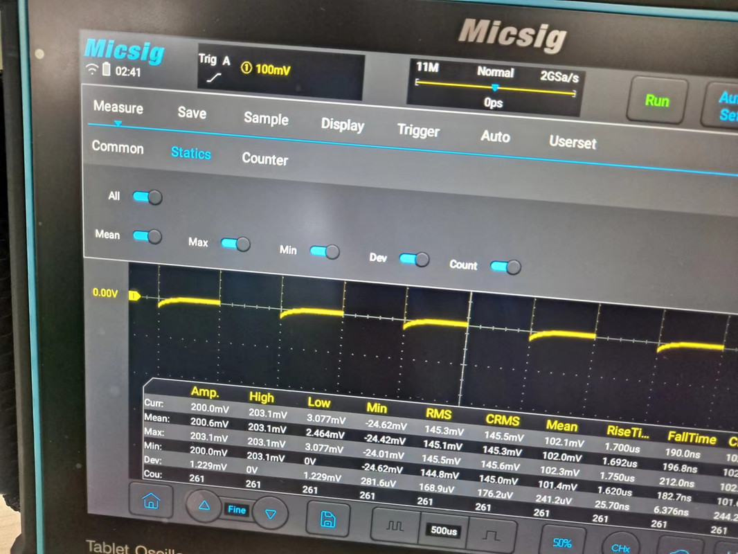

Consider that Micsig is often criticized for not having statistics and pass/fail.
Just found this on my upgraded Micsig TO3004, Statics? LOL.

Mh, this is quite something. So they added statistics to all their scopes??
And now they backport this to my STO100C and all existing models. I won't be buying anything from them until they do that. I don't like that they seem to have abandoned scopes that they have been selling until few months ago. Statistics is basic stuff, some of the handheld scopes for 100$ have it...
No. On STO 1000C series is not present. Why ?  Is just a software matter .
