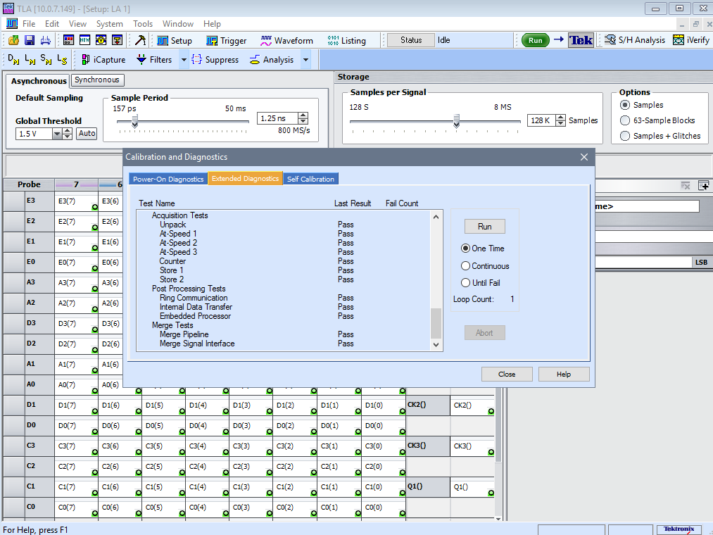

It's my turn now to hax attempt  >:D. I managed to seduce nctnico to part with BB4, and to make fun even more challenging I'll be trying to get it up in even older TLA714.
Are you sure that there is an older Firmware than 5.6 .XXX for TLA7BB4?
Stash of saved ebay photos indeed reveal BB4 with 5.4. FW on BB4 we try in this thread is 6.1 at this moment.
After some fiddle-middle, I've got it to pass self-diag.
Also haxing to full config was easy enough:
Module HW itself has 4GBytes of DDR2 RAM (those BGA rams around on both top and bottom sides).
As bad news - there is no serial output on either of the UARTs :(
Guts tell me that older server (v5.1) don't understand faster module/Magnivu speed of BB4 and triggering module to halt in error condition (fast blinking activity LED).
I need to find a way to install newer TLA Apps than 5.1 on mainframe itself to try with newer server side.

 ]]]]]]]]]]]]]]]]]]]]]]]]]]       KERNEL: WIND version 2.4
 ]]]]]]]]]]]]]]]]]]]]]]]]]       Copyright Wind River Systems, Inc., 1984-1995
                              CPU: Tektronix VXItools.  Processor #68360.
                              Memory Size: 0x400000.  BSP version 1.0.
> PREPARE TO BE ASSIMILATED
 /3\  PLL Calibration...required 0.1 seconds
 |\./| MCA Calibration...loading values from nvram...required 0.0 seconds
  \|/  Arc Load/Diag.....required 0.6 seconds
   /2\  PLL Calibration...required 0.1 seconds
  |\./| MCA Calibration...2 saving values to nvram...(ERROR)calDramAlignEdge:calMaxZeros testdqs falling-> grp8
Loop[00][Dram:1][Group:0]: 00000000 00000000 00000000 00000000 00000000 00000000 00000000 00000000 00000000 00000000 00000000 00000000 00000000 00000000 00000000 00000000 00000000 00000000 00000000 00000000 00000000 00000000 00000000 00000000
Loop[01][Dram:1][Group:0]: 00000000 00000000 00000000 00000000 00000000 00000000 00000000 00000000 00000000 00000000 00000000 00000000 00000000 00000000 00000000 00000000 00000000 00000000 00000000 00000000 00000000 00000000 00000000 00000000
Loop[02][Dram:1][Group:0]: 00000000 00000000 00000000 00000000 00000000 00000000 00000000 00000000 00000000 00000000 00000000 00000000 00000000 00000000 00000000 00000000 00000000 00000000 00000000 00000000 00000000 00000000 00000000 00000000
Loop[03][Dram:1][Group:0]: 00000000 00000000 00000000 00000000 00000000 00000000 00000000 00000000 00000000 00000000 00000000 00000000 00000000 00000000 00000000 00000000 00000000 00000000 00000000 00000000 00000000 00000000 00000000 00000000
Loop[04][Dram:1][Group:0]: 00000000 00000000 00000000 00000000 00000000 00000000 00000000 00000000 00000000 00000000 00000000 00000000 00000000 00000000 00000000 00000000 00000000 00000000 00000000 00000000 00000000 00000000 00000000 00000000
Loop[05][Dram:1][Group:0]: 00000000 00000000 00000000 00000000 00000000 00000000 00000000 00000000 00000000 00000000 00000000 00000000 00000000 00000000 00000000 00000000 00000000 00000000 00000000 00000000 00000000 00000000 00000000 00000000
Loop[06][Dram:1][Group:0]: 00000000 00000000 00000000 00000000 00000000 00000000 00000000 00000000 00000000 00000000 00000000 00000000 00000000 00000000 00000000 00000000 00000000 00000000 00000000 00000000 00000000 00000000 00000000 00000000
Loop[07][Dram:1][Group:0]: 00000000 00000000 00000000 00000000 00000000 00000000 00000000 00000000 00000000 00000000 00000000 00000000 00000000 00000000 00000000 00000000 00000000 00000000 00000000 00000000 00000000 00000000 00000000 00000000
Loop[08][Dram:1][Group:0]: 00000000 00000000 00000000 00000000 00000000 00000000 00000000 00000000 00000000 00000000 00000000 00000000 00000000 00000000 00000000 00000000 00000000 00000000 00000000 00000000 00000000 00000000 00000000 00000000
Loop[09][Dram:1][Group:0]: 00000000 00000000 00000000 00000000 00000000 00000000 00000000 00000000 00000000 00000000 00000000 00000000 00000000 00000000 00000000 00000000 00000000 00000000 00000000 00000000 00000000 00000000 00000000 00000000
Loop[10][Dram:1][Group:0]: 00000000 00000000 00000000 00000000 00000000 00000000 00000000 00000000 00000000 00000000 00000000 00000000 00000000 00000000 00000000 00000000 00000000 00000000 00000000 00000000 00000000 00000000 00000000 00000000
Loop[11][Dram:1][Group:0]: 00000000 00000000 00000000 00000000 00000000 00000000 00000000 00000000 00000000 00000000 00000000 00000000 00000000 00000000 00000000 00000000 00000000 00000000 00000000 00000000 00000000 00000000 00000000 00000000
Loop[12][Dram:1][Group:0]: 00000000 00000000 00000000 00000000 00000000 00000000 00000000 00000000 00000000 00000000 00000000 00000000 00000000 00000000 00000000 00000000 00000000 00000000 00000000 00000000 00000000 00000000 00000000 00000000
Loop[13][Dram:1][Group:0]: 00000000 00000000 00000000 00000000 00000000 00000000 00000000 00000000 00000000 00000000 00000000 00000000 00000000 00000000 00000000 00000000 00000000 00000000 00000000 00000000 00000000 00000000 00000000 00000000
Loop[14][Dram:1][Group:0]: 00000000 00000000 00000000 00000000 00000000 00000000 00000000 00000000 00000000 00000000 00000000 00000000 00000000 00000000 00000000 00000000 00000000 00000000 00000000 00000000 00000000 00000000 00000000 00000000
Loop[15][Dram:1][Group:0]: 00000000 00000000 00000000 00000000 00000000 00000000 00000000 00000000 00000000 00000000 00000000 00000000 00000000 00000000 00000000 00000000 00000000 00000000 00000000 00000000 00000000 00000000 00000000 00000000 (ERROR)CDramConfig::dramCalReceive: calDramAlignEdge returned ERROR
Rrequired 5.3 seconds
   \|/  Arc Load/Diag.....CHugh::slProvisionMainAcquisitionMemory: arcFastDramDiag failed: ARC_LPU_RSP_DIAG_ERR
CHugh::slProvisionMainAcquisitionMemory: arcFastDramDiag test failed
triplet[0] = { 0x01000008, 0x00000001, 0x0000ff00 }
Error: main acquisition memory provisioning (67108864) failed
Warning: acquisitions can not succeed!
required 0.8 seconds
    /1\  PLL Calibration...required 0.1 seconds
    \|/  Arc Load/Diag.....required 0.7 seconds
     /0\  PLL Calibration...required 0.1 seconds
ICC reset  -/---\-|-/---\-|-/---\> Complete
Borg is ready  (1.25 seconds)
