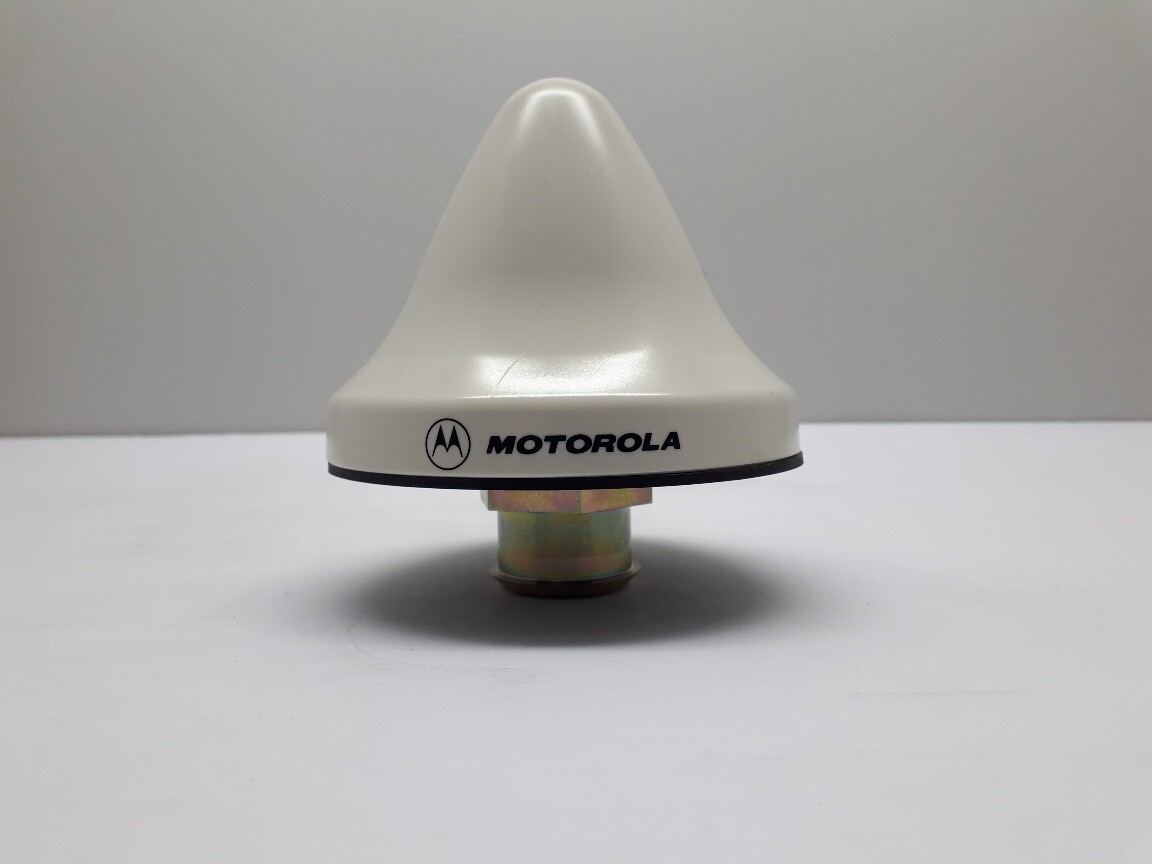

I also got a [forgotten] order delivered today. Scotttrade12 on ebay is banging out these Motorola GPS timing antennae for £6 each and I forgot that I'd ordered one. Brand new, still in the taped factory anti-static bag.
Someone else's photo as scotttrade12's photos are awful.
