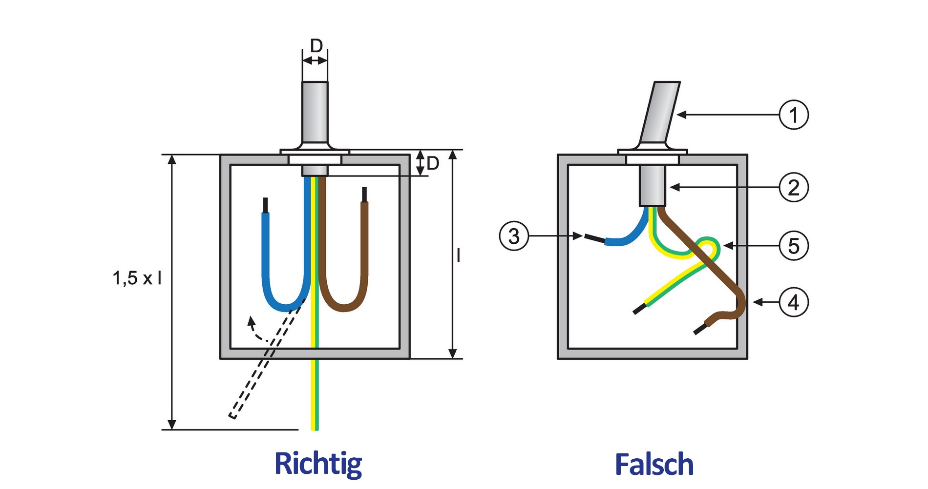

I have to disagree. It is not okay, because mounting the cables like this will cause stress on the membrane and it will become leaky over time.
Here is a picture on how to install cables correctly:
Source: https://www.jostudy.de/jowiki/geraetedosen

Yes, that's a valid concern. I'll fix that.

While that picture looks quite helpfull, and the concern of the stressed membrane seems valid to me, one of the most important things teached to me by the electrician greybeards for outside installations was (admittedly less urgent in this case where the junction box seems placed somewhere where the sun doesn't shine) to have them equipped with a tiny (1-2mm) hole in the lowest corner, so the inevitable condensation can drip out.

Still good practise to arrange cables entering or leaving to either have a drip loop, or if not practicable, having slight downward angle to deter water from pooling in the membrane area and then possibly freezing which can then compromise the sealing.
