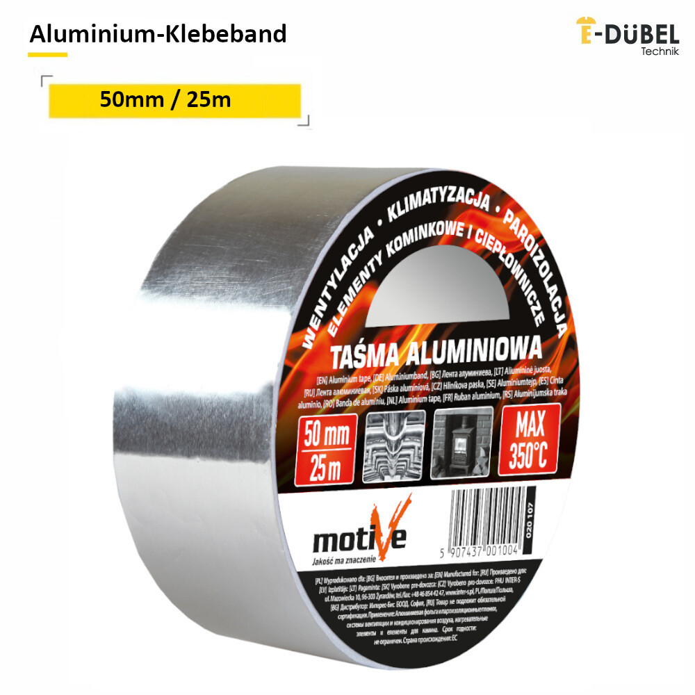

I don't like this combo of superglue and aluminium foil, because the superglue becomes brittle and unreliable.
I'd suggest to use something like aluminium tape. Sticks like hell.
Example (NAWTS):
https://www.ebay.de/itm/384640138059

Superglue is not a problem; in this application, if the repair pad is applied correctly the joint never has opportunity to flex.
Example (NAWTS):
Loctite 4851; stays flexible after curing, see attached datasheet. :-+ But the price :scared:
