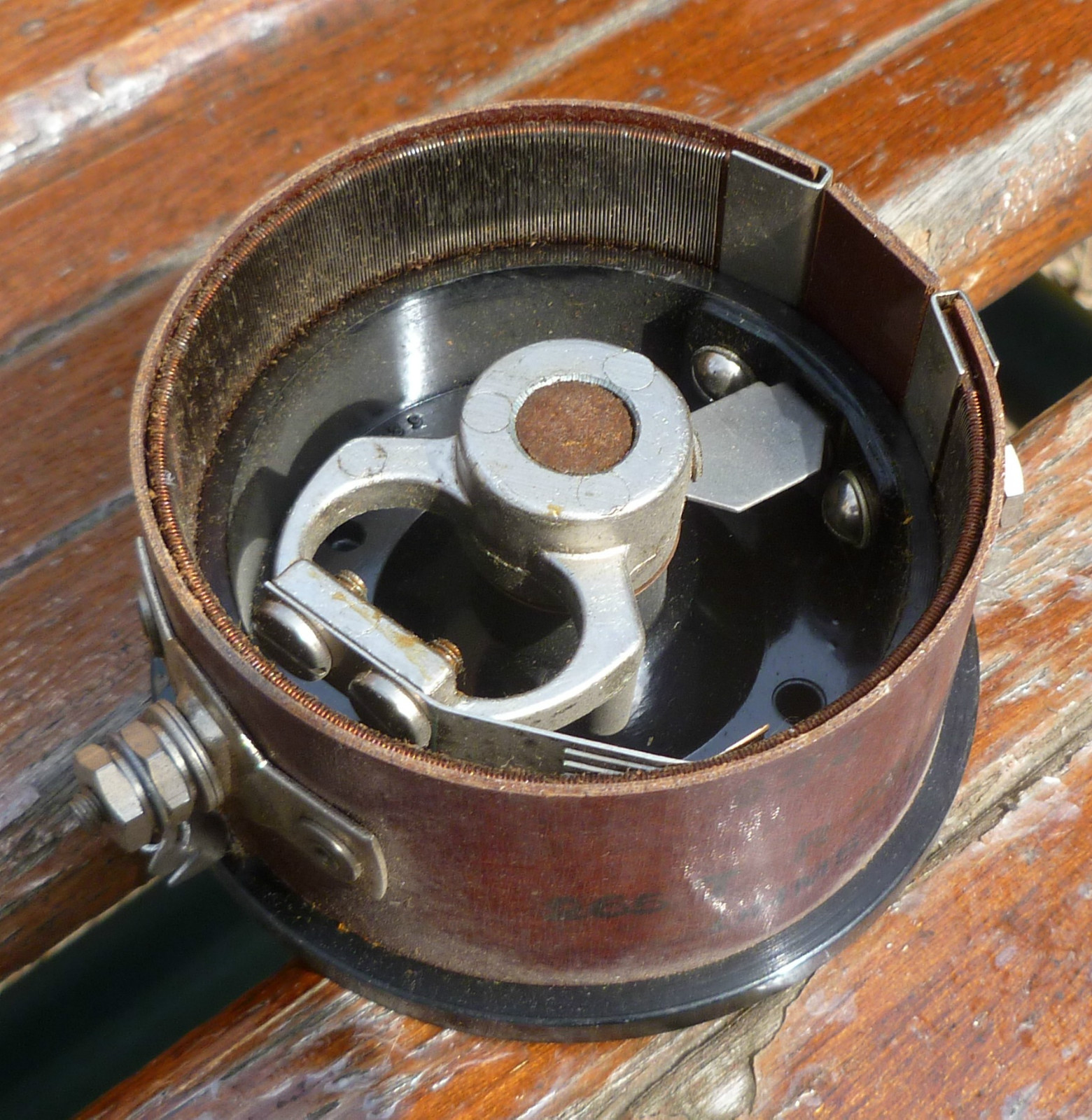

« Reply #33071 on: June 13, 2019, 07:06:20 pm »
In the meantime I suppose you could try probing with the 12AX7 out of circuit; see if the 60hz noise you're "seeing everywhere" goes away.  :-//
[EDIT]      I just tripped over this while looking for something else. [/EDIT] >:D eBay auction: #362619939251
*tinker-ily*
What is that and what is it used for?
Voltage trim adjuster for a You-Bastard!TM brand electric nipple clamp.
The following users thanked this post: Neomys Sapiens, bd139
« Reply #33072 on: June 13, 2019, 07:39:56 pm »
*tinker-ily*
It is a 1KΩ wirewound rheostat; a distant cousin to the VARIAC in this. Of course, the eBay listing tells you the basics. ;) They were commonly used for small motor speed control and and to dim lighting. And on the bench for substitution to determine  best values for a fixed resistor in a circuit.
For those interested, I just posted a full teardown of this beauty in its own thread on the TE Forum.    PM me if you're interested in giving ugly sister a home; of course my TEA brethren will get first crack and a great deal.  >:D
