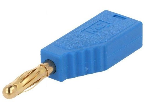

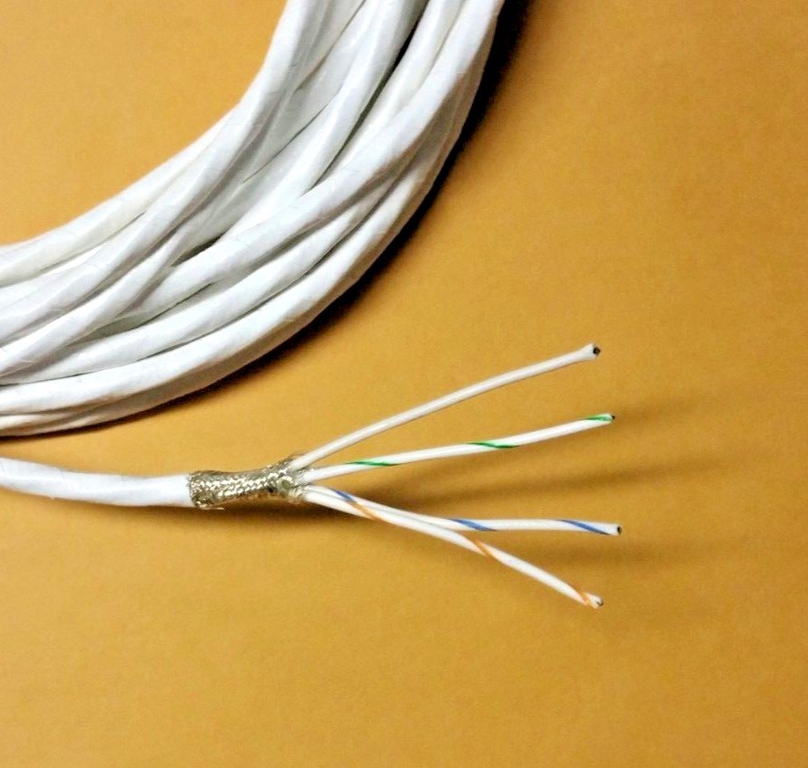

I have another question for the TEA hivemind.
I want to buy/build a shielded low-ish Thermal EMF cable with banana jacks at each end. Nothing to volt-nuttery, but something better than a couple multimeter leads.
I have seen Pomona make individual low EMF leads, but nothing as a single shielded cable (that I can see).
Anyone got any suggestions?
For the cable, I would go after something like this:
https://www.ebay.com/itm/273799295024
For the Banana plugs I would take these:
MC (MultiContact) Stäubli 4mm banana plugs
Example:
https://www.ebay.com/itm/202689458387
the hollow version of them:
https://au.rs-online.com/web/p/banana-plugs-connectors/0531453/
