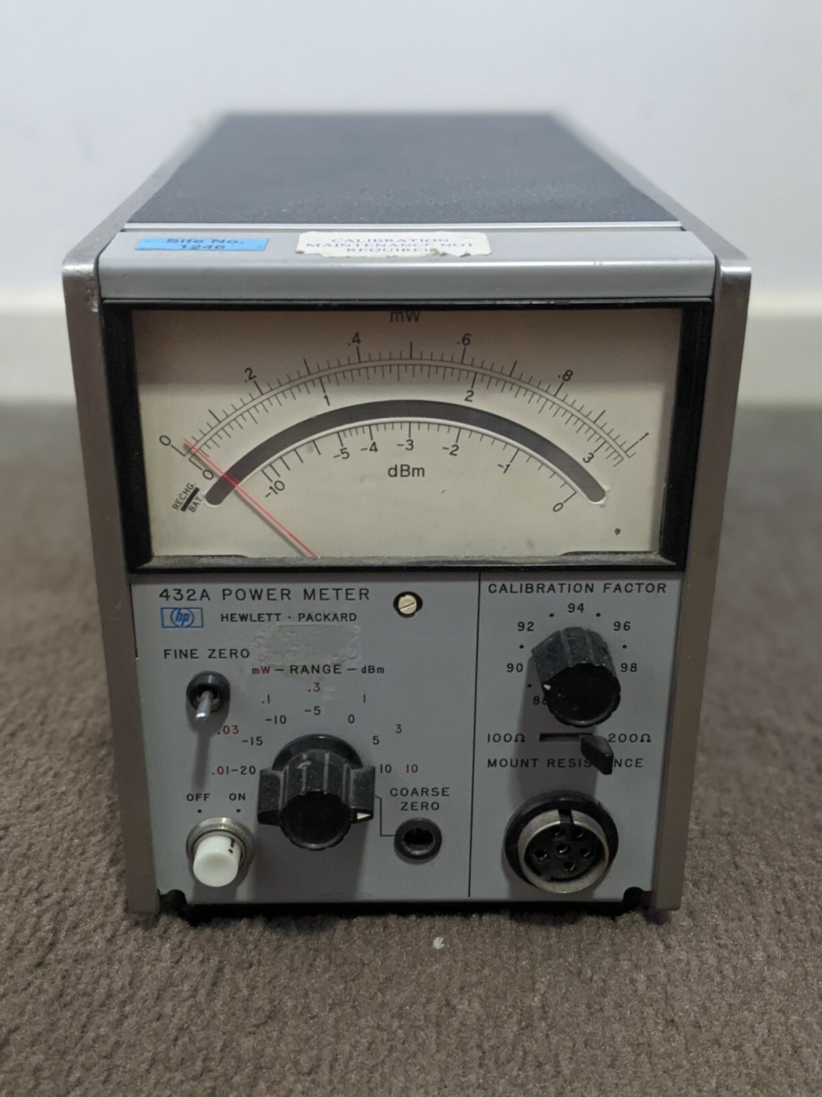

Anyone need bits for one and or want to do battle with the seller to ship it its a cheap parts donor maybe eBay auction: #184975440512 Hp 432A Analog Power Meter
I've got one, which of course was cheap, as it lacked cable and mount. I've been meaning to play with thermistors and try to build a mount. Not that I think I'll get even close to the original in performance, but studying the circuit makes it look possible to at least make it an experiment.
Does anyone have a source for the connector? The newer ones look like a Kleintuchel, but this is somewhere between that and Großtuchel.
