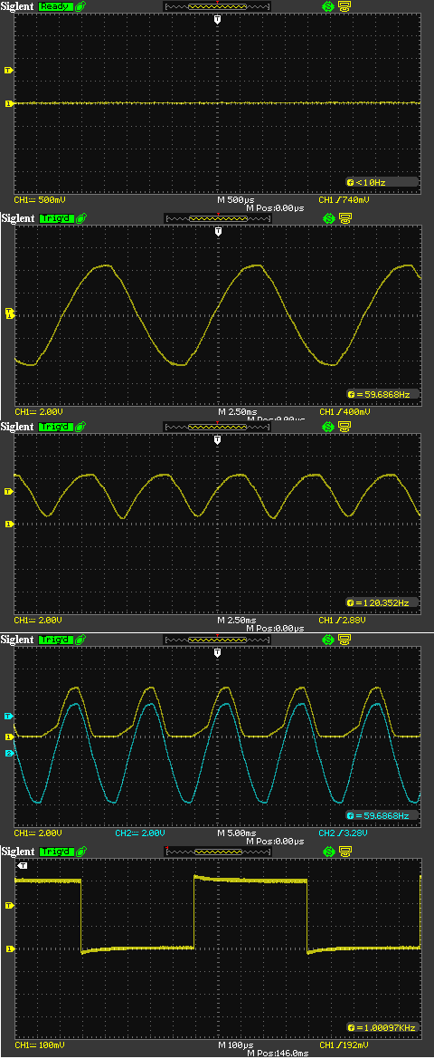

It came in!  Was not expecting it so soon, Amazon orders usually take a while. I've had some take 2 months.
Just messing around with it using a wall adapter and bridge rectifier. I have lot of reading up to do so I can learn more advanced features like recording a time sequence of data such as a capacitor discharging over a period of time.  That's possible to do right?  Like I can tell it to record for nn time and it will capture data?   Do like the screenshot feature too:
